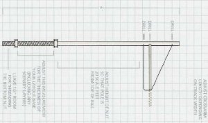

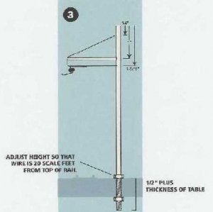

Val aka spitfire and I put this how to together a long while ago.
It was posted in Vals Urbanscene web site.
I see the great new Parkdale web site Val has now, and I thought I should post this where it is easier to find.
Thanks to Val for putting this together with me. :thumb:

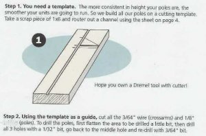

These poles I use for the track side run , the Town/ City need to be spanned,
and that is a lot easier to put together.
For now here is our tuturial.

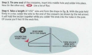

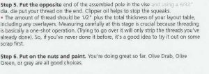

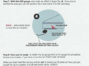

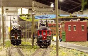

If you have any intrest in Traction, you now have a means of building poles.
The last picture shows the poles on a operating L/O
the Traction in Action.
THE END :D

Thanks Chris and Val for a very well put together "how to" I grew up with trams and trolley buses and always thought it would be neat to model a tram diorama and this article on pole making would be a big help.
Hi David.
That`s the reason I keep away from foam. We tried it on the Traction in Action and found too many problems for all the poles we needed.
If it was a small overhead line going to be built I would try putting a washer ( is that Canadian?) under the nut to spread the pressure when you tighten up the pole. But you may have problems drilling through the foam re heat from the drill.
I had to drill through cieling tile to the ply on my last L/O.
I now put the plywood base where ever the poles are going in, then build the scenery around it.
