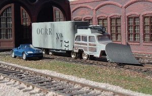

You mean HO isn't the only scale out there? ;) :thumb: Welcome to The Gauge :wave: N is a good scale, having modeled in it in the past. I am getting ready to put together a coffee table loop for fun later this summer. Other than that, they make great fodder for HOn30 equipment. :D :p
One thing though...no train sets, No Train Sets, NO TRAIN SETS...just not a good place to start.

The biggest asset is the the wife's approval, that goes a long way toward enjoying the hobby. Too many members of the club I'm in live by the "Forgiveness is easier to get than permission" philosophy. My beloved trusts I'll never spend a dime she doesn't know about and I'll never breach that trust. My Galloping Goose model that I built onto the mechanism of an older (late 70s) Atlas GP30 cost me $9 on eBay and runs like a fine watch. As an N scale loco it was one of the finest made at the time, right up there with Con-Cor's PA units. Keep your eyes on the "Buy, sell or trade" forum. :thumb:
