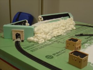

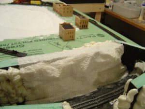

:wave:In expanding my layout i decided to try the expanding foam in a can. I think this may work for small hills and mountains. Seem a little expensive to do a large area with. What do you think?

Looks good. Dave Frary did an article in MR a while back (mid 1990s??) about doing scenery with the white styrofoam ("beadboard") and expanding foam. Seems very effective, and possibly cheaper than layers of extruded (pink or blue) foam.
Isee you have covered the foam with (plaster soaked?) paper towel. Have you tried carving and/or painting the foam directly?

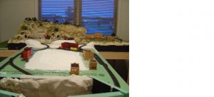

This is one corner with most all the scenery having a "Great Stuff" base...
