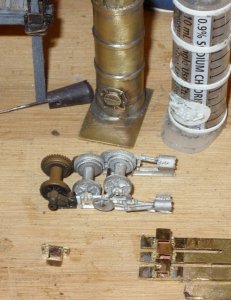

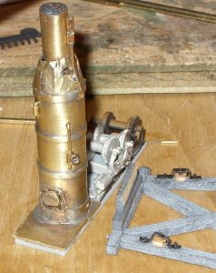

I am seeing pictures of a syringe for normal saline being turned in to a rather nice looking boiler. Are those the pics that you thought might be lost???
Zealot does a pretty good job of hosting pictures. To me the easiest to use.
Peace, DrTom:wave:
boiler
this boiler is starting to shape up nicely

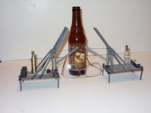

I have been patching up a three drum winch for S-P #1, and have started to work on the leg pockets for #2.

progress on unit #2
I got the stake pockets on Unit #@2, so with that done, I'll be ready to erect the head frame soon, just need to add NBW castings to the tie down pulleys on the headframe before glueing it up.

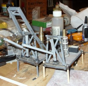

Thanks Tom. Getting those brass post pockets drilled for the tension rods, filed to final shape. chemically blackened, alinged to the needed position on the frame, tacked on with acc so the tension rod holes can get drilled in the right places, and then getting the horse shoe curve bent in the tension rods bent, and getting them chemically blackened, and installed, so tach corner assembly can cet flooded with ACC, is the most tedious part of this while project so far, so it is very good to have that done on unit # 2. The rest of the work needeed to catch up will be easy and fun compared to all of that.
All of that was needed though, as the pockets neened to be brass for strenth. but a brass wood joint is going to be problematic, but with the tension rods running through holes in the frame that gave lots of tiny placrs for the acc to creep into and bond the rods to the frame, which hopefully will support the pockets and keep the thing togrther.
I Just got issue # 44 of Timbertimes and there is an article on a scratchbuilt HO Surry-Parker single drum unit . That modeler had used styrene to make the pocketsm and did not model the tension rods, and there was one pocket visibly broken in the photo, so doing it the hard way is definately worth a try.

I'm getting unit #2 much closer to Unit #1's level of completion.

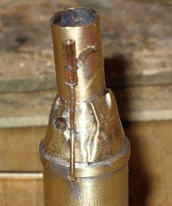

I notice the cone to the smokestack on one of your donkeys is a bit roughed up, was that intentional (as though it's been dragged under too many low hanging branches, lol) or would you like something better?
I'd suggest going to the hardware store and looking for brass or nylon barb fittings, the kind you put rubber hose over. They have a profile like this:
and come in various sizes, and you could cut one off and make a lil better cone. :thumb:
That is certainly the case. I'm working with parts at hand here, and was experimenting with scratch building techniques, with brass. This boiler is a conditional sucess, in that it looks a lot better than no boiler, and was made 100% out of stock on hand, without carefull study. Had I not been working quick and dirty, which is very helpfull when one is trying to get finished with something, rather than aiming at perfection, that is never ready for the layout; I'd have cut shapes in notecard, untill it fit perfectly, and then transfered the shape to the brass sheet. That portion of the boiler will be almost invisible under the roof of the finished Surry Parker loader. The syringe boiler may turn out to be the better unit. I'm sure Dr Tom will not complain , whichever boiler ends up on whichever Surry-Parker ends up in his posession, as Tom is my inspiration for working quick and dirty, cause Tom gets it done! and the RR that gets built looks better than the one that doesn't because youre trying to get x or y just right.

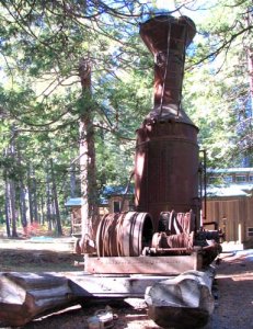

Yep, those old steam donkey's could get pretty beat up.
Here is a picture of one that is pretty "wore out."

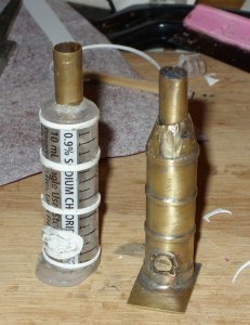

I noticed that the original was from some sort of "Sodium Chloride" medical container? What did you use?
I frequently use medical cast-offs to make things myself, being in the field and having access.
according to the label that boiler began life as a single use 10 ml syringe of normal saline. the smoke stack is a piece of brass tubing, which was held with a pair of mini vise grips, and heated cherry red with a mini blow torch, and then melted into the business end of the syringe tube, which was shortened, by cutting off the bottom of the boiler to get it close to the right height
Other than the shape, the material is not ideal, as most glues don't want anything to do with it.
