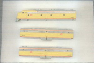

I was able to prime some of my work train this afternoon,Now I've got to do the finish color's,or I might clean up the rails and send the E8 and B-units on down the line.
