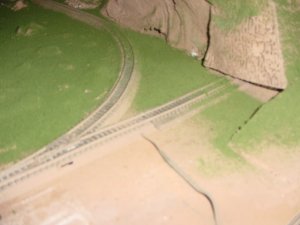

I am not trying to start an argument, just sharing my thoughts. I am a novice modeler and started with a ez track then made a transition to flex track. I ran into the same problem as C T. The bump looked bad and one car the 40 footer would come uncoupled. I fixed the problem by sanding it down then using solider to even it out much like a dentist using filler to fix a chipped tooth. I have no problem now at top speeds. I added small amounts of lead weight to the cars and it runs great and I have a cheap starter set. Here is the best pic I could take right now.

No arguement from this section of the bleachers. I'm a novice myself. I just related my own experience. I figure that if I had kept fooling with it long enough, I could have gotten it to work. I just don't figure that it is worth all the extra work and grief to do so. The damage to locos and cars ended up being much more than the couple of dollars more to get all the same code track.
