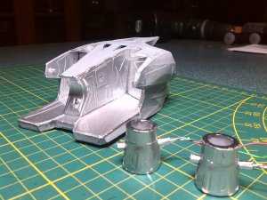

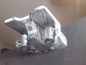

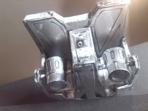

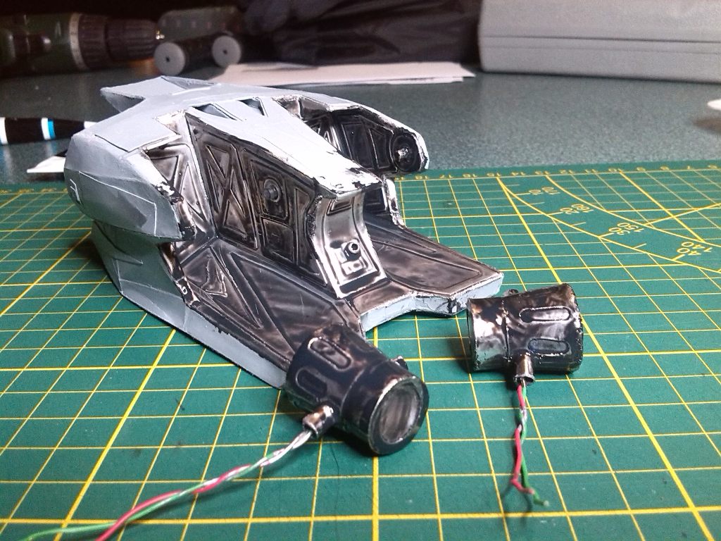

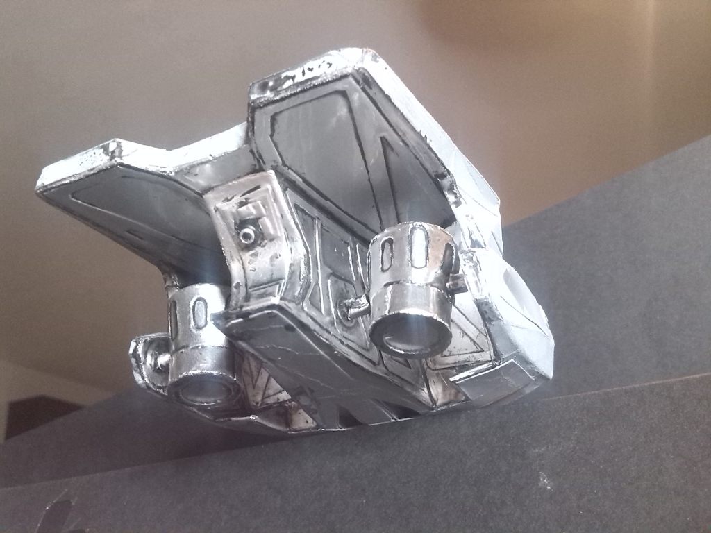

As received from the paint job...........

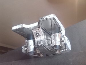

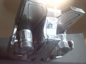

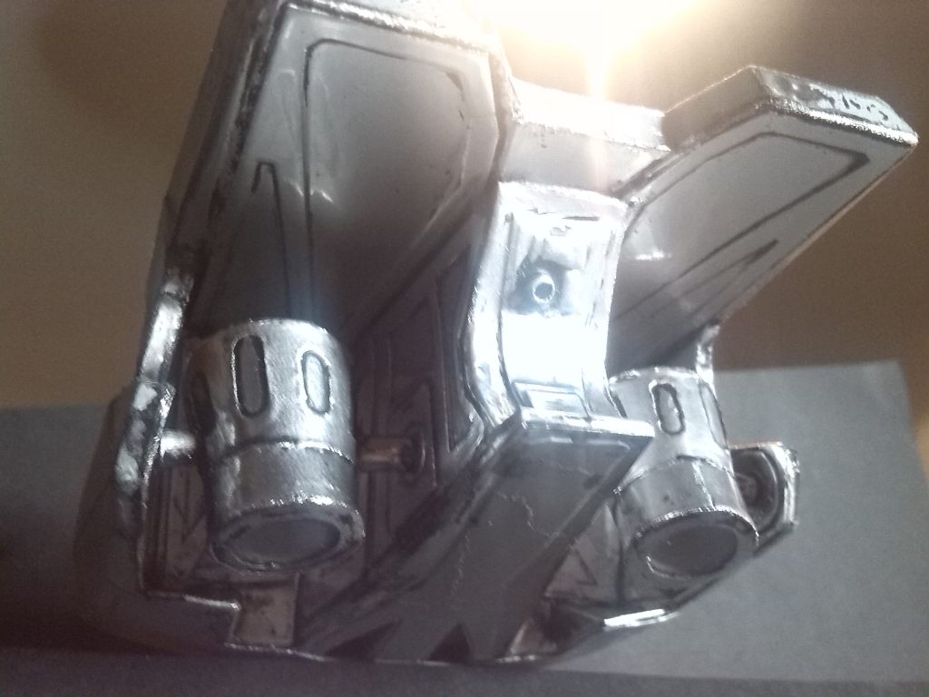

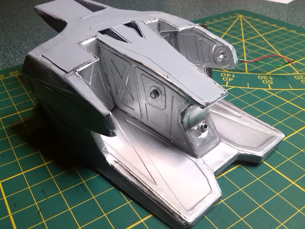

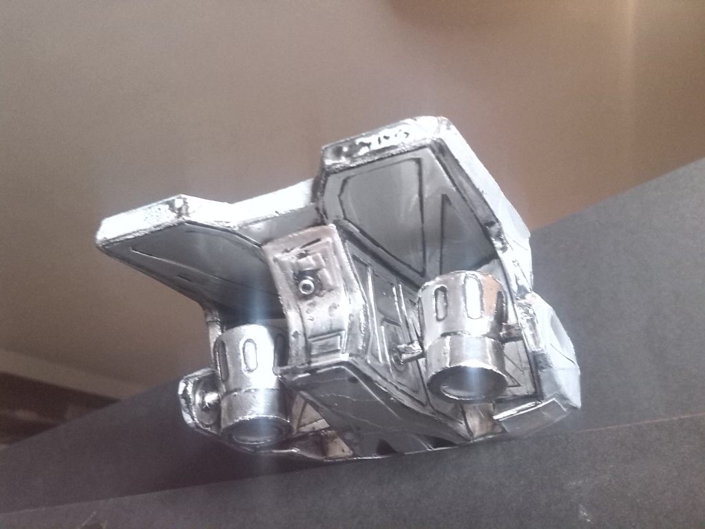

How I proceeded to mess it all up ........!!! (The same procedure with the dark wash, that was done to the engines ......)

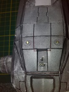

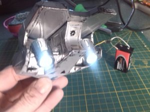

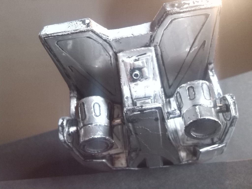

And, after lots of work with damp ear-buds and pieces of old T-shirt, this is how the front now looks .......
I still have to refine a few things, but the spotlights and recesses in the nose, are chromed and ready to go .... :D

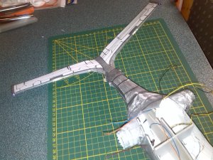

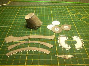

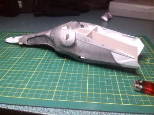

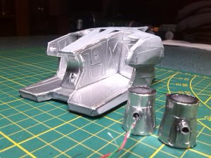

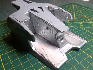

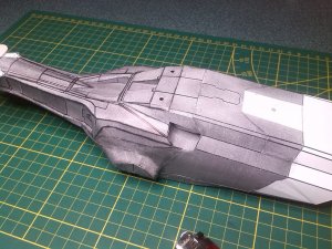

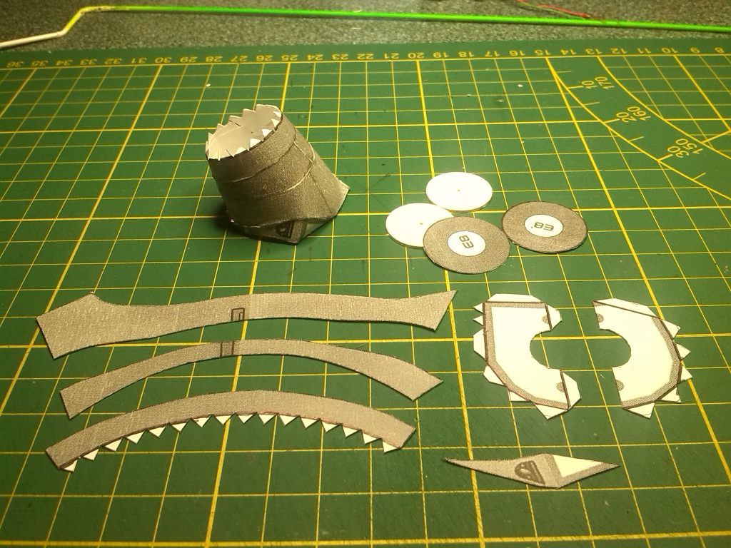

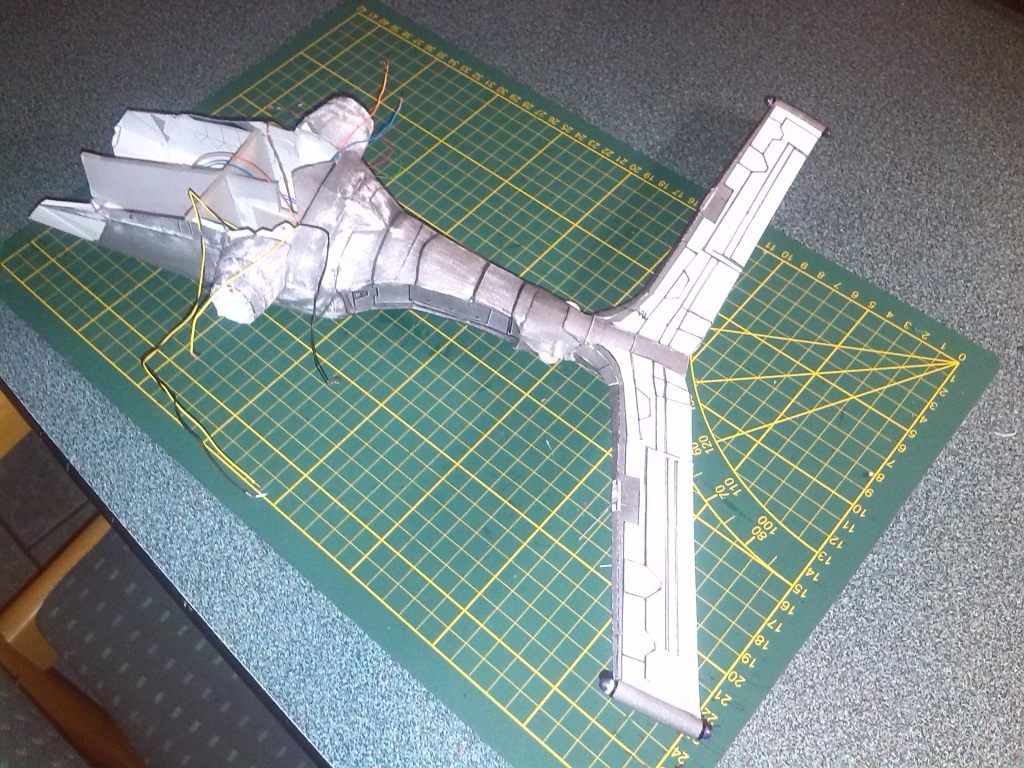

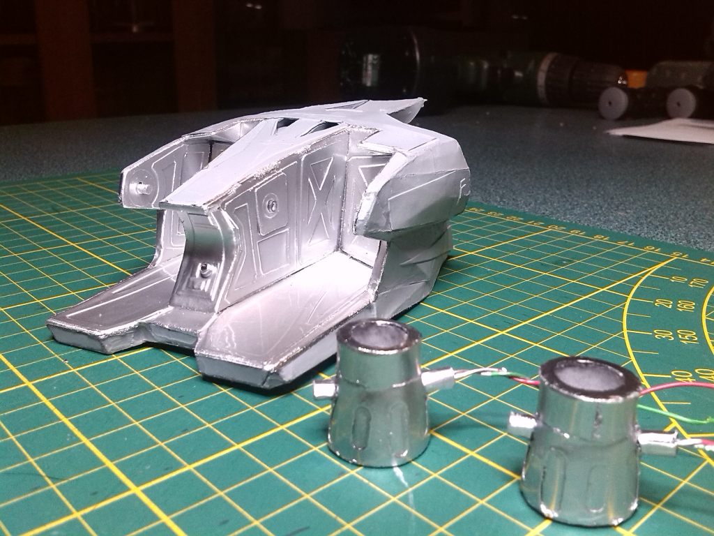

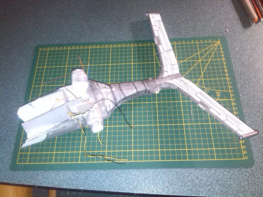

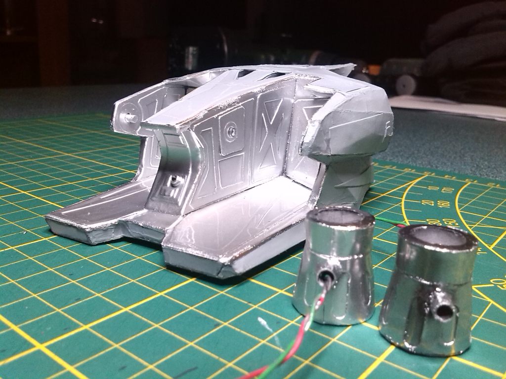

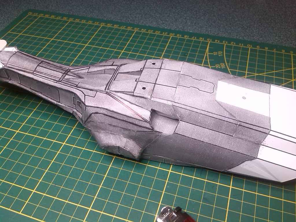

Body Building ......!

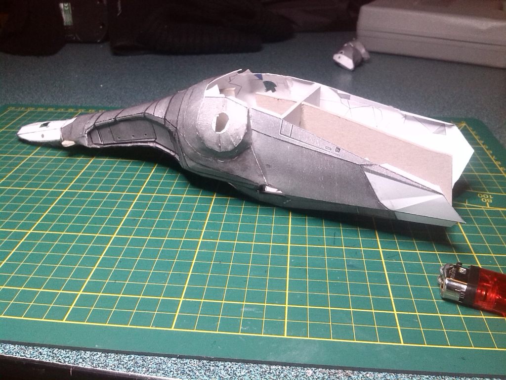

Progressiveness of the fuselage...... Again, nothing special, just edge-gluing, back-tabbing, etc ......
The white sections on the front, denote where the completed nose assembly will be glued.

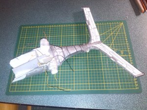

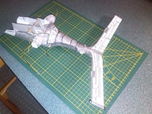

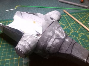

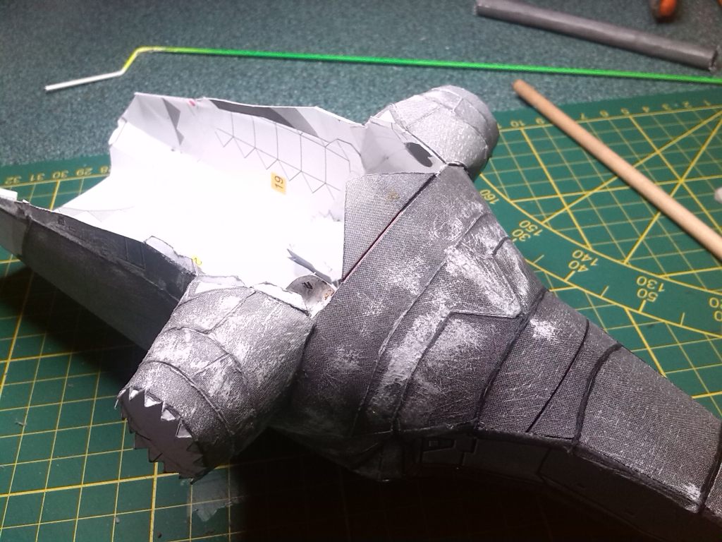

Next, the engine/fuselage "shoulders" were made up and attached...
And I started rough-sanding some surfaces in preparation....

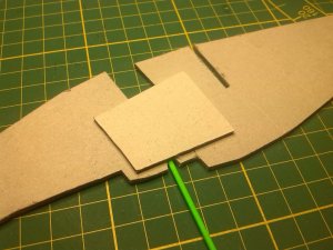

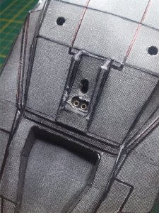

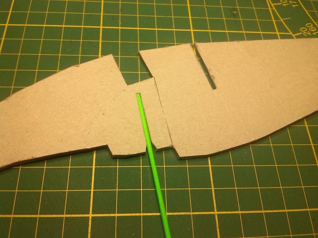

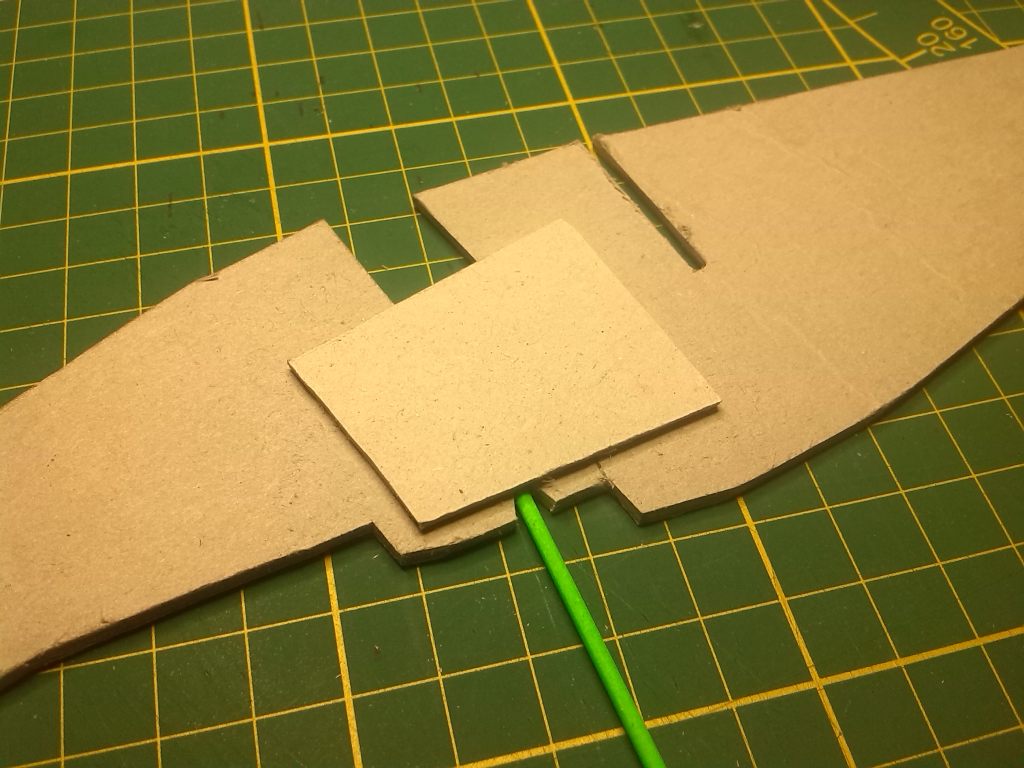

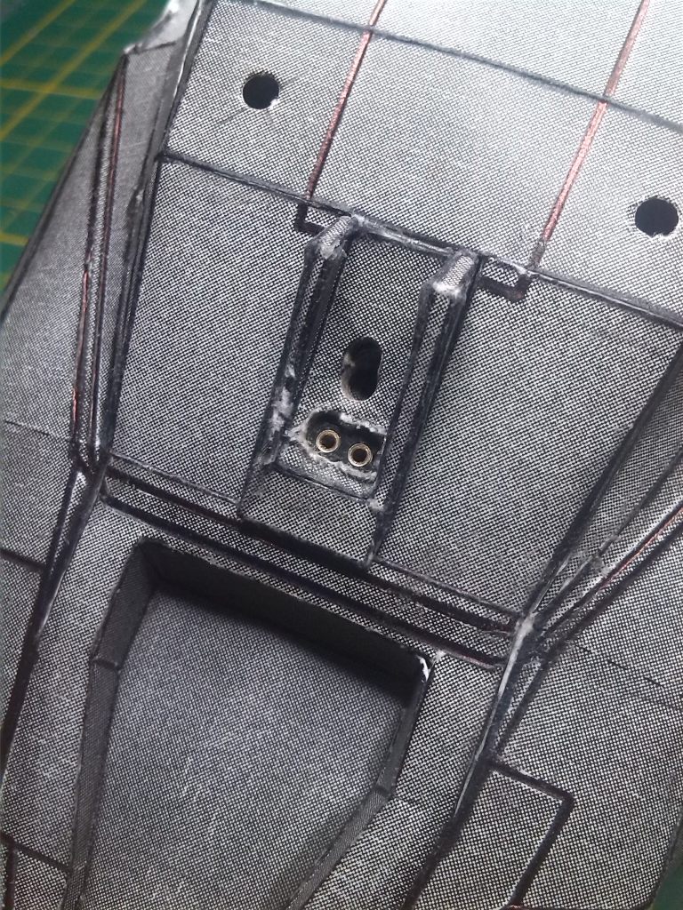

Now that the main structure of the fuselage is mostly complete, I wanted to finalize how the model will be suspended when in the flight-mode diorama. I am going to use a metal rod to support the model in the air.
I am not going to go into too much detail on the support system at this stage, as it will spoil the suprise!! ;) But, I will say that the metal rod will not be visible in the end ........ :wink:

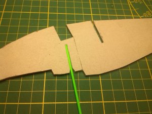

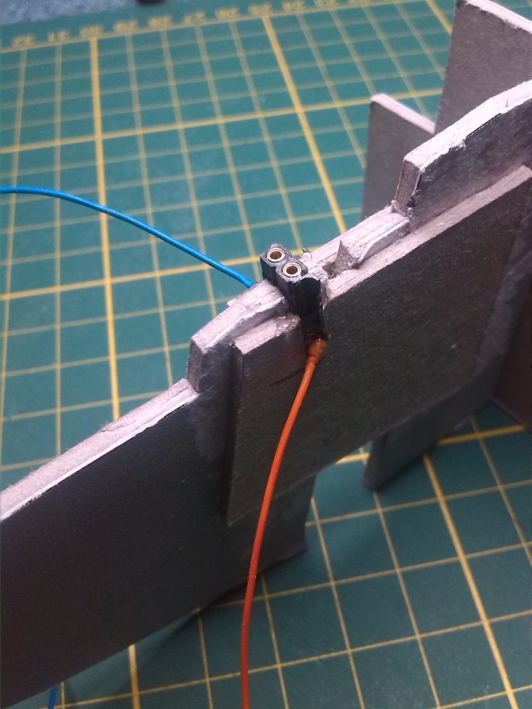

I cut a slit in the internal former that allows the metal rod to be pushed in with a nice snug fit. I glued extra thick cardboard plates to either side of the former to close up the slit and strengthen the area a bit more.

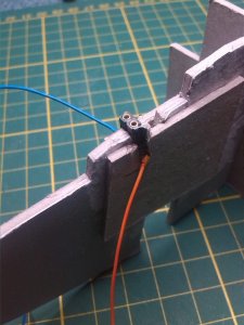

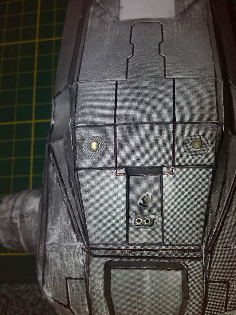

As I need to get power for the internal lighting of the model when it is up in the air, I decided to use a female pin-header as a connector. I cut a small slit in the bottom of the former and used gel ca glue to attach it to the former after soldering the wires on. Once the former is in place in the fuselage, the connector shows through, close to the hole for the metal rod.

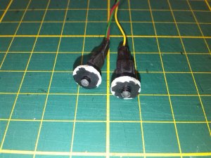

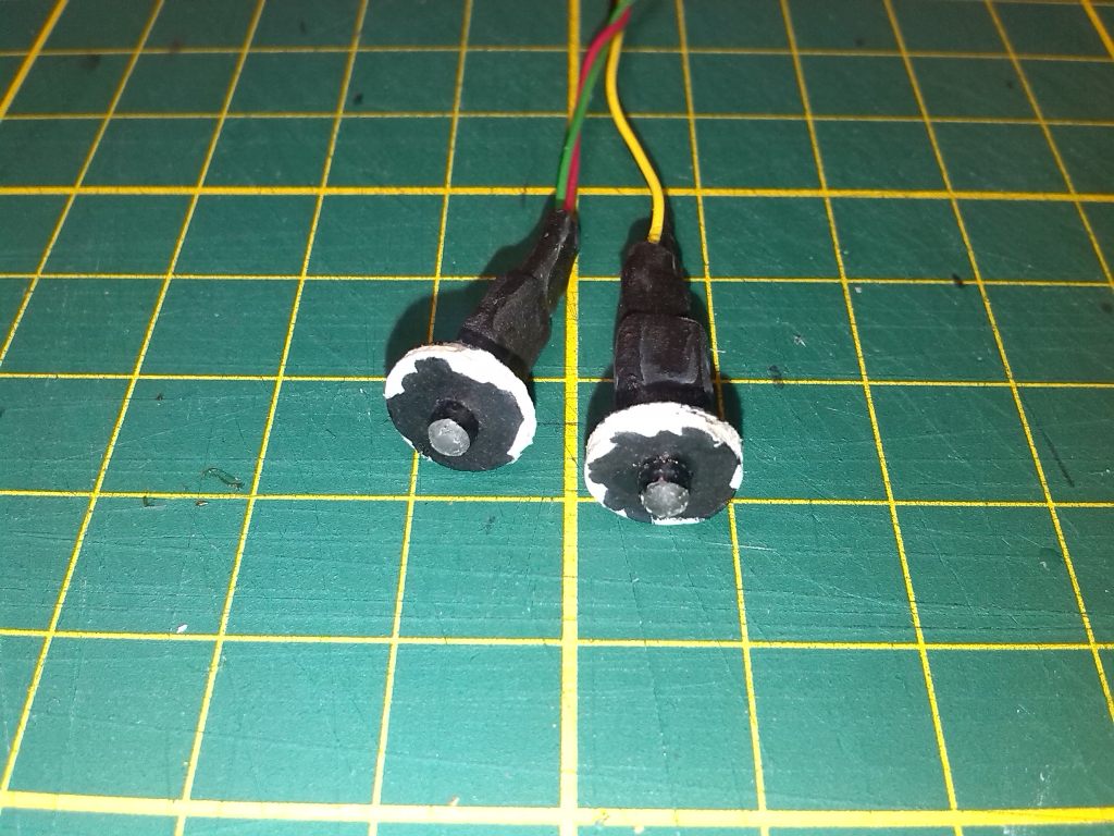

I am using 3mm white LED's for the landing lights in the fuselage. I made a ring from thick card and glued the LED into this. This ring is of the correct thickness, that when glued into the fuselage, only the tips of the LED's stick through. The LED's were wired up and then glued into the fuselage.... I also added some greebling to the fuselage surface around the LED's.

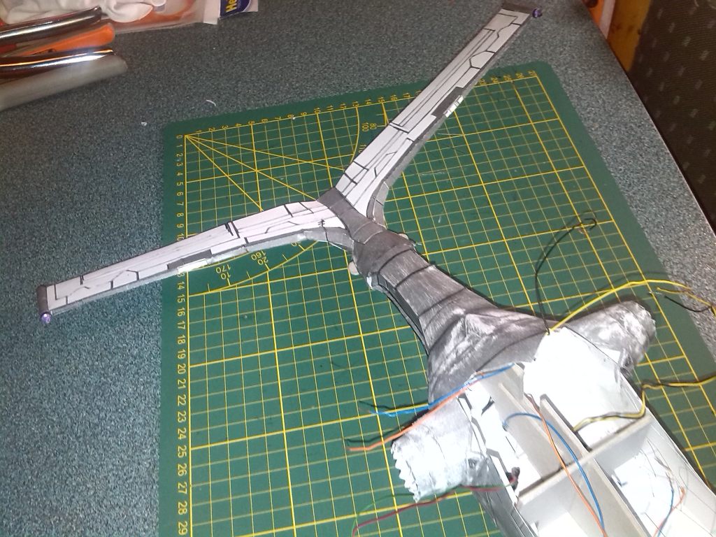

Before I close up the fuselage for good, I need to get the wiring and circuits worked out and installed.

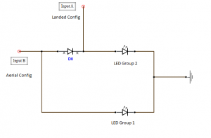

Each configuration has a different input point for power though. In the flying configuration, the power enters the bottom of the fuselage, and when landed, the power input is on the port engine.
I am no electronics expert, but I designed a simple circuit to accomodate the above setups....
In the schematic above, LED Group 2, contains all the LED's which are ALWAYS on, in both configurations.
LED Group 1, contains the LED's that will be OFF in the landed configuration.
I inserted a diode (D0) between the 2 power inputs, (Input A and Input B.)
This diode acts as a 'gate', to control the direction of the power flow in the circuit. (The 'arrow' of the symbol for the diode shows the (only) direction that power can flow through it.)
So, if the power is coming from Input B, the power runs directly through LED Group 1, and also through LED Group2, via the diode, to the negative side of the circuit.
However, if power is applied to Input A, the power will run through LED Group 2 to the negative side, but NOT through LED Group 1, as the power cannot pass through the diode to light LED Group 1.
In the schematic above, for clarity, I have ommited the required resistors for each LED set.
LED Group 1, contains a total of 3 seperate LED's (plus resistors) and LED Group 2 contains 10 seperate LED/resistor sets.
I am hoping to finalize the wiring tonight and get it all installed. I've really gotta be clear-headed for this task, as I really do not want to blow any LEDs at this stage.........:sadno:
I will let you know of the outcome ....... :nailbiting::nailbiting:
