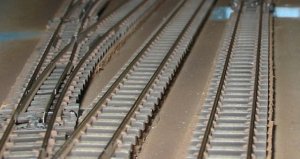

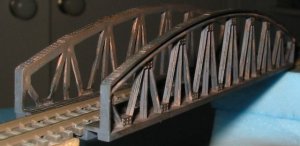

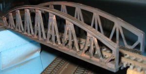

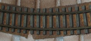

Wondering what peoples opinions are on my first attempt at weathering my track and a bridge...
To weather the track, I airbrushed the whole thing with Polly Scale Roof Brown, then I drybrushed the tops of the ties with 1:1 Polly Scale Reefer White and Earth. After that was done I handbrushed the sides of the rails with 1:1 Polly Scale Roof Brown and Rust.
The bridge was airbrushed Polly Scale Grimey Black then hit with an Ink wash then hit with Burnt Sienna Pastels then Testors Dullcote, and finally and bit of drybrushing with Oily Black.
I also lightly brushed the walkways with Oily Black.
Im not sure if Ive overdone the bridge or not? Im quite pleased with the track...
Any suggestions for making my bridge look better? Or should I leave it as is?

Looking good Troy and will be interested in seeing it when you have ballasted the track. I must admit I like my track to be somewhat darker and paint the sides of the rail with burnt umber. That may be because the actual CN tracks that go through town here look that way. I can imagine track could look the way you have done it where you live.
