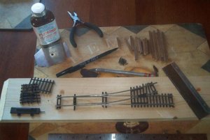

As requested, here is a step-by-step pictorial of how I convert Atlas HO code 83 turnouts to On30.
I went this route for two reasons.
One - The Peco On30 track is lovely, but I wanted code 83 rail, not code 100.
Two - I had loads of code 83 track and turnouts, and being a cheap fella, wanted to use that up. :p

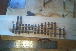

So, off we go. Here are what I started with; rather than laboriously identify each item, I'll just include what I used in the picture.

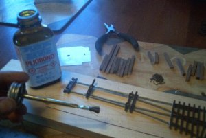

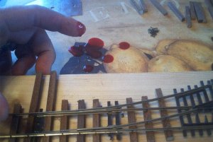

I flipped the turnout upside-down, and applied "Pliobond" glue to the bottom of the rails, being very careful not to glue the moving rails. (Points? Slidey-things??):confused:

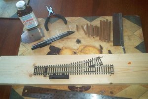

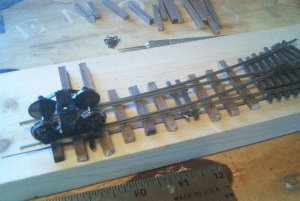

Now it's time to start spiking. I use a small pair of pliers, although I've heard of spiking tools. (?) While spiking, it's important to keep the rails in gauge. I use the NMRA standards gauge, and for funsies, run a wheelset along the rail.

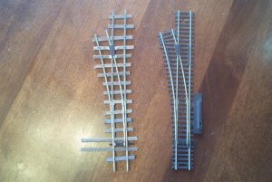

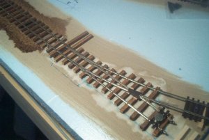

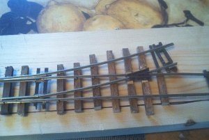

Sorry 'bout that. :D Now, the frog has been trimmed, and I do not try to file the bottom of the frog down to the level of the rail; rather, I notch the ties under it. Here they are, all fitted in, ready for spiking.

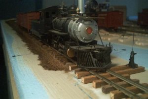

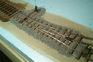

I have put down some ballast, and here is the result. Next is to scenic around the turnout, paint the rail, and touch up with a little stain here and there.
