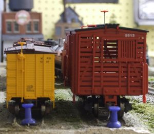

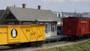

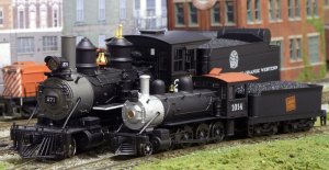

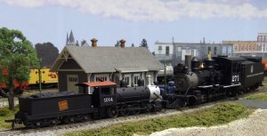

at the local train shop, i put a spectrum on30 boxcar next to a HO 40 ft reefer and they were almost the same size. i put the spectrum on30 shay next to several HO steamers and they were almost the same size. same thing with the spectrum on30 climax. i was going to do On30, but after i saw them in person, i was disappointed in the small size for "O". they look way too small next to O scale buildings IMO. so i'm sticking with HO since it's cheaper and there's more stuff available.
Well duh... they're narrow gauge. :p ;)
They're small. They're supposed to be.
It's so you can model 1:48 scale in a smaller space.
I can see where you are coming from but the On30 equipment is small. A bachmann 2 cylinder shay was small. I believe it was modeled after a 12 or 14 ton loco. If you compare it to a small O scale, standard gauge loco you would get a better comparison. Also, if you can find any HOn3 equipment, compare them to standard gauge HO equipment and you will find the HOn3 is smaller. I have both On30 and Standard gauge HO and its like trying to compare apples and oranges. Two different creatures. Remember, those Bachmann freight cars are a scale 25 feet long and you were comparing them to a probable 40 foot HO car.
i know what you are both saying. i was responding to the OP. i'm not a "rivet counter" though, so looks are more important that prototypical scale to me. if it doesn't look right, i don't care if it is to scale, i don't want it. now i haven't compared the engine the OP is specifically talking about, but the On30 stuff i've seen would look just fine on an HO layout.

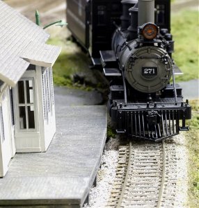

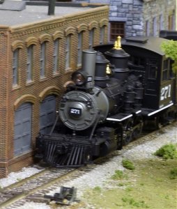

My personal opinion (for what thats worth). No, the Shay doesn't look right next to HO buildings. It didn't look right when I ran it on our HO scale layout. It doesn't look right when parked next to my HO scale engine house and it definitely doesn't look right when parked next to a Bachmann HO scale three truck Shay. The Bachmann 2-8-0 that was the original subject of the post is much larger and would look even more out of proportion. And then there is the HO scale people situation.
If you are going to run On30 on an existing layout, you've got to watch for clearance, since they are much wider:
