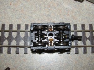

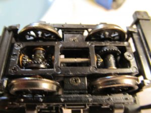

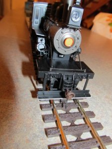

the underside of a Bachman On30 Climax truck. the truck is properly scaled. Fun fact, when Climax filled an order of a 30 inch gauge locomotive, they didn't build a special truck; instead they took a 3 foot gauge truck, and pushed the wheels in farther on the axle.

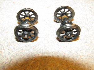

the stick wheel is shown to the left. push the wheel outward till the center hub is flush with the end of the axle, and miraculously. the wheel is properly gauged for On3.
some adjustment of the electrical pick ups are needed.
The climax ix now an On3 model I always loved the brass Flying Zoo Brass climaxes, that are very similar, but they run close to $1,200.00 I couldn't resist the Bachman unit, that I picked up on sale for $250.00. It still has the silly HO coupler, mounted at HO coupler height. I had hoped that the link and pin pin was an extension of the coupler screw, but no such luck. the pin is press fit, and can be pulled out with a pair of pliers. the top two link and pin pockets are not deep enough to be useful, and A KD On3 coupler shank is a tad to tall to fit, so I sanded two KD On3 couplers shanks down till the would fit, and cut the draft gear spring slot off. The pocket's two top slots are not deep enough, so I'll have to mill out the pocket to make it deeper.

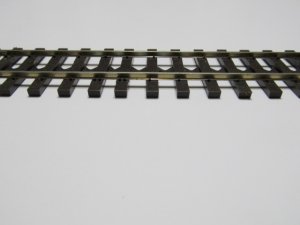

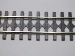

a word about the track, San Juan Car Co's On3 flex track, the pretties flex I have ever seen . the triangular connections are the only connections between the ties, so the ties stay nicely distributed no mater which direction the track is flexed. or how tightly
seen from the side, there is nothing under the rail anywhere, so iff you go for the new track on the ground look, it will look right.

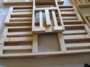

Have the frames for six ore cars mostly done. they just need some cut out and chisel work doine for the KD draft gear boxes. since this is all scratchbuilt, without a plan, I'm going to hac=ve to set up one frame with trouks and coulers to be sure everything is tight before proceeding with the other cars.

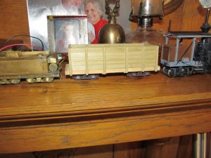

The first if the ore cars is shaping up
from the underside, still need to build the sloped inside floor, and figure out how I'm going to mess up the truss rods. scratch building without plans is an adventure I'm doubting I'll finish all six right away, the unfinished cars will likely go into a box, along with lumber, to be completed later . dont need six On3 ore cars right now, or even one or two.
Everything above the frame was built last night or tonight, as I just cut the Yellow poplar wood on my table saw last evening. sure do love the yellow poplar wood. part of me wishes I'd have cut all the lumber for these cars out of yellow poplar, like the Tweetsee hopper I gave to DR. Tom, but then again once it is painted, the inferior wood will disappear, just like the beautiful poplar.

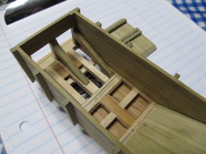

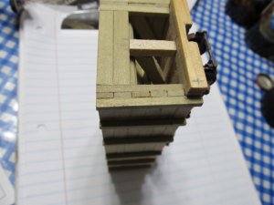

fitting the supports for the sloped inside surfaces. this has been the trickiest part of building these cars with out any blueprints.
just a tad bit more work, and this first car will be ready for some gray paint for the beginning of the paint.

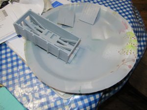

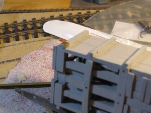

shot it with some gray primer , will need to dust the bottom with gray after this dries, cause I missed a couple spots on the under frame..

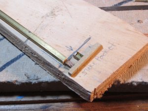

a jig for cutting brass C channel to size for making the stake pockets for the ore car

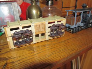

The first one is test fitted, and looks about right

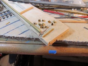

Cut a bunch of these with a heavy duty grinding wheel on the dremil. these are tougher than the cut off wheels, and don't explode if you look at them hard like the thinner cut off disks do.
next I have to find fine fine brass wire and find a way to reliably bend it into C channels, and solder them to the pockets.

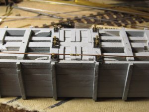

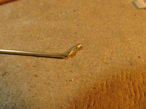

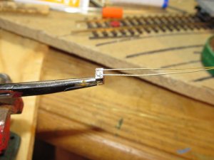

some progress on the first ore car. was held up because of no turnbuckles. went to hobby lobby and got some small brass tubing to make turnbuckles out of . sadly they did not have brass rod properly sized for my truss rods.

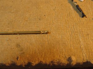

I file through the brass tubing to make an opening, and then I cut the tubing off with a grinding wheel on the dremil.
I used this method to make turnbuckles for my surry parker log loaders ( logging and industrial RR section, Show us your unique logging equipment thread). these are conning out faster and nicer.

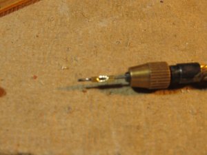

after cutting it off, I ream out the inside with a drill bit to clear out any rough edges.
testing the turnbuckle on some .032 phosphor bronze rod, which is just right. sadly this is all I have on hand, so I need to get more.

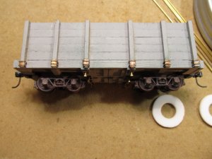

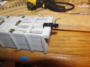

Unable to proceed with the truss rods, I mounted the couplers. I cut the coupler mounting notch a tad to long, so I'll try to refine that on the other six cars.

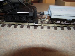

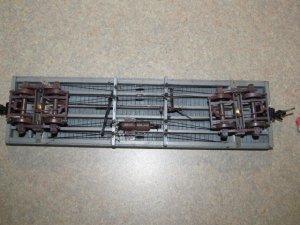

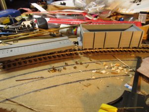

the coupler height looks about right compared to this f
Foothill Models Westside Lumber Company equipment flat, one of my very few almost complete O freight cars

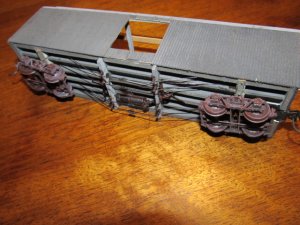

at a standstill on the truss rods till I get some appropriately sized rods. will work on stake pockets, and then might have to start putting a body on one of the 5 remaining frames.
Just this week it has cooled off enough so I can go into the attic RR room without turning on the AC, so it is possible I might start working on the HO empire more
The wooden car really pulls it off when all painted up. ;)

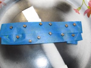

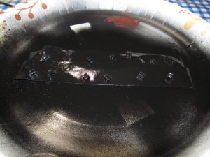

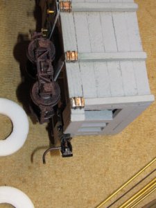

I stick small parts to masking tape on a paper plate, so I can spray paint them without blowing them off the paper plate and onto the gravel driveway

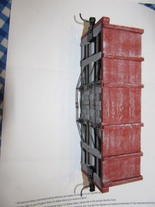

stake pockets painted black
yhe car with the beginnings of a paint job. will continue to dry brush red, and lightly sand model to expose the gray till it is where I want it to be.
That's a really good idea! :)
