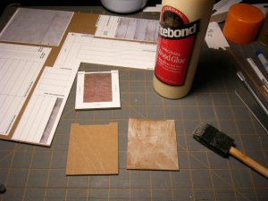

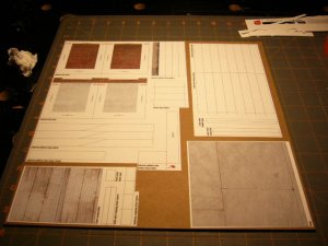

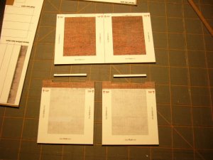

I am building the FREE download freight house from Scalescenes.com - Download and print realistic model railway buildings in HO scale, and decided to take some pictures to share my progress. I'll also be sharing any tips or techniques I learn along the way. Without further ado, let's get started!

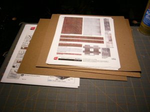

These are the materials. The printouts I made on a heavyweight paper using my HP inkjet printer. It took forever to download this from the website, but that's due to my blazing slow 26.4 dialup connection. The cardstock is from packs of scrapbooking papers my wife has purchased and I saved for that 'someday' project. Well, that day is today! (er, yesterday, actually)
Here's the spray glue I used to adhere the printouts to the appropriate thickness of cardstock. I made 'thick' stock using two sheets of .040 card, medium stock from one sheet of .040 card, and thin stock from a cereal box. (perhaps Robin is up there smiling down on this?)

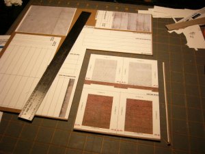

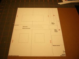

This is the sheet which has been glued to the 'medium' thickness card. The thicknesses are recommended in the instructions (9 pages and VERY thorough). I used a caliper to determine what card was what thickness. It's printed right on the sheet what size card it's to be glued to - very thoughtful.

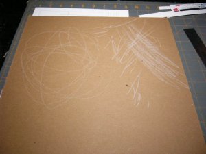

My 2 year old's contribution to daddy's project...it will be forever preserved in layers of card within this humble structure...sniff...of course, this is long before this cardstock was selected to fulfill its ultimate destiny as a structure.
And finally the sections which were attached to the 'thick' .080 card. I cut these out of their master sheets in order to minimize the waste, and since I only had one 'sheet' of .080 stock after gluing the two .040 sheets together.
The cutting begins

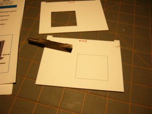

Here is the small section to be attached to the 'thin' card. The cereal box may be a bit thicker than what's called for (65lb paper)...we'll see.

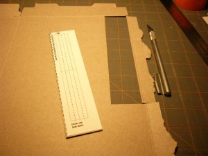

The first major section removed from the 'thick' sheet. I trimmed away the thin bit on the right first, then cut the major wall group away from the larger sheet.
The two side wall sections trimmed and separated.

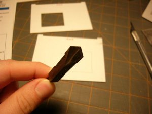

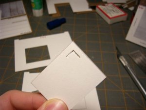

The lower sections (inner side walls) with the little fiddly bits (brit slang?) removed from the top and the two walls separated, in that order.

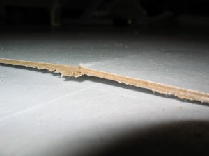

TIP#1 - When cutting the thick card sections, be sure to keep the blade perpendicular to the surface or else your cut may come out with a slight bevel. Make the first pass gently, with the tip of the blade angled in toward the scale rule slightly in order to follow the ruler and not wander down the line. BUT, then be sure and hold it straight up perpendicular to the page or else beveling will occur as it follows that angle down into the card, pass after pass. This tip comes from experience!
TIP#2 - Sanding sticks work very well to help correct the bevel and remove any fuzz you may encounter. I have two kinds - one fine and one coarse. (You may have seen one stick with each on a side...this'd probably be fine too.) I'm sure regular old sanding films and a block would work as well.
TIP#3 - You may have heard it before, but it bears repeating. Work slowly, let the blade do its job, and make multiple passes without having to bear down heavily. It took me at least 8 or 9 steady passes to get down through this card. It WILL dull the edge quickly.

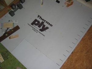

For the heavy card, I found the perfect solution in my attic. The previous owners of our house left behind 3 large (4x8 foot?) sheets of "Thermo Ply Tough Protective Sheathing, T-Ply II." I guess this stuff is inside our walls or roof somewhere, but it looks just like thick card and is exactly 2 mm thick. With the amount of this stuff I have, I won't *ever* run out of "heavy card."

This Thermo Ply sheathing sounds like a good thing...I'm going to look into it. Is the surface rough or smooth?

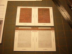

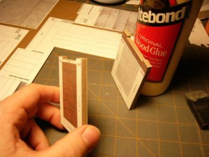

Gluing side walls
Here are two side walls, an interior and exterior, being glued together. Above them is a pair that have just been glued. I applied a few squirts of titebond wood glue and spread it evenly over the surface before aligning the halves and pressing them together. I used just enough so that it didn't squish out when I pushed them together...but the tips on the scalescenes website and instructions do include keeping a wet cloth handy to wipe excess glue from the model and your skin.

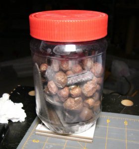

These walls are thick!
If you don't have an old peanut butter jar of copper nuggets and other assorted heavy metal weights, then find something suitable around your house to set on top of the wall panels as they dry. Honestly, I don't think they needed it since the heavy card was very true and warp-free to begin with, but I did it anyway.
HINT: The instructions mention PVA glue. THIS IS JUST WHITE GLUE. Elmers, Sobo, and many other brands I'm sure, it's all the same stuff. Carpenter's wood glue is a close cousin and should work fine.

Here are a couple of shots of the Thermo Ply sheathing I mentioned earlier.
Overhead view of a large sheet lying on the floor. In one corner you can see where I cut out some pieces to use for this project. For scale, the black lines along the edges of the sheathing are ~3 inches apart.

Here's an "on-edge" shot of the sheathing. To answer your earlier question, Galen, the sheathing is smooth on the top and bottom (those "bumps" in this shot are random bits of attic dirt). The sheathing is a little warped near the edges, but seems pretty sturdy at the sizes used for the scalescenes.com model.

I guess I'll know how well it works once the model is finished.
