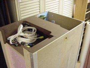

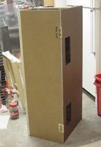

Satokuma - here is a shot of the module packed up. The module size is kind of interesting in that it fills the only space I have left in my van after the other two are packed. Packed it up tonight to move it to the clubs location where I have my other two modules stored. Have to marry it to the other two and blend the scenery. Arlaghan will take some shots when they are together.
Charlie it is a little on the hefty side, sixty two pounds, that is why I have my hand truck. Goes together real easy and I don't realy have to lift it. It can be assembled on it's end and tipped into position.

should point out that the legs can be seen in the first picture off to the left. The dowels are used to lock the module into position. They protrude up through the masonite work surface and go into the blind holes in the module itself. Don't know if that is clear enough?
