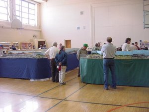

The Valley NTrak Club of Connecticut did a show today. We put together a very large 36 x 26 waterwing type layout using two "T" shaped modules. The show was a fund raiser for Crew 33 of the Boy Scouts in Shelton CT. There was a lot of diversity in each members modules, but all were built to NTrak standards so there was no problem in making the arrangement shown in the picture I took today.
