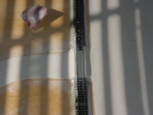

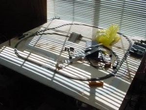

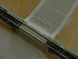

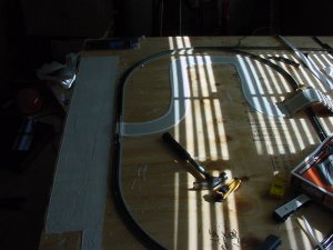

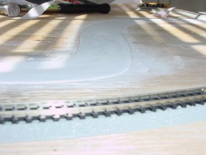

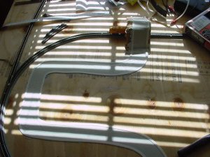

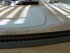

okay I am attacthing photos that are pre sanding and still need to finish track.

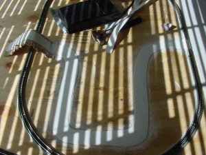

Here are the pics post sanding prp for painting.

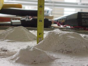

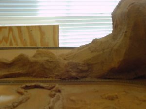

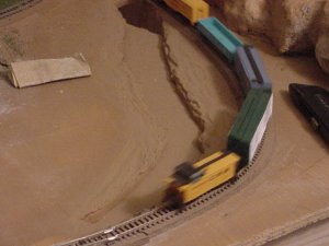

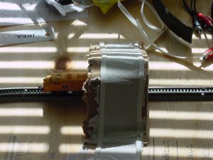

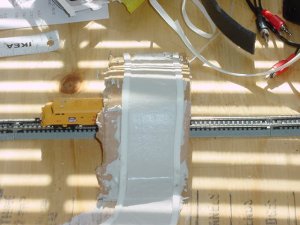

I was thinking that myself. that was an experiment. I need to get that scale ruler. Well I just measured the ground to the peak and it is a 34 foot hill. The cars will need lots of horse power and supergrip tires to make it.
When the train is under it from top of train to peak is a 10 foot gap. I think a way to fix that would be to put the tunnell ends and then over lay the road.

So what do you think of the roads, those are country roads and They are 1inch and 3/8 from end to end. That leaves room for two cars and shoulder stipes.

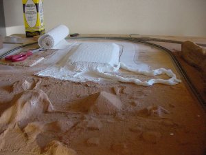

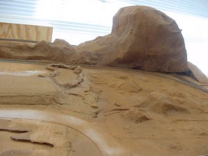

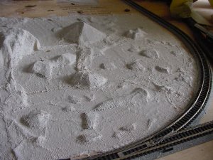

Progress report 1

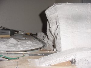

added texture to the layout using plaster cloth. This stuff is really nice to work with when it is fresh. My seecond roll was more dry than the first one and didnot spread as nicely but still worked none the less.
out the pics

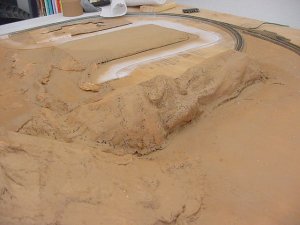

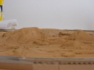

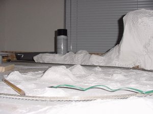

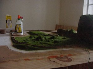

Progress report 2
next I needed to add a base coat so I chose sand stone as the color for an earthy look.
the next progress report should have some green clor mix in some where if I can find the directions. (fumbling for directions) just kidding I did not buy the scenary manual I am improvising.
Joe looking good with the terrain now.I use that plaster cloth on my layout to and i really like it.I have found after you lay a piece where you want it smooth it out with your fingers to help fill in the holes in the cloth. :thumb:

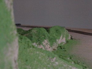

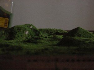

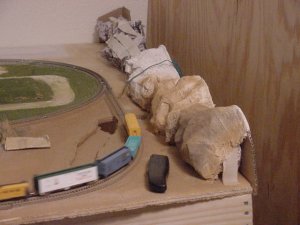

Progress report 3
Yea, that is what I do, and the first cloth worked best , the second seemed brittle and it didnot take the water verywell.
I was also thinking about your graffiti, On the net it shows the pics of the graffiti decals, at internettrains, that way your wife can get some ideas to draw upon.

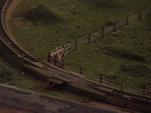

new fotos of work

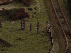

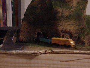

I have added the barbred wire fence for the farmer. I have added a new river making and started on hills that will have a water fall and a tunnel for the road leading out of town.
I used a dremel tool for all the cutting of the wood and used newspaper and cardboard wrapped with plaster cloth.
the fence is made out of tooth picks stained and cut. the fence is 30 gauge wire.
