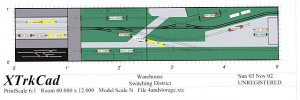

Jake - I found this on the net - Might help with your Airbase
Shortliner(Jack)away up here in the Highlands
