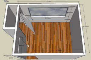

Hey Cid
I think this is what your after. I would prefer not to duck under but if anyone has any ideas i am open to them :thumb: I am after 1930-50's coal mining layout through a lush mountain range with some water involved and bridges also with a 3% grade and maybe dual tracks.

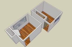

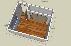

Here is the other room at my disposal. Pretty much the same size but differant none the less. Which do you think is better suited ?
The other pic is both rooms side by side for comparison

Hi steveD welcome to the gauge(from one newb to another :) )
id go the second of the two and either lose the sliding doors on the cupbard OR just open the whole lot up as if the cupboard was never there,id rather have the 3600mm run.

Thankyou and Hello from Australia, hehe. I like your idea of losing the cupboards! Fantastic. Maybe i can use that for a staging area? It is very hard to choose but i agree with you that planning is the most important, it just there are so many differant layouts and designs to choose from!

Steve -
Awesome drawings! Is that SketchUp? Cool program that I do not have nearly enough time to play with...
I too like the second room, and if you can modify it in any way, so much the better. Even if it has to remain as is, the sliding doors mean that you do not have to allow for swing of a full standard door.
Is there any way you'll be getting the use of both rooms..? ;) :D

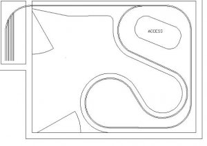

As far as design, you could run a point to point (no continuous running) from the cupboard (coal mine), around the walls to a port near the window where the coal is loaded onto ships. That would give you one main industry. Halfway between could be a town that ships goods (and workers) up to the mine, and down to the docks. It would also receive goods from the docks. Separate the town from the mine with a mountain "range", and the town from the docks with some other landscape (agricultural, forest, etc).

I like the first room with the small closet. Take the closet door off the hinges and put it away, or use it for bench work. More space in this room.
The other room is ruined by the little tunnel you have to go through to get in to the room made by the wall for the closet. I have worked with closets like that before and they are a pain. Put your bench and storage in the second room and the layout in the first.
Just my opinion.

Hey Fuzz,
I would love to have two tracks, one a continues run & the other point to point. Can that be possible?
Andrew : Yeah it is Sketchup, top program and sooo easy to use! I like your idea for the coal mind, point to point. Is there any way to include both styles?
Steve...
Sure, there's always a way :) :D
It would require a duckunder/gate of some sort to traverse the open door. I suggest you look at LoudMusic's thread "Preparing to begin again". He is tackling the same sort of issues as you, although his room is slightly larger.
