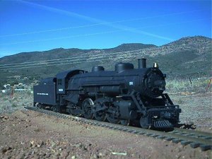

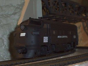

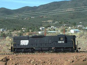

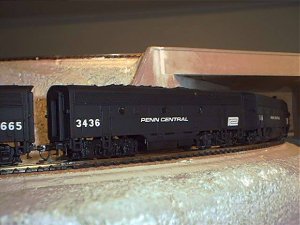

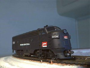

I took a few photos of some of the locos I just painted.
The photos are a little fuzzy.
PC#1734 is an old Bachmann F9 shell modified to represent a phase II F7. It is powered by a heavily modified Model Power dual drive F7 chassis.

You should enter these in the scratch competion. That GEEP pix is WOW. FRED
Oh yeah!!!! Those are nice Ray! That F unit looks particularly sharp with the red P. Say, where's the PC logos on the steamer!? :p
Beautiful work as always!

A steamer with PC logos. Hmmm, Interesting idea, as the PC actually had some old tenders on the roster. Thats half the battle. If a steam locomotive survived in operation on the PC I wonder what it would have been.
I'll get a photo of that modified MP chassis with an explanation of it.
For the photos I took outside , I turned an old garbage can upside down threw some dirt on it, placed a piece of track on then did some landscaping with my fingers.
Does this qualify as a diorama?
Unfortunately it was destroyed by one of those Dewey crosswinds that blew it halfway across the yard.
RAY

The only loco I can think of off hand with the smoke unit in the tender is an American Flyer Hudson. There may have been others.
Is there a number 6318 on the cab and New York Central on the tender?
The motor I put in #9236 was a 6 volt, 7 pole, ball bearing motor I salvaged from an MSA portable air sampler.

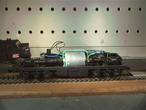

This is a photo of #1734s chassis.
Electrical pickup was added to all wheels.
The worm and worm gear were changed to give it a 20/1 ratio as compared to 9/1 and my favorite motor from a VCR was installed.
Some milling was required for the motor to fit and a mounting plate was fabricated on one side and a support bracket on the other.
The motor was made into a double shaft motor by pressing the shaft further through the armature using my drill press as a arbor press.
This is a VERY delicate procedure as you must support the commutator as well as the polls when pressing to prevent crushing the commutator.
Styrene was added to the sides and rear to widen the chassis to the dimensions of the Bachmann shell. Mounting tabs where also fabricated.
The truck mounted coupler mounts were cut off and KDs were mounted on the chassis.

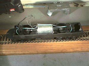

This is an Athearn chassis with the same type motor. They are a high torque motor with a lower RPM.
This will power the F7 A-B-A set I'm finishing up.

That 1734 turned out great Ray. I found your repower shots of the f unit of interest too. I've got a pair of F-9's that I want to kit-bash into an FP-7 and will study your frames for guidance.
Thanks for sharing.
