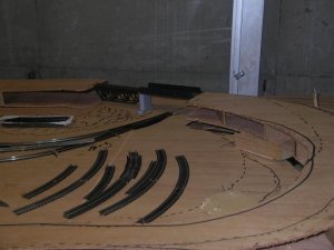

So I FINALLY started laying the groundwork this weekend for my first "real" layout. It will be built upon a 80"x32" hollow door. So far, I've verified where the track will lay, made some adjustments to the original plan, and cookie-cut the two grades.
Not much to look at yet, but I'll document my progress as I think of it. I'll post pictures as they are available.

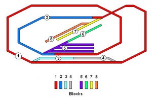

Figure I'd post the block schematic. 8 Blocks total.
I split the passing track into two blocks, so an engine can come up behind the other without hogging the mainline.

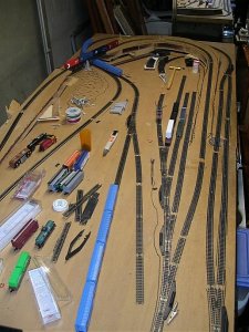

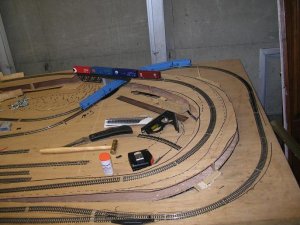

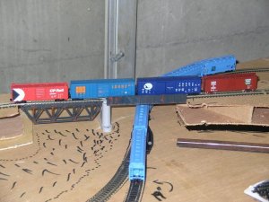

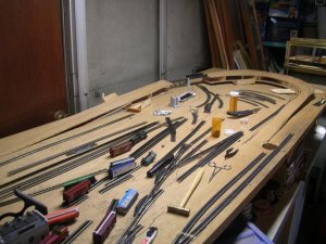

I finished laying the track (Atlas Code 80) this weekend. I'll be starting the wiring this week at some point. Not really much to look at but I took some pics of the progress:

Hi, It looks to me like you need a separate block on the right hand side of the main so that trains can approach the passing sidings from both sides, and you want both sidings independent of the main so that you can park a train on either leg of the siding. (no DCC right?)
Looks great.
Looks great.
Thanks :mrgreen:
Right, no DCC. I'm going to restricting the direction of the engines to run only left (clockwise) around the layout, so I opted to leave the blocks as is. That's why I separated the passing track. An engine can sit idle at the left end of the passing track while one pulls in behind. Once the front engine leaves the track for the mainline, the engine can pull the rest of the way into the passing lane.
It's a relatively small layout and I didn't have much track, so I planned it to only run a max of two engines at a time on the main. I most likely won't do that often as I only have two throttles.
My planned operation is use one throttle to run a freight around the mainline while the second does some yard switching.
