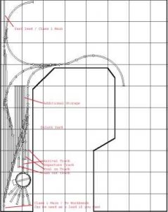

Okay... here's a really really rough first draft. The lines surrounding the trackplan denote the pieces of Ikea shelf. This is one possiblity that would see a staging area off of one corner. The staging track would dip below the curves on the left hand side. However, the drawback here, is that at the moment it's a 6.8 grade(!!!) So I'll need to do some adjustments... As you can see, I've lifted a yard from another plan I drew up, but haven't found a real place for it yet. There are also not enough crossovers to make it work.
Plus, there will be a reversing loop set up in this through the three "mainline" tracks that run close to each other in the middle. The track at the back would likely be hidden from view.
Anyway, any suggestions? I'm pretty open, including throwing the whole thing out! :)

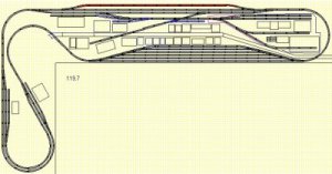

Heres one that I had worked on to go up against a wall in a spare room. I would have been built on 4 2'x4' modules. Now I confined to the laundry room with Mr. lennox and Mr. whirlpool on 36" x 80".:( Something is better than nothing though.

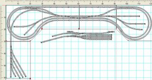

Heres my yard design.Perhaps you can find something useful in it.Good Luck
