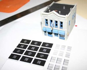

Photo 1. - I started with a sheet of printed windows on transparency paper. Printed multiple (just in case). The design was done in Photoshop at 600dpi using a neon-style font. I originally "broke" the lines of the letters to make it look more like prototypical neon tubing, but in N scale, you really couldn't see much of a difference, and it just made the words less readable. Also on the printed sheet are cafe curtains. In the background is the building these will be going in.

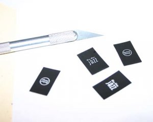

Photo 2. - The pieces are cut from the sheet. The pieces are layered to make the black more opaque -- 3 layers in all In this photo....2 of the layers have been glued together...one more to go. I used Testor's glue...the kind that's made to bond clear styrene. Can't remember the name of it. But it dries clear and even with backlighting this application, it's completely invisible.

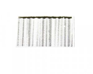

Photo 3. - This is a close up of the cafe curtains that will hang in the window. This is printed on transparency like the windows themselves. Note...this is an EXTREME closeup. This was printed on a laser printer at 600pdi. It's so close, you can actually see the dots! In real life, this is a smooth shadowed curtain.

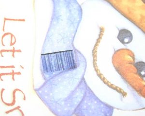

Photo 4. - To give the curtains the right texture and color, I used a winter-themed notepad featuring a snow man. The scarf was just the right color and has enough of a texture to appear like a pattern on the curtain. I glued the transparency to the snowman paper with Elmer's white glue.

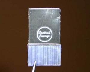

Photo 5. - This is the assembled window, with neon sign, curtain and curtain rod.This photo does NOT do it justice. Again...extremely close up. In real life, the black is completely solid and doesn't appear "scuffed". The flash on the camera made this look really bad. But anyway...The Cocktail Lounge portion is completely transparent. The curtain was glued to the front of the window piece with Elmers. The curtain rod is a very tiny brass wire glued on with CA glue.

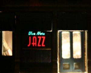

Some more progess. Sorry I didn't take photos of the color installation. It's really just a red Sharpie and light blue highlighter on plain white paper glued to the back of the window.
These shots are with some pretty bad lighting conditions -- didn't have a handy small light to fit inside the structure. But I made do.
Also, the rest of the interior will be detailed, so ignore that for now.

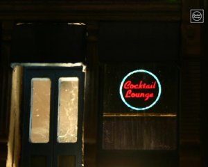

Photo 1 - Cocktail Lounge from right window. In the upper left side is the real-life size of the design (provider you're viewing at 72ppi -- which most of you are).

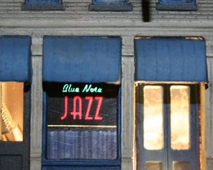

Photo 2 - Blue Note Jazz from left window. Sorry it's a little blurry.
Photo 3 - Same Jazz sign with a bit more external light.

I really can tell right from left. The real-life size of the sign is in the upper RIGHT of the first photo.
