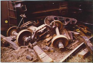

Here's some pix from a freind who worked wreck trains for 30+ years on the old Frisco. This one show what a beating the trucks, ties and rails take. Note the truck springs scatter everywhere (something like my workbench when I sneeze at the wrong moment :oops: )

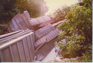

Badger Pass, Missouri. This train accordioned itself after a rock slide hit it mid-train. Note how the sheet metal is ripped and torn as well as buckled. Note also the sand load from the hopper that was split open.

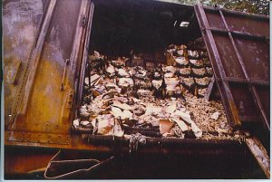

French fries anyone? A reefer full of frozen potatoes that caught fire in the yard. Note the colors on the scorched sides of the car.

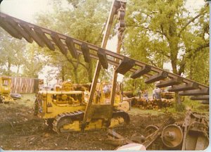

This'll be easy enough to model with Atlas Snap-track :thumb: Wreck train crews work 24/7 'til the line is open---any way, any how and be sure it's done yesterday. .

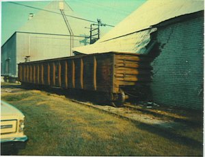

And, for the folks with small pikes, wreck scenes don't have to take up a lot of space. One of your LPBs forgets to set the car brakes on a siding with a slight incline and you have a bad Monday morning scene like this one... Hope the pics give you some ideas :wave:
