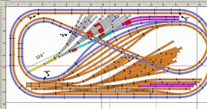

Wow you have a lot of tracks there.
I was curious about the way you designed your yards. I see you have a separate one for each side of the mainline, but then within each one there also seems to be different areas. For example the orange yard has the horizontal spurs at the bottom, a large block of spurs on an angle in the middle and then a smaller block of spurs on an angle to the left of the larger block. Do these all have different function? What are you planning on using them for?
Hello, Platypus...
To understand the layout function you have to know that it's divided into an upline(main and sidings in orange), and a downline (mauve). Each has a dogbone running main, a freight-car yard(the rightmost diagonal spurs in each color), and a loco-yard(the leftmost smaller diagonal spurs in each color). Upline trains ALWAYS run from right to left on the bottom-most mains, and downline is opposite direction, always.
Each freightyard allows marshalling and selection of indivdual cars, which are shunted into full-length rakes in the purple sections at the right of the horizontal sidings.
Each loco-yard allows a single express-loco to be selected, and this runs down to the rake standing in the purple section and draws it onto the main.
Trains leaving the main are drawn into the horizontal sidings, broken up and remade by shunters, and unwanted cars are shunted off individually back to the freightyards.
Hope this makes sense!
Hi, TripleX, the short switchback-lead you refer to is purely for the downline loco-yard and its length is set to accomodate the "longest loco" only.
The very short spurs in this loco-yard have been improved considerably in an updated design.

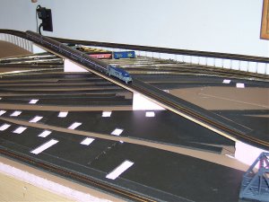

Before and after images, showing the transition from virtual to real...
(See more on the Picasa website..)
