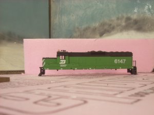

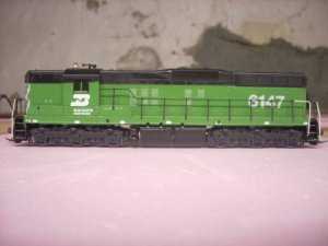

I am converting a BN SD9 into a low hood missabe SDM. I may need help as this project goes along so I decided to make a new thread. But so far I have began to rebuild the cab. I have added one styrene strip and that is as far as I have gottten, but here is the first pic of the project.

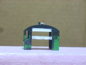

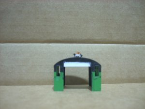

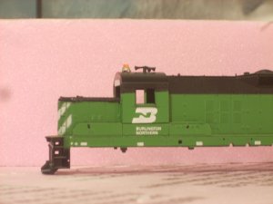

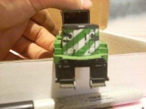

Well I headed down to the basement to see what I could do, and I am almost ready to paint it! i cut the top of the hood off fine and then started to cut out a section of the short hood only to realize the cut was uneven, but I straightened it out. I scrapped of a few details and looked at the prototype pic, I have the wrong fan arrangement on top, but Im not worried about that. I have glued in the front parts of the cab, I just need to round the window corners and add the center divider betweeen the two windows. This will not be perfect by any standards, but for the first one I reconstruct (I will probably do a half dozen or so more) I am VERY happy with the way it is comming along. But you are probably tires of reading, so here are some pics. I also posted a pic of the model before I began.​

i have used 3 types of putty. First is contour putty by testors, comes in a gray tube. It will fill surface scratches okay, but is not good for larger gaps. It dries kinda soft, and shrinks when it dries. The second is squadron green putty found at hobby shops. It is used about the same as testors, but I like it better. I think it dries a little harder and is better for larger hole/gaps. The third is a surface spot filling putty made by bondo. You can buy it at auto parts stores. I think it dries the hardest of the three and like it the best, but have only used it for model applications just once.

I have been looking at my work, and i do think on future projects I will try using a cab front. When I take off the as is cab on my model, the cab front has nothing because it is covered uop by the high front nose. I could probably use a cab front from almost any SD cab.

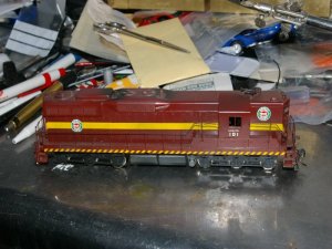

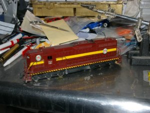

Here's a couple of images of a Trains Inc SD9 that runs on ENDO Trucks - it's got a Tenshodo sibling, No 138, and a Tenshodo Gp7 painted as DMIR 89, though it's slated for a repaint as a MEC passenger unit since it's Non Dynamic-Braked, and has a steam generator.
I really MUST create some space among the Cobras, Daytonas and stationery to work on locos
