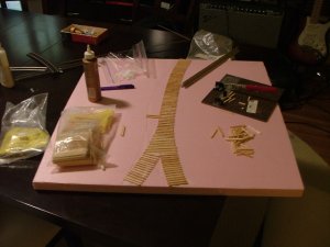

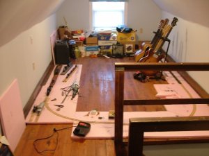

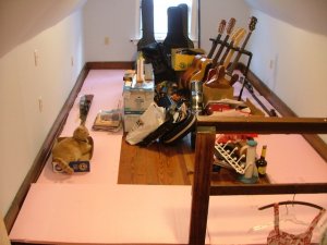

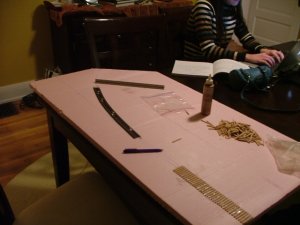

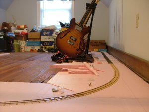

After laying around 11' of mainline over the past 10 months...I decided that it was to get serious about having a layout (rather than just the equipment. My track plan is a basic oval with a 28" minimum radius. I have one siding, a future wye, and a future passing siding.
Half of the mainline is/will be on cork roadbed...half direct on the foam board. One of the curves will have tie plates. My intention is to build 24" tall benchwork with storage space underneath...and then cut out the right of way and add mountains, streams, etc...

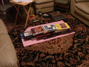

The track laying procedure is: Glue down ties...lay many books on top of them as they dry...then sand...then add rail. The previous method was to glue down the cork roadbed...pile on the books...then glue down the ties...pile on the books...sand the ties...paint the ties...paint the rail...spike the rail down.
I use both spiking tools and needle nose pliers. I have a rotary tool to speed up the turnout making process. I use HO flex track to assist me in laying out the ties.

A few questions and comments:
1) your cat looks like my cat
2) I see you are laying the ties directly on foam, and then are spiking the rail. Does the rail hold adequately with spiking into just the ties? I am asuming the foam is rigid enough that it has no "give" when you press a spike in. I am considering laying my own rail, but was told that homasote under the ties is a must. Unfortunately, I can't find homasote anywhere around here (or foam for that matter). My plan is to use standard plywood subroadbed, and then luann plywood roadbed.
3) be sure to not take up *all* the space in that room, cause it looks like you have other stuff that need storage!

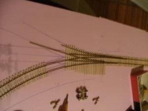

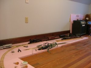

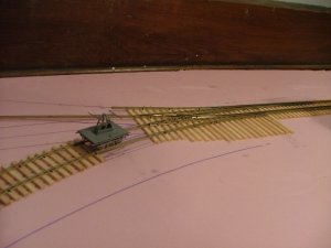

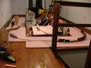

My trusty assistants Pumpkin(Mr. Pumpers) & Chester. I think they ate the track gang...since we can see their handcar (which is a working model) abandoned next the incomplete stub switch.

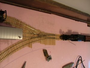

In the next picture...it is obvious that the grading crew came through. Then there is a nice picture contrasting the size of HOn3 and On3. That's my HOn3 mainline...all 3' of it...which isn't long enough to hold my entire HOn3 roster. Beyond that is my dad's old On3 mainline...24" long.
The corner closest to the stairs will be a trestle...but for now it is just widely spaced ties. And the final picture shows the nearly completed 3-way stub switch...with the temporarily soldered jumpers in place.

I'm actually using slightly less than half the space...you can't see the space behind me...the wifey said no at the present time to conquering the whole 30'x8' space :mrgreen:
The foam is an experiment...and I'm going to go back to cork roadbed in the future. It did give sometimes while spiking...but it didn't cause a problem except at the turnouts. I personally think that cork roadbed is ideal for driving spikes into...and I'd never again consider using plywood or particle board directly under the ties...made those terrible mistakes before...as well as laying my HOn3 into pine...all 3 required pre-drilling the holes. I really loved ties-on-cork-on foam.
Homasote is a lumber yard material...I get my foam from Lowes or Home Depot. I'm hoping for nice Lowes/Home Depot gift cards to buy material to elevate the layout and have storage for everything but my guitar rack and Marshal half stack under the layout.

great progress there man! that handlayed track is gonna look great :thumb:.im considering hand laying turnouts on my HO layout,on a level of 1-10 how hard do you think it is? i have to have 40+ switches and i REALLY dont want to have to buy'em all and have half of them not work :curse:.keep up the good work and pics :mrgreen:.--josh
bigsteel, it depends on your tools. Of course...you could save enough money to purchase...$300-$800 worth of tools dependent upon what turnouts you were going to purchase. I would highly recommend experimenting with it as it is definitely doable...and could save you enough to add a Precision Scale brass C&O L-1 hudson.
My 3-way stub switch was a nightmare...I'm going to use PC ties and solder the next time I do something like that. The wye turnout was also a pain since it has two curves. The older stub switch was no sweat and my previous turnout experiences were also easier. Stub switches are definitely easier than point switches...which is what you would need to build...but that's because the only part that requires any work is the frog. I've had success with both in the past. I also made it more difficult by not having cork under those two turnouts.
If you print out some templates...you should have no problem building 40 nice turnouts on the cheap.
