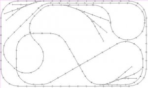

Hi everyone. I'm just back from home depot, i picked up some of that foam board and i'm headed downstairs to begin setting up my first real layout. I used rts 7.0 to draw this up:
attachment.php
It has a couple of issues, i couldn't get the tracks in the north eastern section to line up to make 90degree crossings in the program i have no idea why, but i suspect i will not be able to get the track to line up for 90 degree crossings in real life either hahaha. The other issue is top center the 4th rail down. I couldn't get that to line up either. I used the templates for atlas code 83 tracks but the inner most 2 rings will be power loc.
I have to learn how to use elevations in the program becuase the power loc is to fly above the atlas track and i can't model it correctly in the program. I am also going to need some help wiring my bumpers as i have not a clue as how to correctly use them :oops:.
I've been rading about wiring. the only secitons that re linked are the two inner most rings as i don't know how to wire quite yet. I figrue i'll get this rolling and then play w/ wiring cross segment switches once i get my books in the mail. I boughts some small nails to stick in the little holes in the track to the foam. I have to buy some felt but i'm a little tapped so my layout is going to be pinkish for the xmas season hahaha. :thumb:
Will send pix as time goes on.
Feedback welcome looking to build a bunch o layouts ot learn.

The reason that things won't line up is that the program your using, if it is a good one, forces you to use correct radii on curves. If the only way to get the crossover to be 90 degrees is by fudging, most track planning programs won't let you do it. If you "fudge" it in your layout construction to make it fit, you will probably create a place for a lot of derailments.
If you are not very experienced with wiring, don't put in that diagonal track from the top track to the bottom track from upper left corner to lower center. That track created 2 reverse loops, without insulated rail joiners and double pole douple throw switches to reoute the power, you wil create a short circuit.
You have the potential here to run a few trains on a sort of demonstration layout, but there isn't much there to do operation with. If you are looking to build something where you can watch the trains run, this plan will work. I also wonder what the purpose of the small oval in the lower right center is?
Thanks for the tip i've notcied that i slipped a 22" radius curve in there some how. I have to adjust that.
I have a couple of plastic insulated rail joiners but i don't think i have a dp dt switch. Do you think if i change it from going backwards to goign in the same direction it would work?
Yes, i planned on running 3 or 4 trains to get myself oriented to working this sort of stuff out. The loop in the lower right was to get used to laying and operating switches properly. I had a question about the switches, at what angle does the fork come off of it? And why do switches mess up my symmitry? What sized piece do i need to stick on the end of the gimpy leg to make it even?
If you turn one of the 2 switches forming the double reverse loop, you will eliminate the reverse loop, but with all of the track you have running already, do you really need another optional route for your trains to take?
Regarding switches, they are measured differently than curves. Curves are measured by their radius, except for Lionel which measures theirs by diameter. The switches are measured by the angle of the frog. If you aren't clear on what the frog is, it is the part of the switch that looks like a frogs back footprint. I think switches also have an easement built into the tangent, so that also makes the curve a bit bigger. If your switches are Atlas Snap Switches, they are probably #4.5. Atlas sells them as a #4, but they are actrually slightly larger than a #4. In Atlas Custom Line you will find not only #4, but #6, & #8 as well.
By the way, I forgot to ask earlier, are all of your loops on the same level? If they are at different levels so that the tracks cross each other on bridges, you won't have a problem. If you are going to have them all at one level, all of those crossings will cause a bunch of headaches. #1 You may have difficulty finding crossings at the right angles for each crossing. #2 If your are running multiple trains, the crossings will play havoc. Every time the tracks cross, you have the potential for a crash.
I bought a crap load of switches and i have to some how justify them to the boss/cfo of the house. They serve absolutely no other purpose right now until i can take some quality time w/ a good wiring book and learn how to do reverse segments and power zones/districts etc. Right now based on the current design the outer loop is ~34 linear feet, i've been reading that a good practice is 1 "feeder"(18gauge) per 3ft to 6ft connected to a "bus"(12-14gauge). I don't think my layout is big enough to need a "bus" so i'm going to use 18g stranded copper to a terminal bar w/ star washers and spades w/ conductive gel on the other end.
I'm not really sure how to extend those tiny wires from turnout machines (<== i'm starting to get the hang of the terms!!! :thumb:) to a single point or even if it is a good idea to extend the wires to a single point.
Great info :). Frog i understand, tanget i understand too, but what is an easment? I think land in my front yard the township can steal to make the road bigger.
Short answer is yes except for one. I wanted to have a couple 90d crossings, but now that you've mentioned it w/ my children i don't think it such a good idea anymore. I've been reading about presence detection in dcc and got the bright idea that i can use some form of mechanical presense detection and cut power to that section of the track. I like watching the crossings :). I bought a couple of larger lots of track on ebay a few days back so i have 90d for power lock 90d, 60d, 30d, for atlas and thanks to another forum member i have powerloc to atlas converter pieces too.

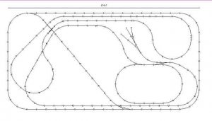

O.k. i did some thinking, i 've also taken a good look at what i have downstairs and i came up with the attached.
The loop at the lower left is power loc, and it will be elevated above the 2 other atlas loops. I'm trying to figure out where to put the last loop for the last family member :).

Are the rail joiners flat the full length on the bottom edge? The reason I'm asking is that there are joiners made by a couple of companies, Atlas and Micro Engineering that are transition joiners for going from one size of rail to another. It sounds like you may have some of those. If there is a step on the bottom of the joiner, they are transition type. If they are flat for the full length, they may be for either code 83 or 100. Does anybody else know if there are joiners that can be used for both code 83 and 100?
I bougth a bunch of atlas ones from hobby hut. They say 100/83 on the package.
