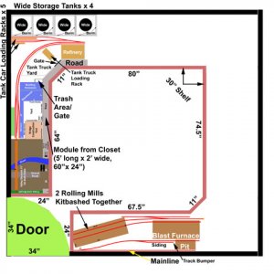

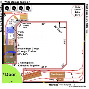

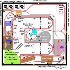

Hey Guys, I was really bored and had nothing to do so I made a dream layout. I hope that one day, when I finally get my own place, I can start work on it. It will be 2 levels with a hidden helix connecting the 2. Here is the top level showing what I have done so far. This is build in a room that is 12 x 12' square with a door in the bottom left corner. The switches and most of the curves are drawn to scale, I drew them up in photoshop and used some curves that I had. The mainline has 22 degree curves and most sidings and other tracks have 22 or 18 degree curves depending on what it is.
The layout is 2 30" shelfs and 2 24" shelfs with the measurements of how long they are next to the reddish lines that are the edge of the benchwork. I am also going to make an island somewere that extends out to the middle, also a 30" shelf.
Starting with the left is the module that I will start construction on after christmas consisting of the Viaduct and the Highway Bridge Under Construction. The Blue is a warehouse that is custom built to fit the area. Has a boxcar siding and of course docks for trucks. Behind the building is a small area for trash dumpsters and trash compactors were trash trucks can pick up the buildings waste.
The small green building is the Walthers backround building Armstrong Electric Motors. It also has a siding.
The orange is a refinery that consists of a Walthers Refinery, 4 storage tanks with berms to simulate a "tank farm", tank truck loading rack with a storage yard for tank trucks, and 5 tank car loading racks, one has 3 kits combined into one and the other has 2 kits combined into one.
On the bottom in the brown is the steel mill. It has 2 rolling mills kitbashed into one building and cut at the corner to fit the benchwork. There are 2 tracks that go into the rolling mill and the other third door opening will be used for tucks since there was no way to get another track in there (now I realised how crazy I was in my earlyer trackplans with using so much track). One track comes from the blast furnace (which will have a track bumper at the end of the track and will not connect to anything) and goes into the rolling mill. There is also another track right next to the blast furnace and also ends in a track bumper and also goes to the rolling mill. This track comes from off the mainline and is the track were the gondolas... get loaded. The other track that comes directly from the blast furnace is used for the hot metal cars, bottle cars, and ingot buggies. The box labbled pit is still part of the blast furnace and is were the coke gets dumped into the conveyor for the balst furnace. The Coke Oven will be down the line and drawn in later. This area is still not finished but no more buildings will be added in, just a couple more tracks. O ya and the bottom track is the mainline which is a single track.

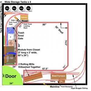

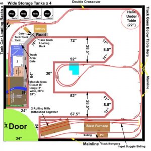

Here is the finished steel mill section. I added an inbound line (the first track that comes from the mainline in on the far right center) and it leads to a small yard area that would extend if there was more layout. I extended the two tracks (one that comes directly out of the blast furnace and one right next to it). I also added a small siding for ingot buggies when they need to be moved out of the way for bigger hot metal cars and bottle cars. All three curves in the lower right corner are 22 degree radius curves.
The extra small writting around the switches and buildings are just notes for my self and tell me the switch size, radius degree, and building dimentions which I can see by zooming in on in photoshop.

I was doing the helix when I realized that what I thought to be 22" radius was not and was huge. I re-did the 22's on the bottom right and they are now correct. I also added the helix in. It is also 22" radius. I fadded the colorof the line to show were the track goes down below the layout and into the helix. I have not decided how big to make it yet. There will be a scenic divider that blocks off the helix and track leading up to the helix.
Also made the ingot buggie siding longer along with the other 2. I added 2 #4 switches in coming in off the inbound line to have access to the rolling mill. Next I will add the island extension.
How big do you guys recomend the helix to be between 2 levels?

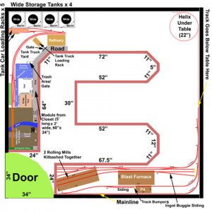

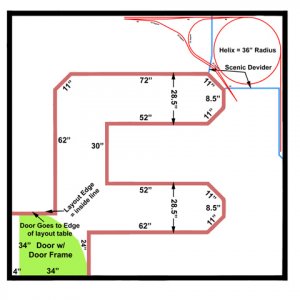

That point that you have to squeeze through as soon as you walk through the door may need some re thinking. It looks like it can't be more than 16" or so. Also, if this room is using conventional wood framing, usually bedroom doors are offset from the corner 4" and come in widths of 2'4", 2'8" and sometimes 3'.
Thanks TrainNut. I measured my door in my room just for the heck of it and it was 30" wide (not includeing outside frame) Then I measured the frame with was 2 5/8" wide x 2 for both sides. And you were right, it is ofset 4" on both sides making a total of the door w/offset 39 2/8" wide. Have to go back in fix that, that might take a few minute, LOL. Also have to make that opening as you walk through the door bigger as you pointed out too.

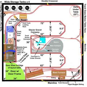

I also made another change to the 2 isles when they looked a little small to me. They still are not that wide but they are now 28.5" wide. I finished laying the mainline on the top level and started to make the quarry using my glacier gravel company building. I put in a #4 WYE so that a train could come in off from either side of the layout. The rest of the empty space on the island I want to be a quarry with some huge mine shovels and off road dump trucks. Also still have the conveyor that comes from the bottom of the quarry and to the building. The big loops at the end of the island are 22 degree radius.
The mainline in the bottom right is just a single track but then becomes a double (using #6's) to join up with the double mainline at the right center. (Member that the fadded track is under the table). There is also a double crossover at the top center of the mainline.

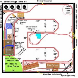

Ok, I fixed the door problem. The green is the door and it includes the 30" door itself and the door frame. I also added the 4" from the wall.
The layout edge is the inside of the reddish line and the door just clears it on the side with the bridges and river.
& now that you have widened your doorway a little, it also more or less fixes your clearance problem at your point of entry (though I think I would still round those corners or 45 'em a little).
The opening is 20", still not that big but big enough. I can round the corners off too which will give a couple more inches.
I finished drawing the Quarry and added the Truck Dump Conveyor and the Main Conveyor that comes from the quarry. The fadded portion of the main conveyor is under ground and comes out at the bottom of the quarry and will have a loader on it for off road dump trucks to dump into. I want the quarry to be somewere between 10-15" deep with some roads going up the side of the cliffs.

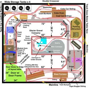

Here is the coke oven. I decided to have this seperate from the steel mill because the coke ovens are not usally found on site with the blast furnace and mill.
The coal cars come in from the Western Coal Mine (will be on bottom level) and dump there loads into the coal pit. From there it travels up a covered conveyor into the crusher house and then up another conveyor and into the coal bunkers. Then it goes into the oven and finally ends up in the quencher were it has been made into coke. It then travels in coke cars and to the blast furnace were it is cast into steel parts for buildings, bridges.....

Here is the last building on the top level, it my Hotel Under Construction. When I put it onto the layout, I will get another hotel kit and make it taller and have a better tower crane in. I also plan to have a big crane building a parking structure for the hotel. It will be constructed using steel beams.
Also added a substation and two transmission towers in (one is right next to sub-station and one is on the corner). And last thing was the highway bridge in the bottom right corner, I fadded it to show the path of the bridge.

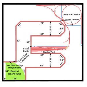

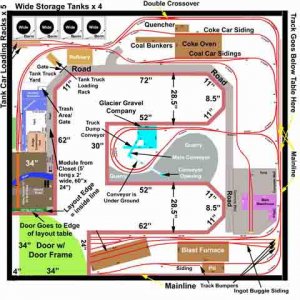

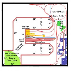

Just started the bottom level. I decided that I wanted a bigger helix so I changed it from 22 degree to 36 degree radius. Right out of the helix there is a #6 switch. This one curves off to go the other way on the layout and joins up with the second track from the opposite direction. It will re-main a single mainline on the right side of the layout and a double mainline on the left side. The staging area is going to be on the island. The blue lines are scenic dividers so that the helix and track leading to the helix is hidden.

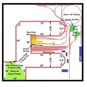

Here is the staging yard. I added a scenic divider in to seperate the yard from the other side so I could put some small buildings in on the island. There are a total of 11 #4 switches and 3 #6 switches with a #6 coming off the mainline into the yard. It is a decent sized staging yard I think.

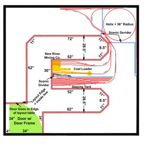

I added the New River Mining Company and the Coal Flood Loader. A #4 comes off the mainline in the tunnel and then splits off into another for the coal loader and also 3 tracks for the Coal Mine. A small mountain is up against the backdrop to simulate a large underground mine. Mountain will be mostly cliff faces since it is such a small spot.
Grain Complex
Here is the grain complex. It consist of the ADM Grain Elevator and a Red Wing Flour Mill Kit. The mill gets served by rail in the front and trucks in the back. The Grain Elevator gets served by trucks in one shed and rail cars in the other. You can also see the starting of the HUGE cement plant whic is the next post.
