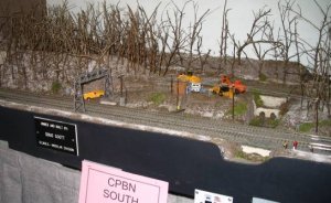

Ok, this might not be exactly what you are looking for, but it is a pretty good job at an early winter scene. I really like the light dusting of snow, which is rarely modeled. Most of the time it's either blizzard or bust.:D But, since it does occasionally snow in NE in November and sometimes even in October, this is an accurate representation.
Regardless, I would use almost no green and heavy on the brown. The tobacco suggestion is a good idea. The bottom of the can or bags always have a pile of scale dead leaves. Not the pretty colorful ones, just the brown dead ones, but for a post peak leaf season they are perfect.
