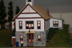

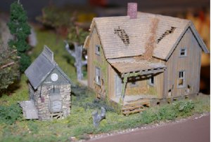

It doesn't say what the material is. Is it plastic or plaster? I love building craftsman kits. I typically use a base-coat of paint that is a little lighter than the finished color. In this case a beige, let's say, for the stucco. Then from there I use washes of highly diluted paint (in several applications) to sneak up on the final color. The washes will vary by what area you're modeling. Artist acrylics work well. I typically use greys and blacks. The important thing to remember is to start light, then work your washes darker. You can't go lighter.
looks neat,likin the southwest archeticture.i normally just apply the same color of the building over the lettering to make it look faded then use india ink diluted with achohol to bring out the deails.ittl look cool on your layout!--josh
