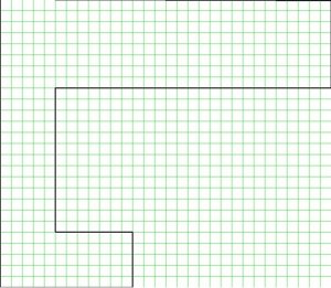

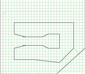

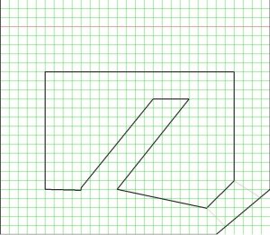

As promised, some conceptual benchwork designs.
I don't know if the dimensions are on the the pics.
The area is 13'x15'. The grid is set at 6"
The first shows it's current state.
The red lines indicate either a backdrop or a lift out section. Except the 3rd one, the lift out is colored in purple.
I personally like the 3rd design the best, but the penninsula needs to be re-oriented.
Any input???
Thanks,
Matt
