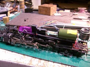

More sad news...the motor has gone up in smoke!
The motor, a three pole cassetterecorder motorlike can motor, couldn't handle the extended run.
The contakts, just metal strips, have burnt away.....what a junk!
Ordered two new brushless motors from a local dealer, 15 euro's a piece, not expensive.
If those don't work i have found another five pole can motor in my junkbox.
i burnt my fingers when i tried to stop the motor, so it's strong enough.
The bachmann decoder has also died , had a complete short.
I have asked the seller for a refund for the costs made.
see what happens.
Ton

Hi Bill, yes i know what you mean, i thought the same way until somebody told me otherwise.
Those rc brushless motors are three phase motors , you will need a separate piece of electronics to control them.
Thats why they can make a lot of revs.
The one i use is a maxon swiss made professional motor normally used in aironautic instrumentation applications.
It has a normal two lead connection and makes about 8000 rpm max.
Look for second hand Faulhaber, Pitman, Canon or Maxon.
When new they are expensive.
Right , back to installing . It's going to be tight.
Ton
OOOO yes!!!
I have installed the maxon this evening and it runs excelent.
I've got Powerrrrrrrrr!!!!
The K27 has run with 60 axels behind, no problem!
still waiting for the Tsunami.........
Ton

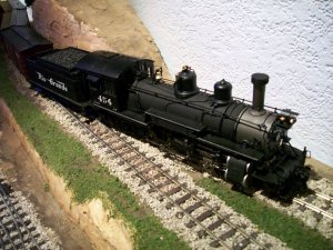

The tsunami K class decoder has arrived...and i have installed it.
WOW!!! what a difference!
The K27 runs smouth and slow.
What a noise , i had to throttle down the volume....
What a difference a good decoder makes.:thumb:
O, and i repainted the body black instead of green.
Ton

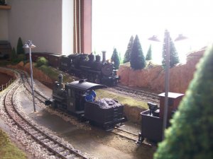

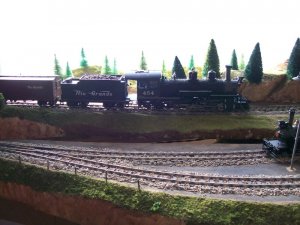

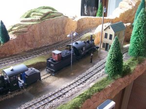

Here are some more pics of the K27 and others on the Rozeburg & Waterway RR.
I've tried to make a movie with my photo camera but the sound is not good.
