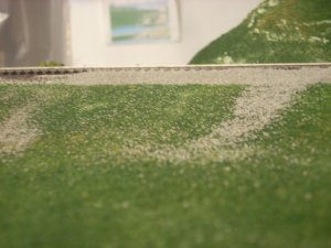

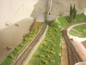

Here are some pics. I have the track to the lumberyard ballasted, and I sceniced the space between the siding and the main, I did this a few weeks ago, so its about time for pics.

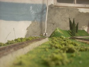

Next, a shot of a low area next to the main, where I thought some washed out ballast would look ok. Ill need to add more to the scene, along the lines of rocks, dirt, etc. Just not sure what yet. Any opinions on it yet?

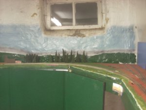

Last an area outside of the yard, where the main passes an engine/caboose facility. There will be a maintanence building, and more pines to the left. This pic was actually posted first.

Kevin, I know you can create better scenery than that! It looks toylike. Minnesota and surrounding areas are covered in tall, multi-colored green and brown grass. to make tall grass, purchase faux fur from Wal-Mart or other preferred big box or craft store and die it varying shades of green and brown with RIT dye. Then cut it into irregular shapes forming little meadows. Put in some dirt and swampy areas by using sifted dirt and dark green ground foam. Then line the meadows with conifers and decidious trees, mixing it up as you go. Then add roads made from styrene and durham's water putty.

It isn't that hard to create stunning scenery, and you have the talent to create an exceptional model railroad, and I think you can make the little extra effort to do that.
You might also want to invest in some thin particle laminate wood board to make some sturdy, seamless backdrops that don't look like they were painted on a stucco wall. It doesn't cost much and it'll look great. Also try to use FLAT paints or seal the paint with a flat finish so it doesn't look so odd in the photographs.
This is not a personal attack and I have no intentions of offending you. This is just some advice to take the next step towards beautiful scenery that you can really enjoy seeing your trains flying through transporting the nation's vital supply of red-iron ore!
If you need some advice on how to do some of this, feel free to PM me.
Thanks, I know my scenery isnt the best, but there are no trees yet, or hardly any, and Im counting on them to blend it all in together. Pines over the clump follage make a good dense pine scene, and I hope modeled birch trees will cover up the backdrop pretty good.
But who am I kidding? Im doing my best to hurry, instead of doing my best to make believeable scenery. Guess its off to walmart and home depot tomorrow to begin doing better scenery work.
Thanks for the pics, I have books of Northern MN and have seen hundreds, but those are some of the best examples. And being how they are on here I can get great help modeling them.

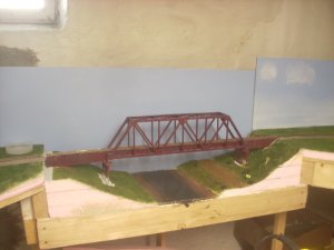

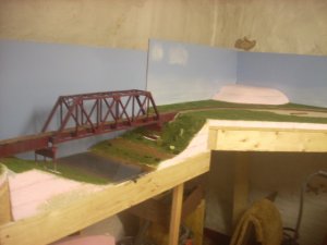

I got another piece of backdrop in and glued togther the bridge sections. I than began making the rest of the bridge track to go along with the piece I bought. I miscut a few times and now have a few pieces soldered together (including a bad burn which hurts like a ***** while Im typing:curse:) but I ran a miniquad over what I had done and it went very smooth. I hate not having the camera, Id love to post soome pics.
I cant express how much I hate not being able to post pics! Im getting alot done. I have the bridge in place with bridge track over it. The bridge nor track is secured, Ill keep it that way, but might use a little sticky tack. I have a hill made between my yard and dock approach, but now I need to make the dock and supports fot the approach. I have spliced in a new piece of track on a section where poor track work has been causing many derailents. I was also able to stretch in a little larger radius in that spot. Ive been cleaning the track and got the last piece of benchwork in under what will become the ore dock. For the most part I believe thats it, but I have run into one problem DCC wise, so Ill post a ? in the DCC thread. I aslo have a loco question Ill post elsewhere.

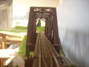

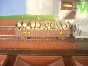

I used the camera today, and just guesses where it was aiming. Heres a shot of the bridge in place and the track on it. Also a new DMIR car I bought at a show today, along with a quick video of a string of hoppers after being loaded at Minntac.

Kevin,
That's looking much better, the bridge track makes it look 100% more realistic.
That pulpwood looks a bit too large for HO. Go with smaller twigs, but you're certianly on the right track.
Did you kitbash the pulpwood gon? It's awesome.
Here's more scale pulpwood: http://www.trainweb.org/lfnwfan/html/images/soopulp.jpg
(Ignore the terrible looking dents in the gondola though on the gon in the link)
