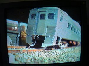

It ain't much ,but I took a pic of the video off the tele (yeah, digital pic, off the tele, a bit wonky)( but I assure you the pic is stable, not the wonky lines, like in the pic). I put that down to the digital cam "scan" rate difference between it and the tele.
And yep. Just a litle mock up I made trackside for a few pics and video, but you do need to have the track really clean, and the camera probabaly at least two flat car lengths away from the loco because of static and interference. The cleaner the track, the better, and I assure you, the actual pic does not have that "wonky bits" in it.
This is a pic off the tele, of a trackside shot. Not much, and the light was not that good, just the hallway floor, but still getting the hang of it. Adequate light is another essential, even though you still get a good pic in low light.

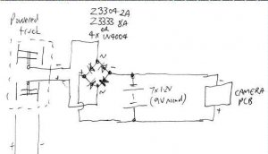

just remember-powered truck-bridge rectifier(gives you 1.2v drop across it)-true 9v nicad(7 x 1.2v cells)-camera
wish geocities still let you link :-( id draw a quick schematic
the old board i could upload a pic from my hdd-doesnt seem to be an option anymore???
hey can still do it :thumb:
edit-put a switch between the battery and the camera btw-saves running the battery flat when there is no power to track

I would still put a 50 cent LM7809 between the battery and camera, but you guys do as you wish. It's your magic smoke. :) FRED
