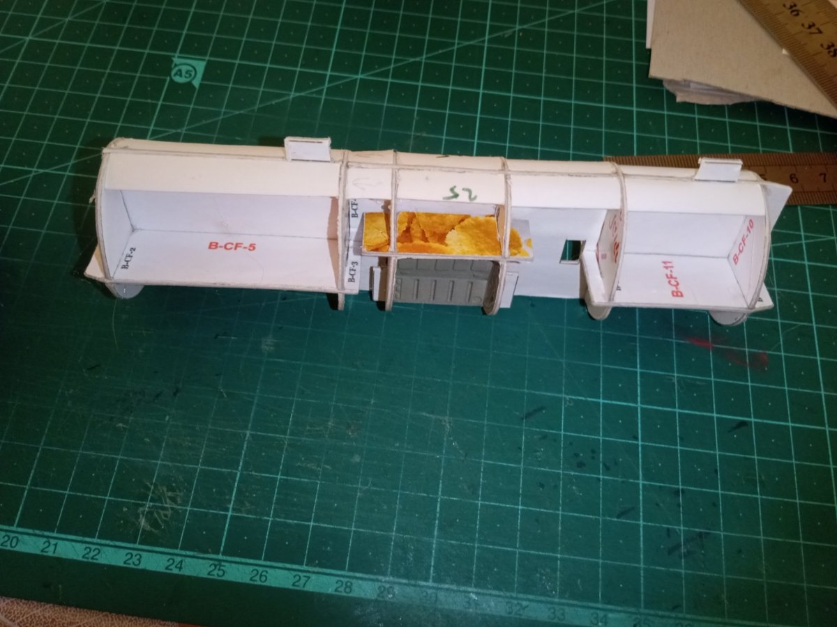

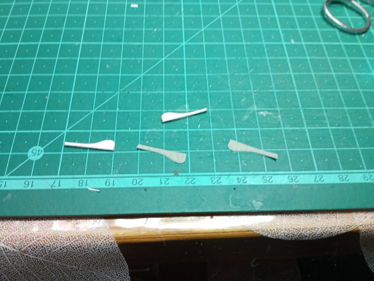

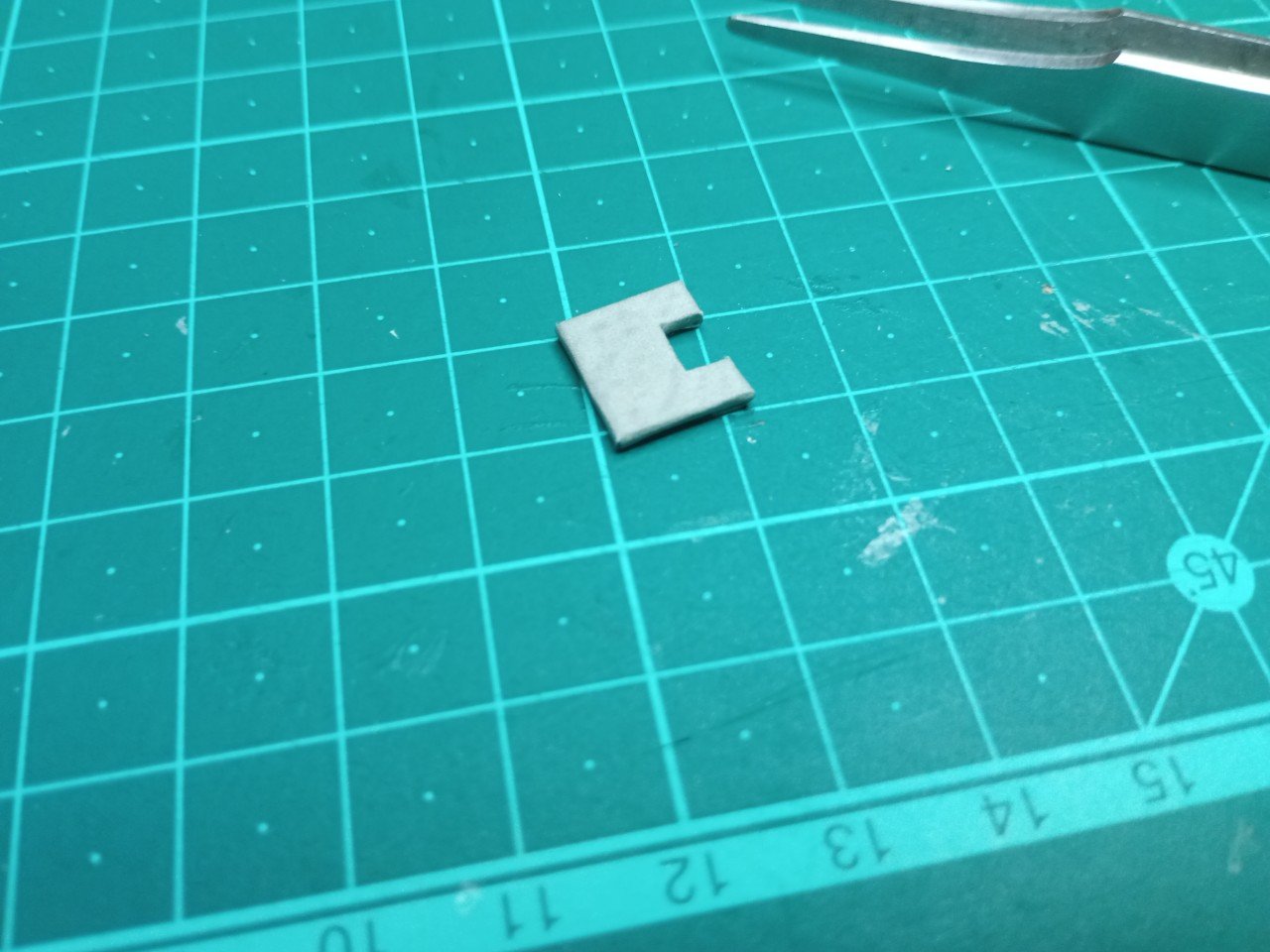

Hello all.
Some time ago a began a new model, this time the MiG-21-F13 designed by the late Andrew Inwald, AKA Kangaroo.
The model is in late Egyptian Air Force camouflage, green-tan on the upper surfaces, sky blue on the lower, meaning post-1968. The United Arab Republic roundels on the model place tis model in time frame of 1972, the latest.
The design is really detailed and the coloring is awesome with dirt and weathering. Some details are made using the emboss effect.

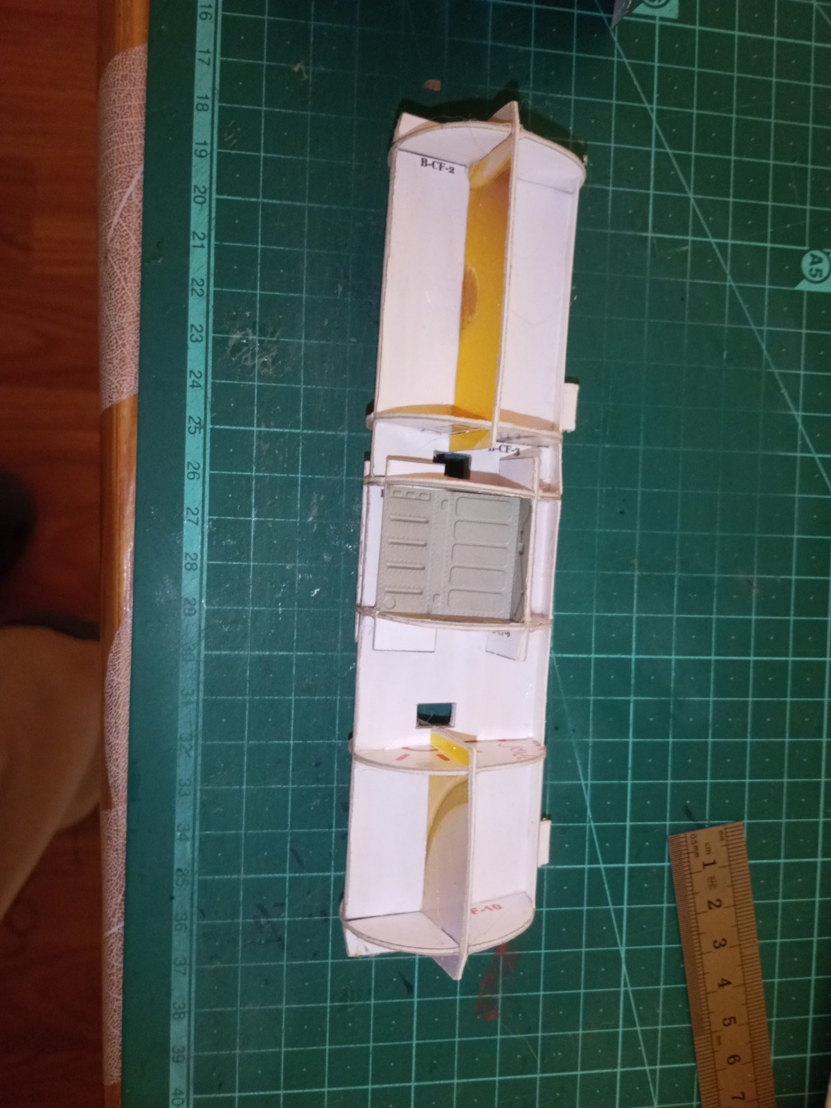

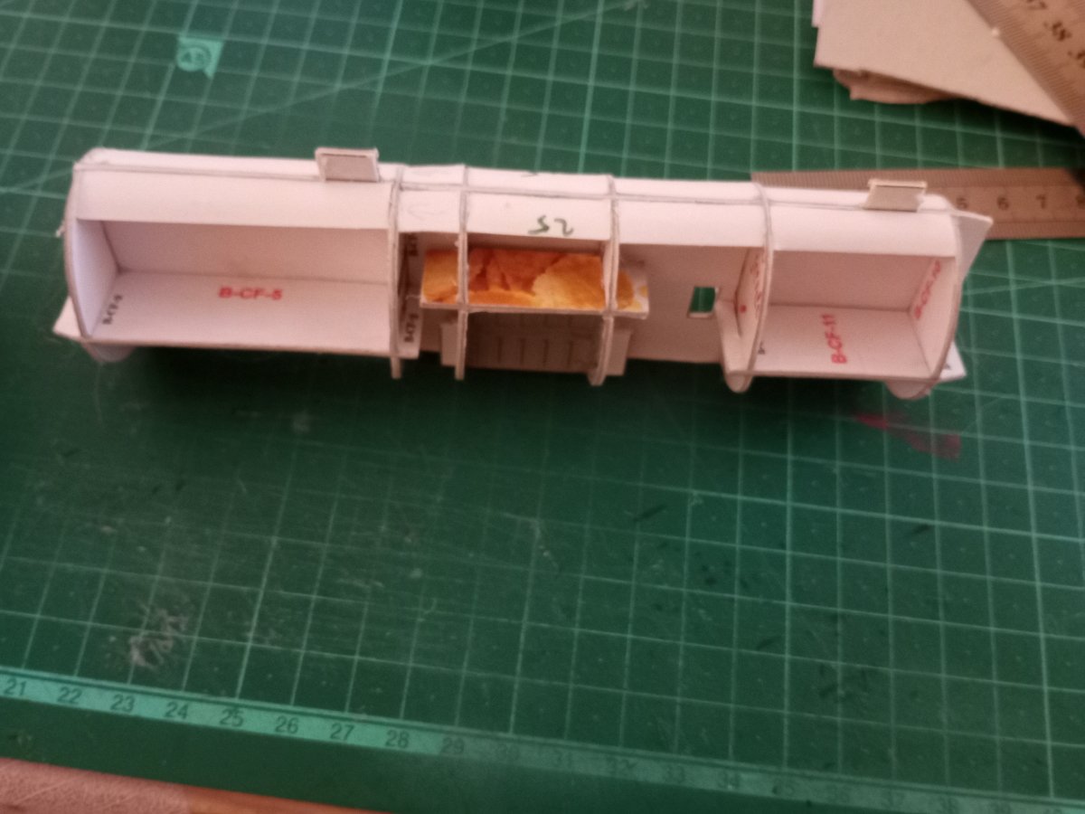

I don't like the decision of the designer to use the skeleton structure for the central part. The central part is pretty long and small in diameter, so it would be smarter to separate that part into three segments and to reinforce only the middle segment where the landing gears wells are located and through which the wing spars go. The other segments can be made short with former-glue tabs. That would simplify the construction....

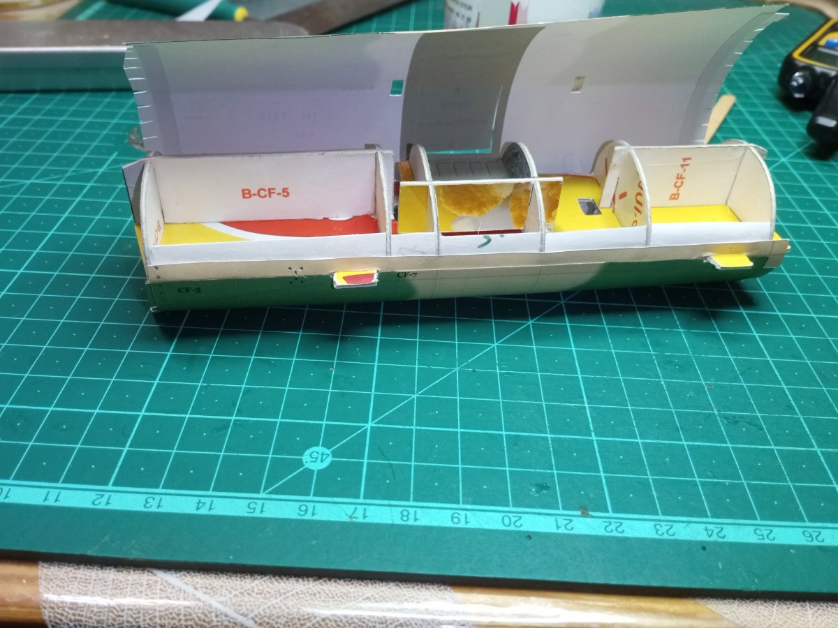

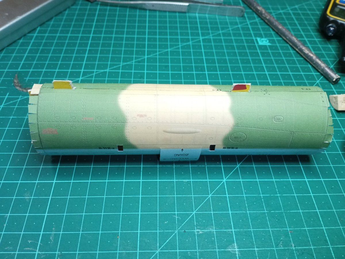

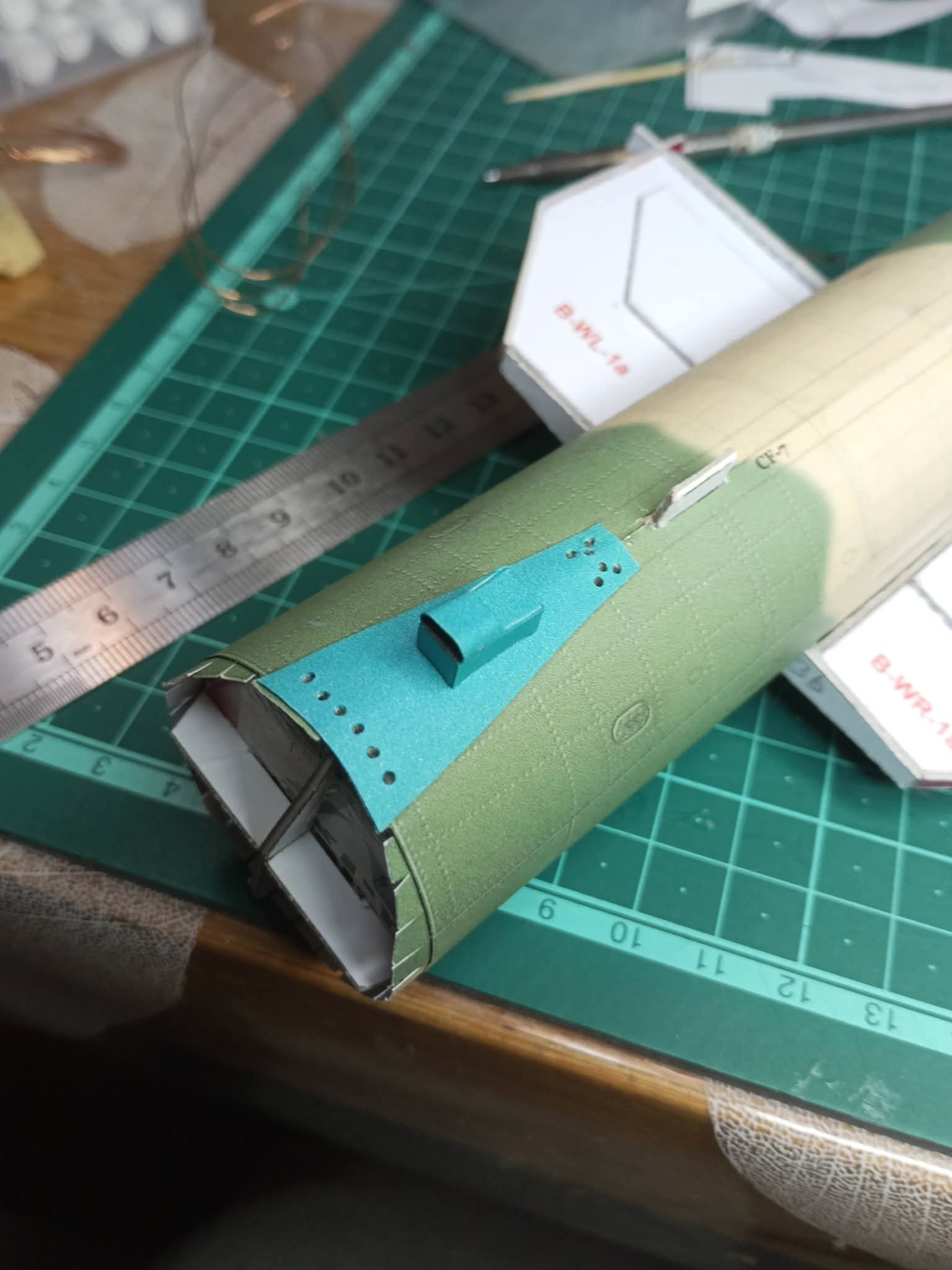

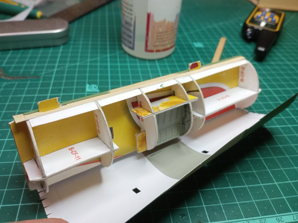

So,I began, as suggested, with the center part's skeleton. Nothing too difficult here. After assembly of the skeleton, it appeared to be a little wobbly from side to side, so I reinforced it with thin cardboard strips along the top centerline which also gave me a backplate on which the seam of the wrapping would rest. Also, the landing gears wells went in.
I made a mistake of connecting the connection tab in the longitude edge if the wrapping with old watery PVA white glue which made this edge very "wavy". Fixed it by gluing a strip of paper along the edge with UHU glue and pressing the edge between the metal rulers with clothes pins.
It took me more than 1hr to wrap the skeleton with its cover, apparently the skeleton got a bit banana-like from side to side. But the wrapping cover was glued to its place pretty well. I used small dots of the solvent based PVA glue (craft glue?) which dries extremely fast without warping the paper and thus not causing ribs protrusion.

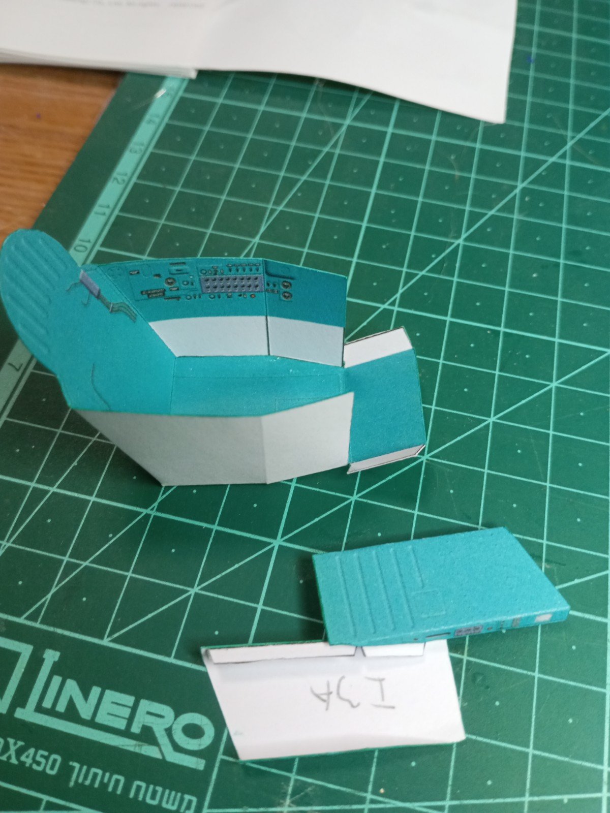

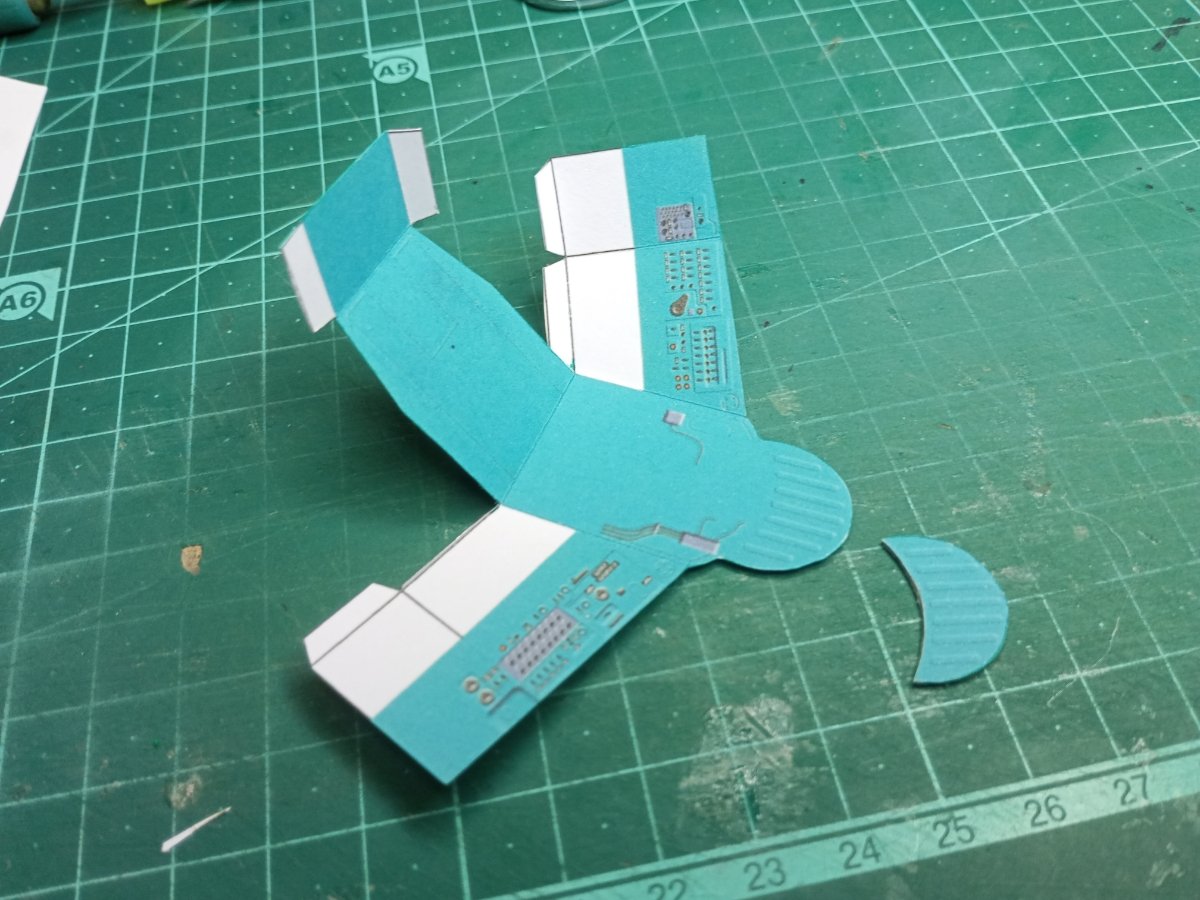

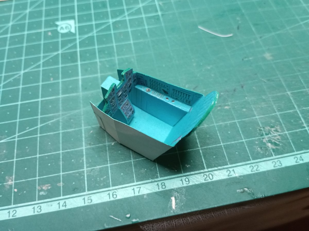

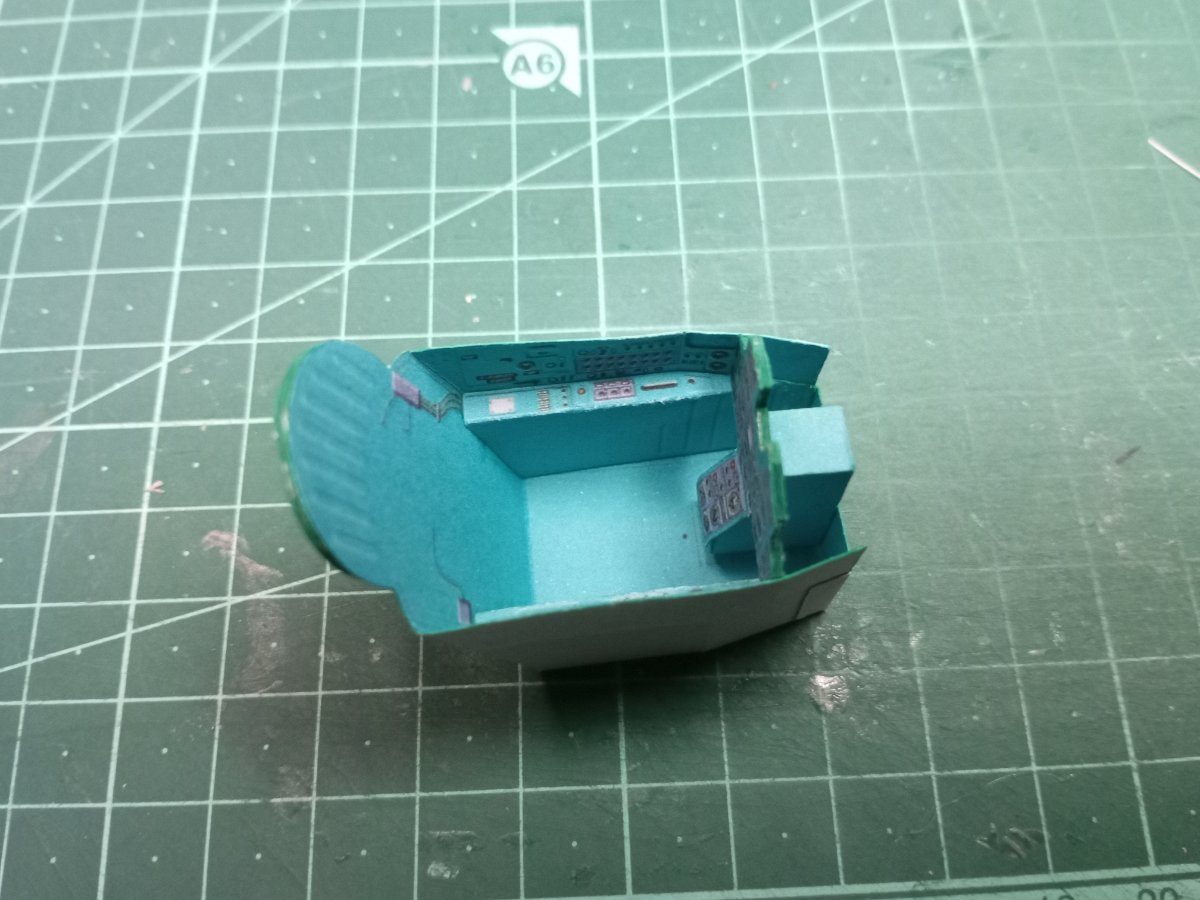

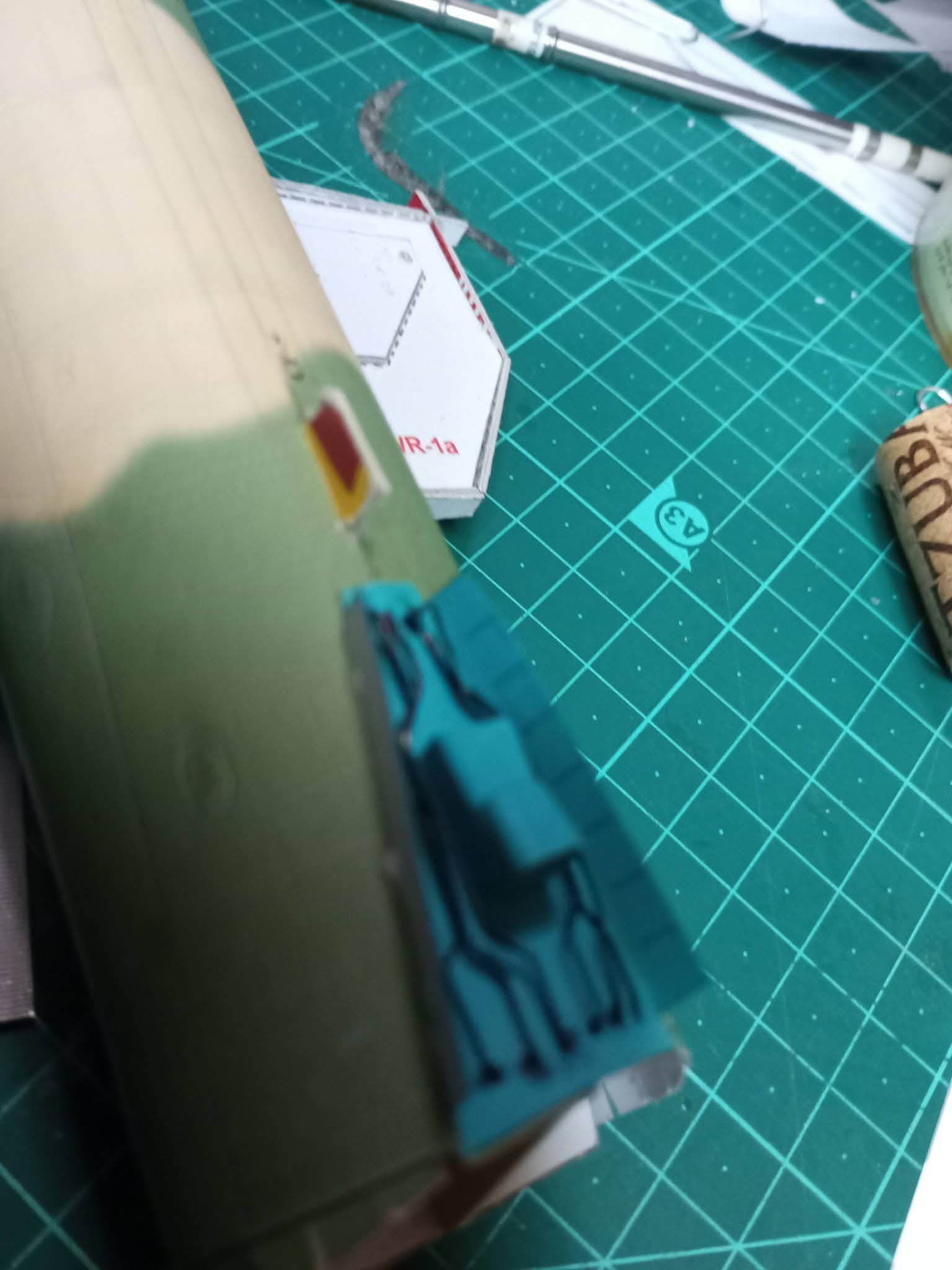

Later I began with the cockpit, nothing too difficult here, just regular carefulness should be taken.

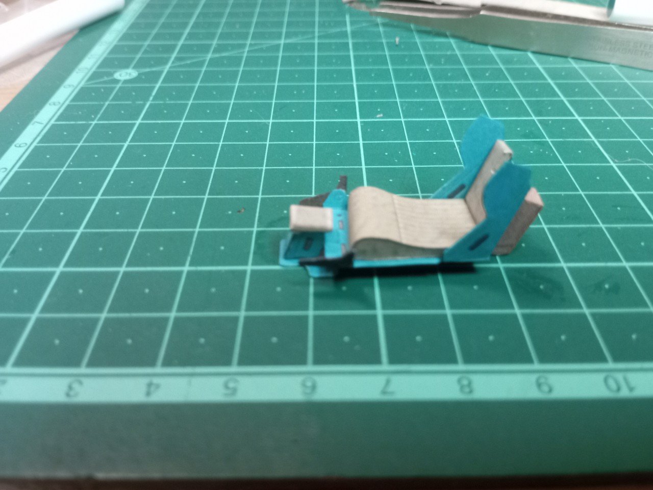

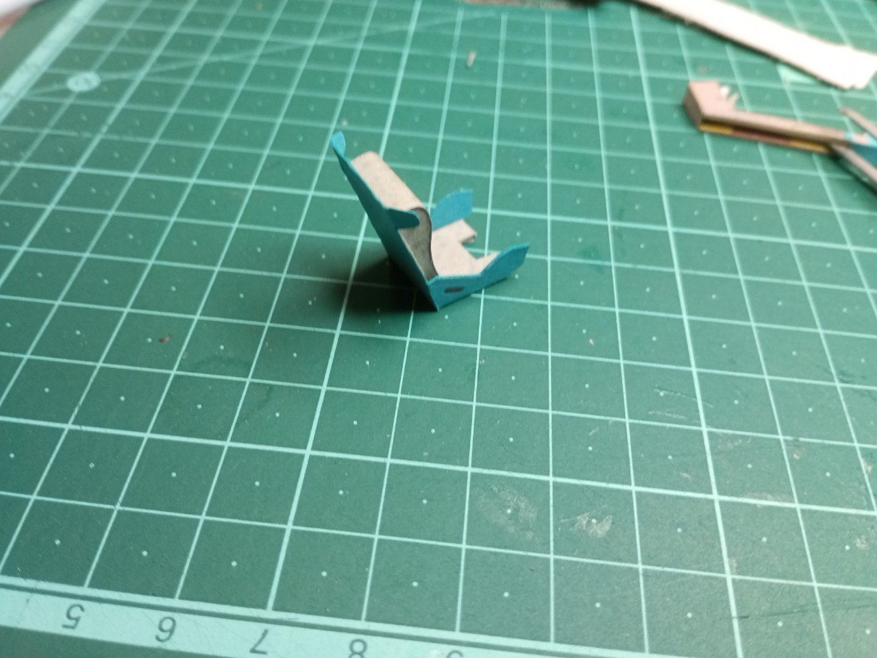

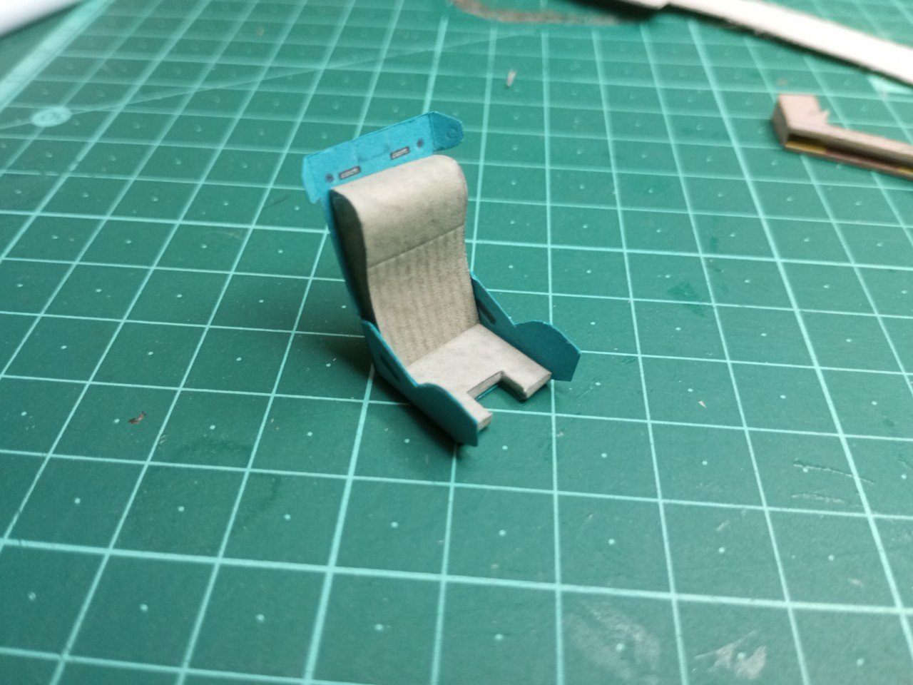

After the cockpit tub was finished, I cut out some parts of the pilot's seat, which is very detailed, too bad half of it will not be seen with closed canopy.
Despite the fact that instructions are made using a number of photos of the part under construction, not everything is clear how to make the part. It's bearable, not great.
Cardboard used is the morning cereals box, some single use cardboard pizza trays were also used. The paper is 145 g/m2, probably too thin, but makes easier to form small parts and there are a few.
Enjoy some pictures

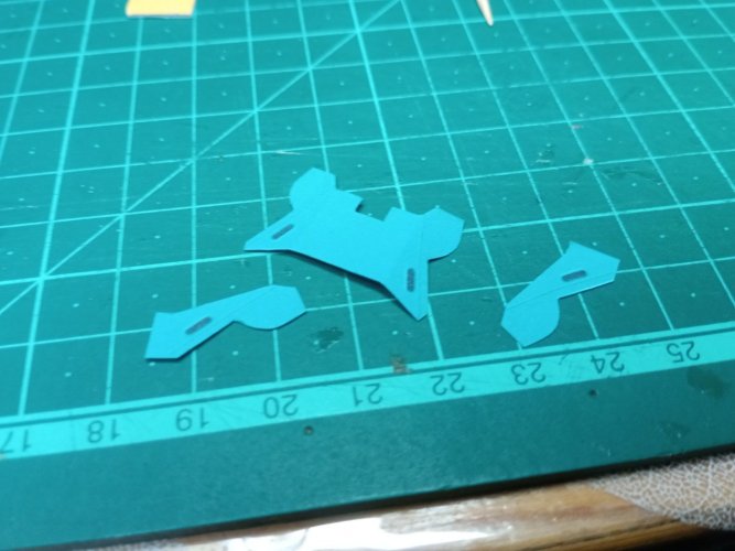

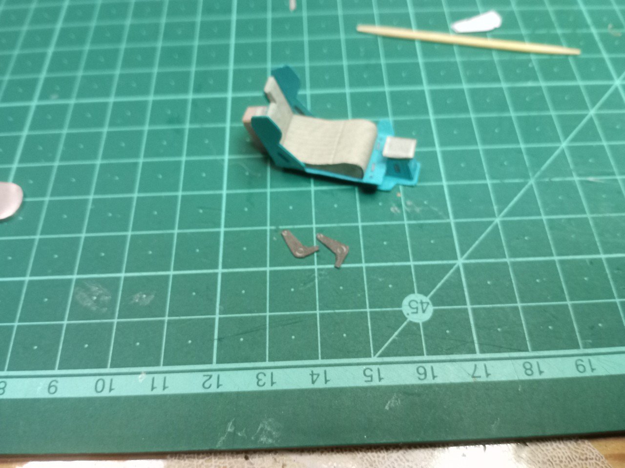

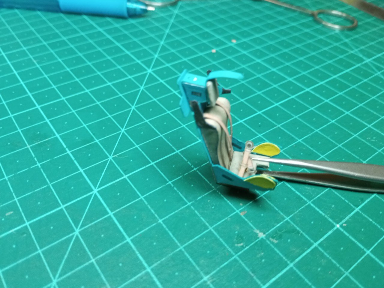

Hello all

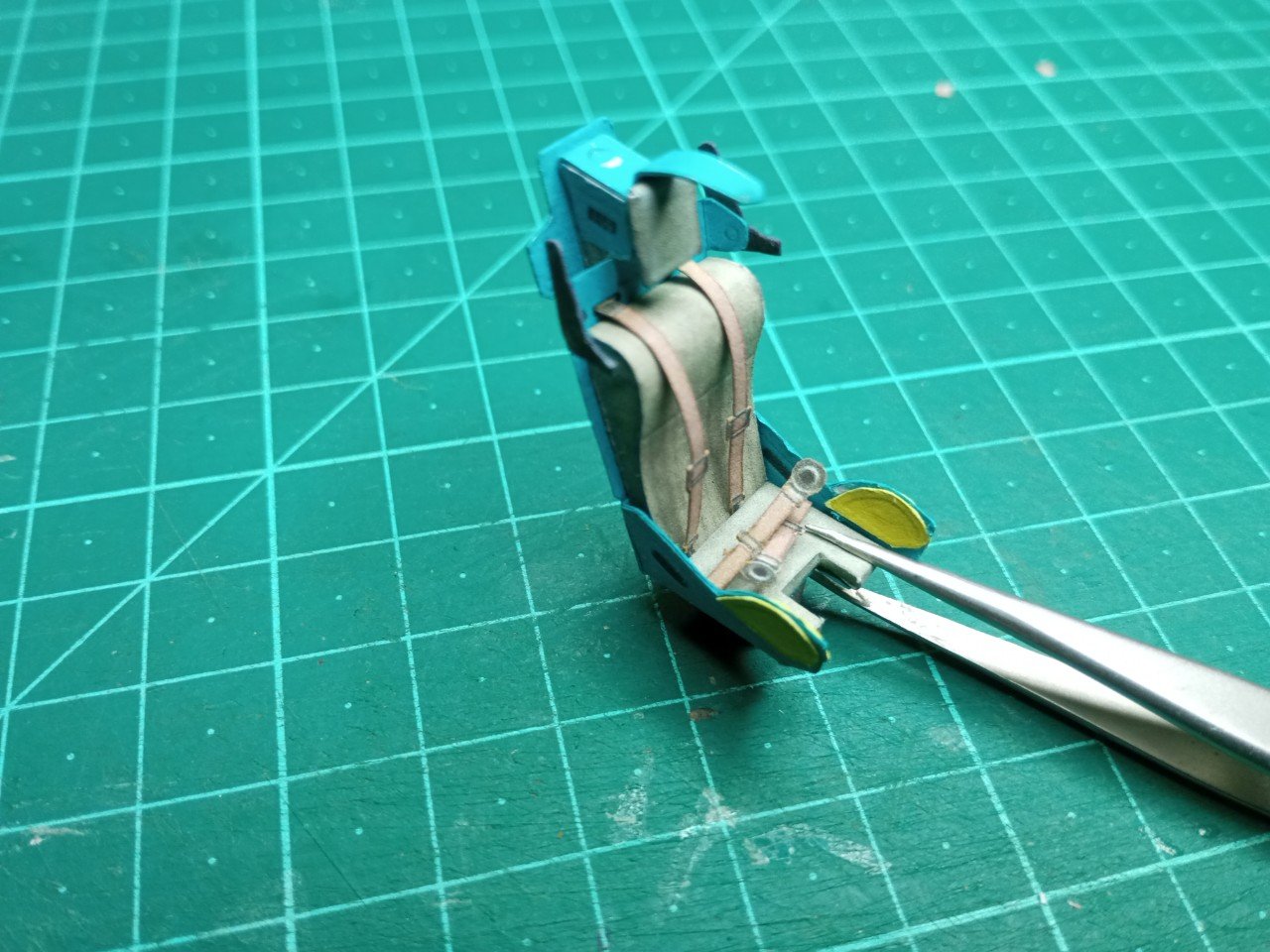

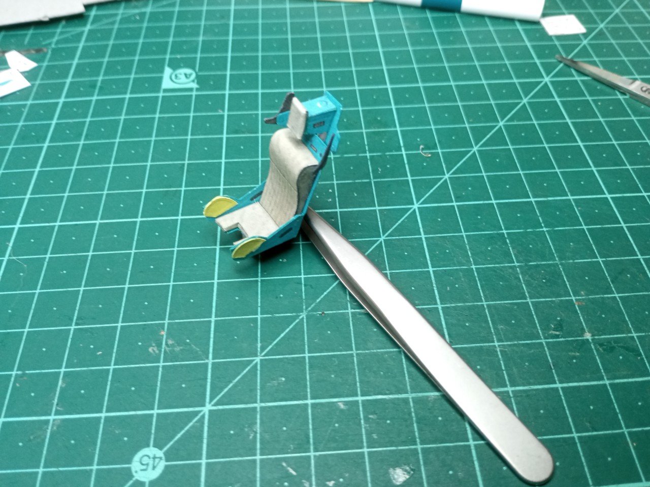

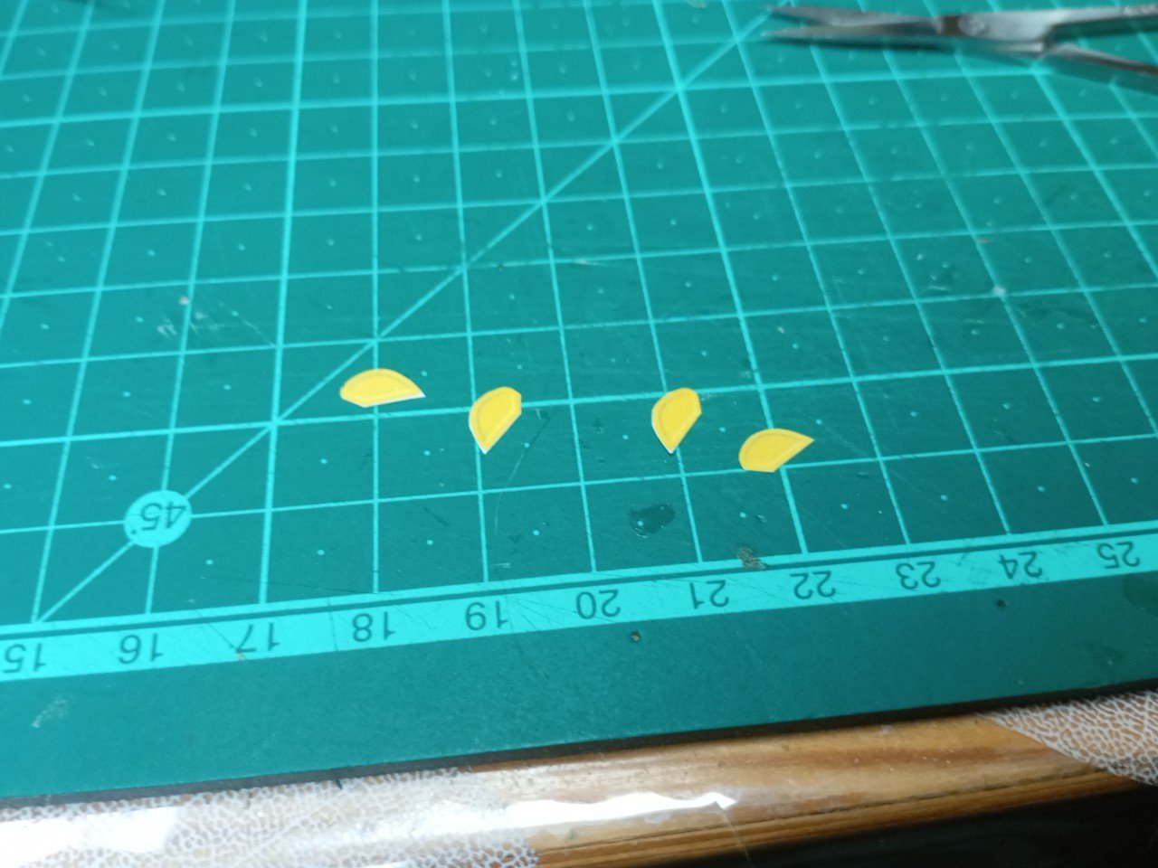

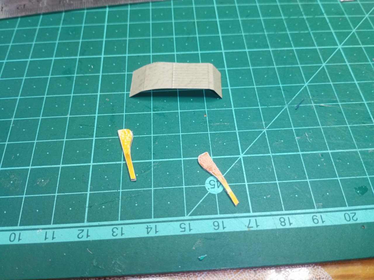

Last time I began with ejection seat, this time I finished it.
Very good parts fit, pretty close to real thing, great instructions, not too many overcomplicated things here. Nothing too difficult here.
But I understood that the seat should have been made only at the time of canopy mount, so that I could be sure on a hight of the seat mount and the gap between the ejection rails and the rear wall of the cockpit. So, the seat goes into plastic box, for storage.
My suggestion would be not to build the seat immediately after the cockpit, build it towards canopy installation.
Enjoy some pictures

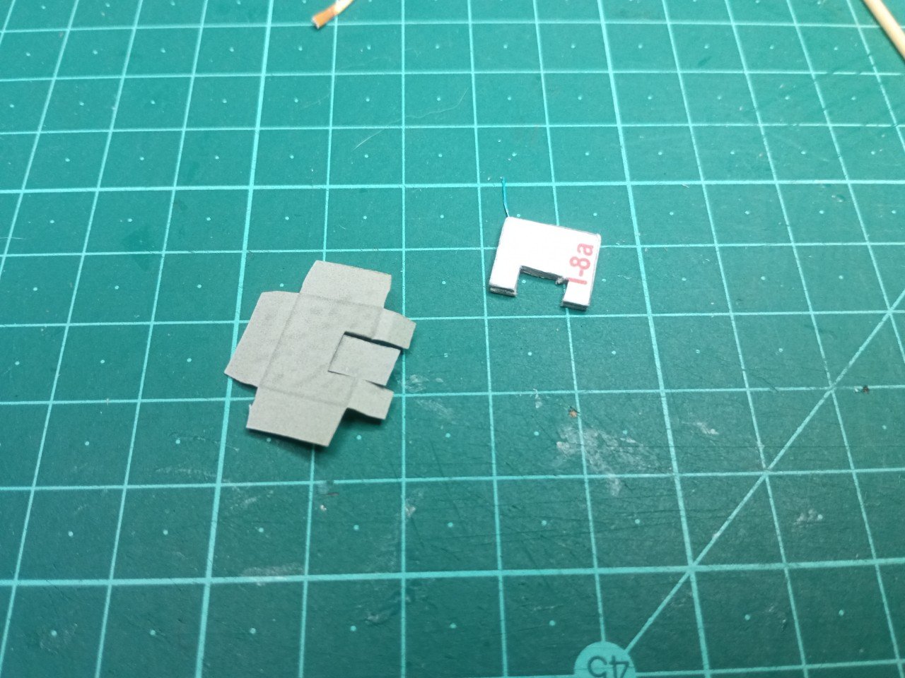

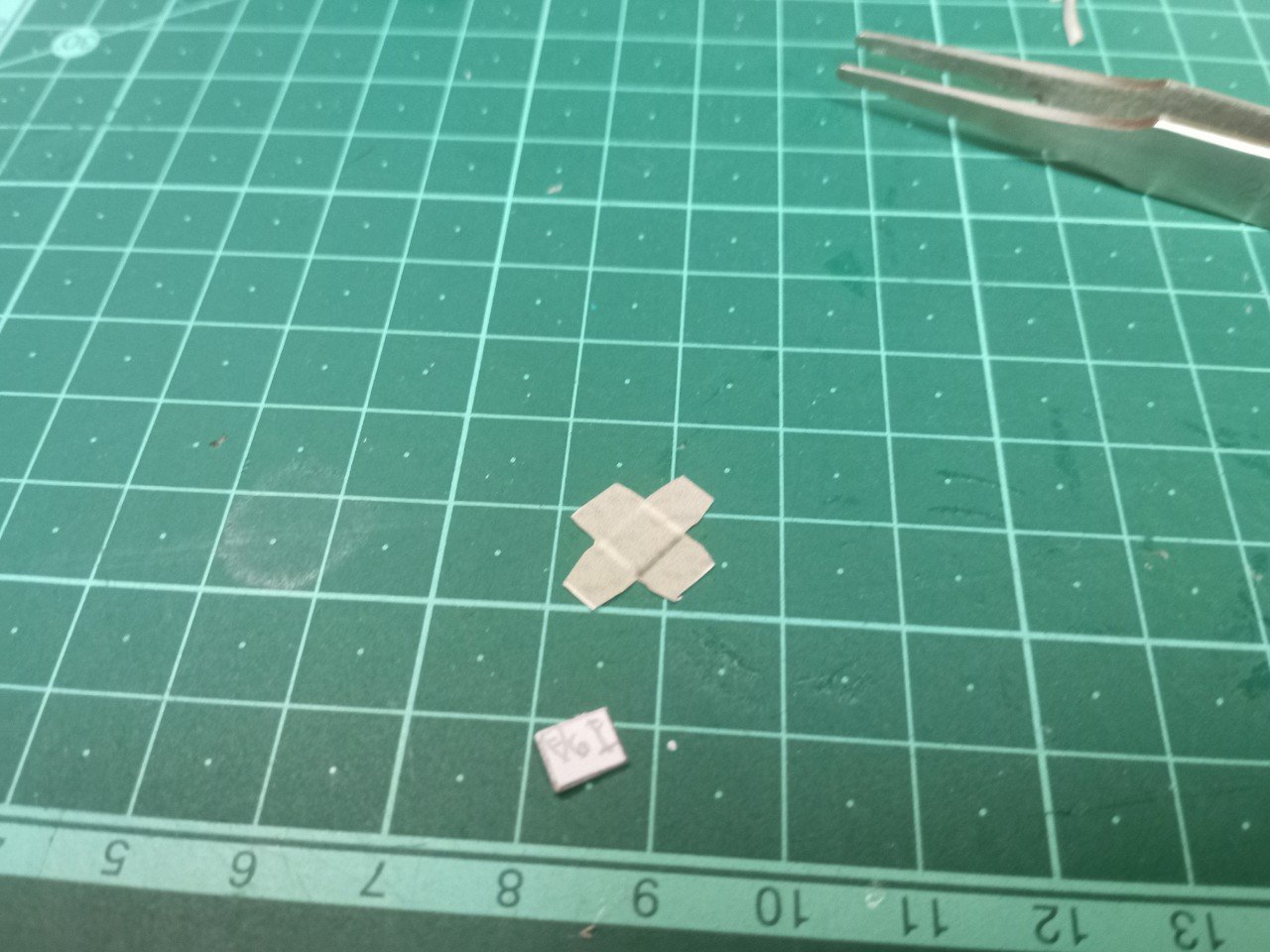

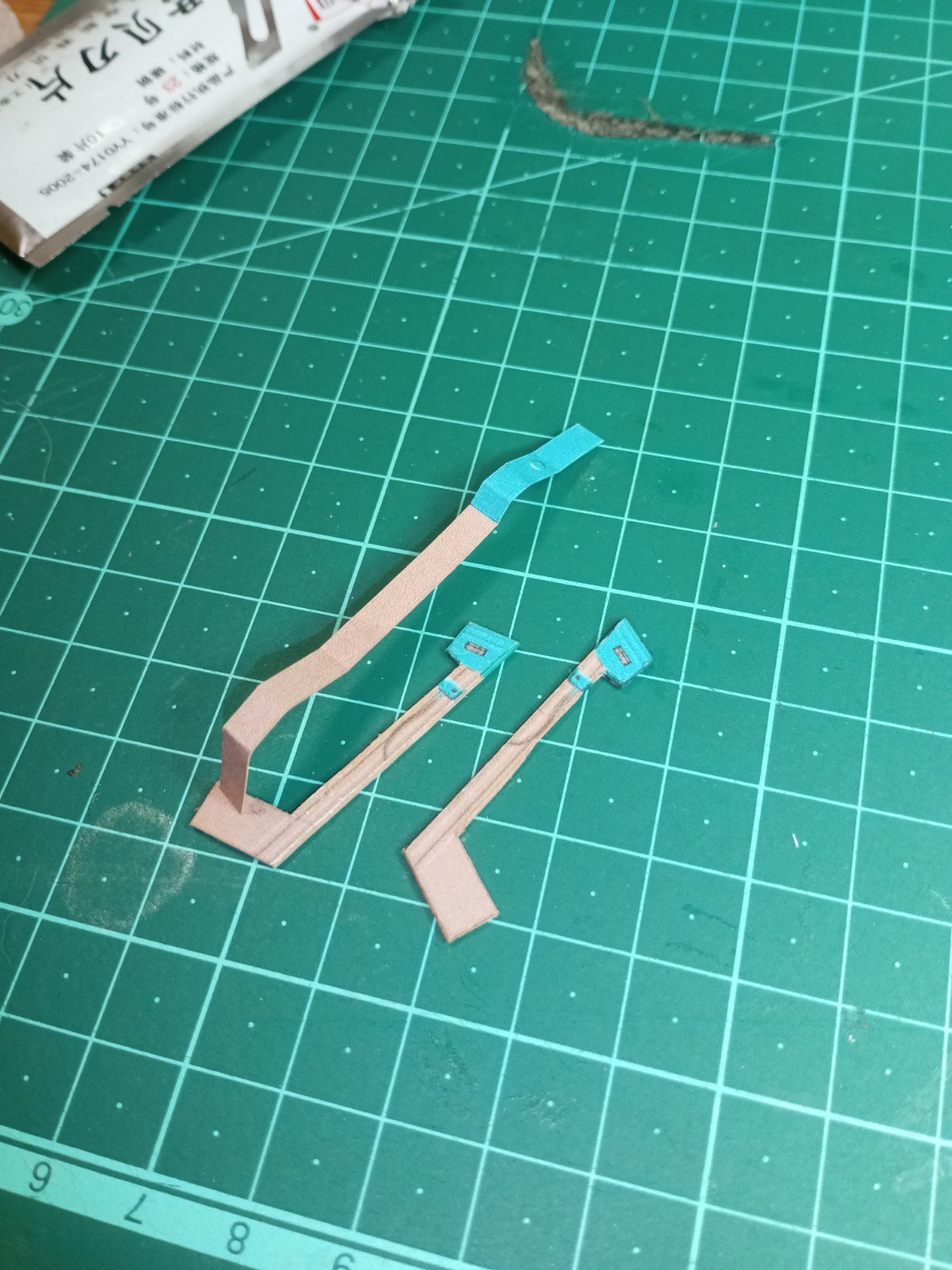

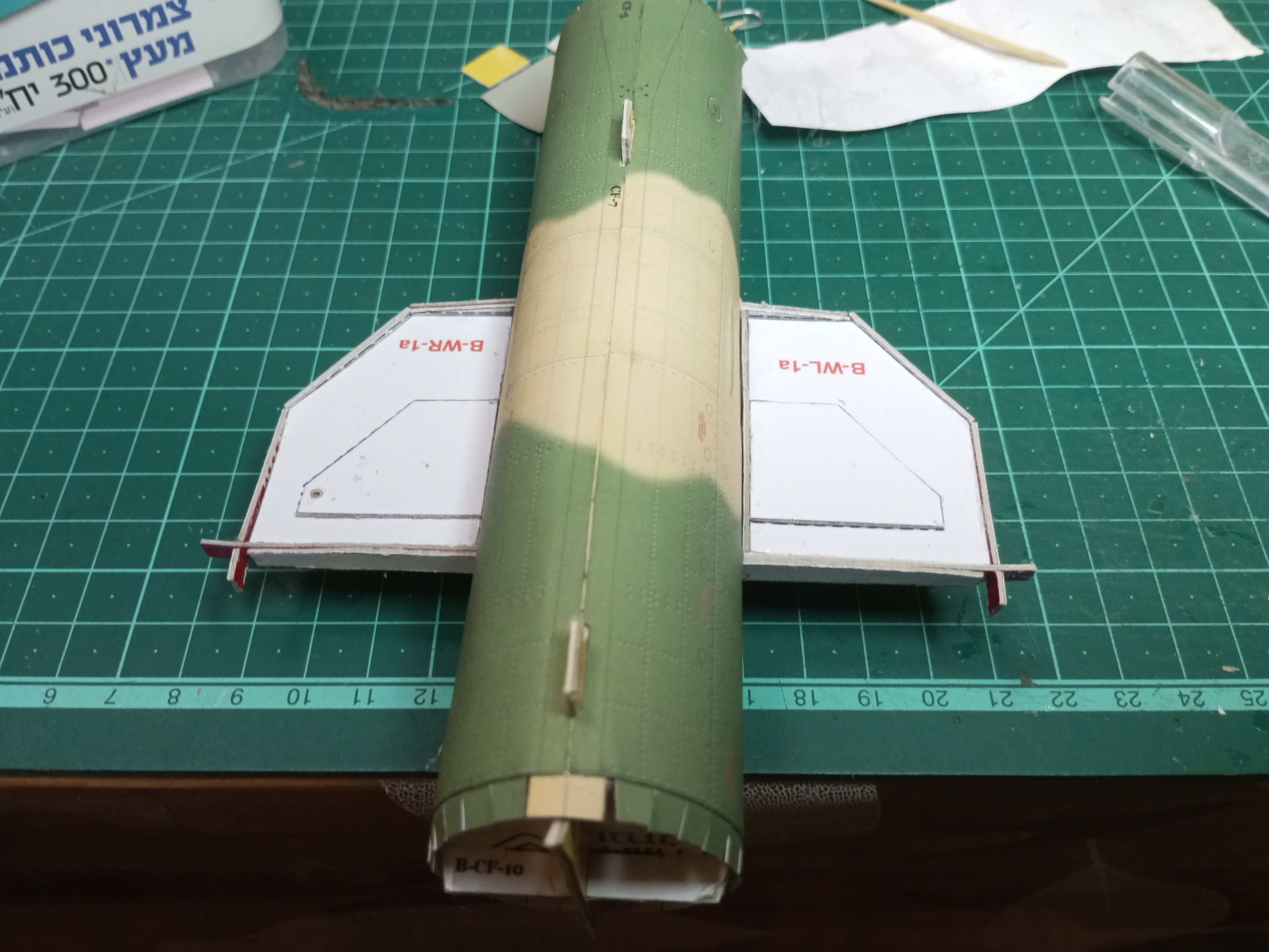

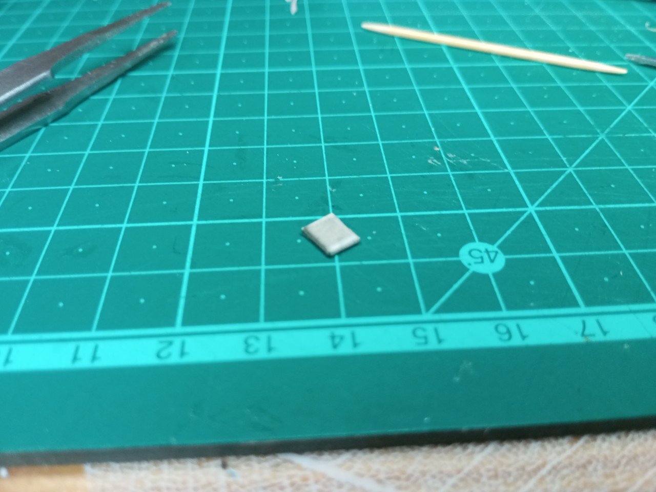

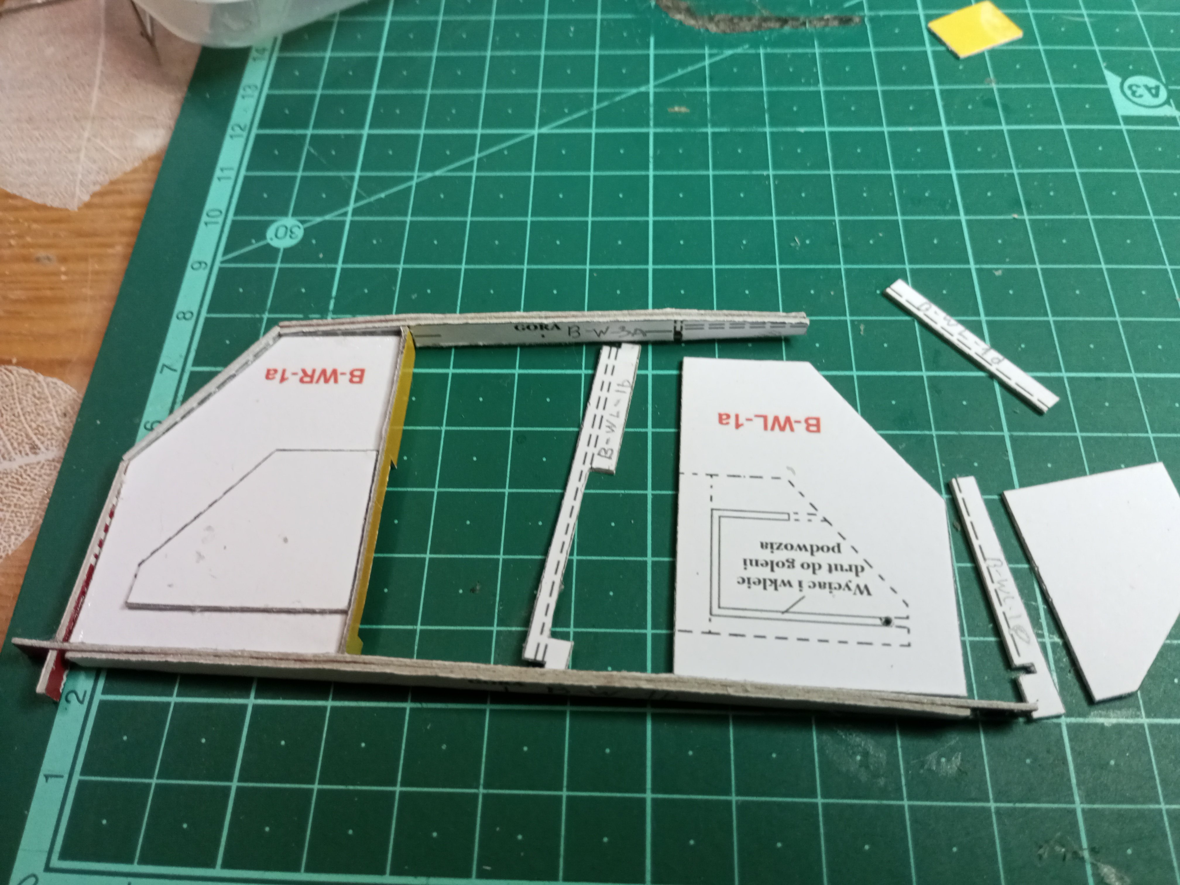

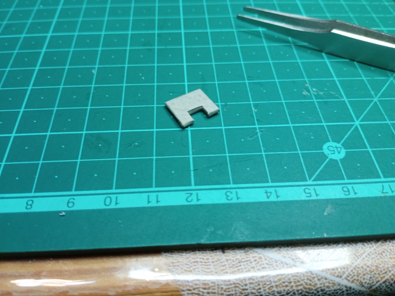

Hello all

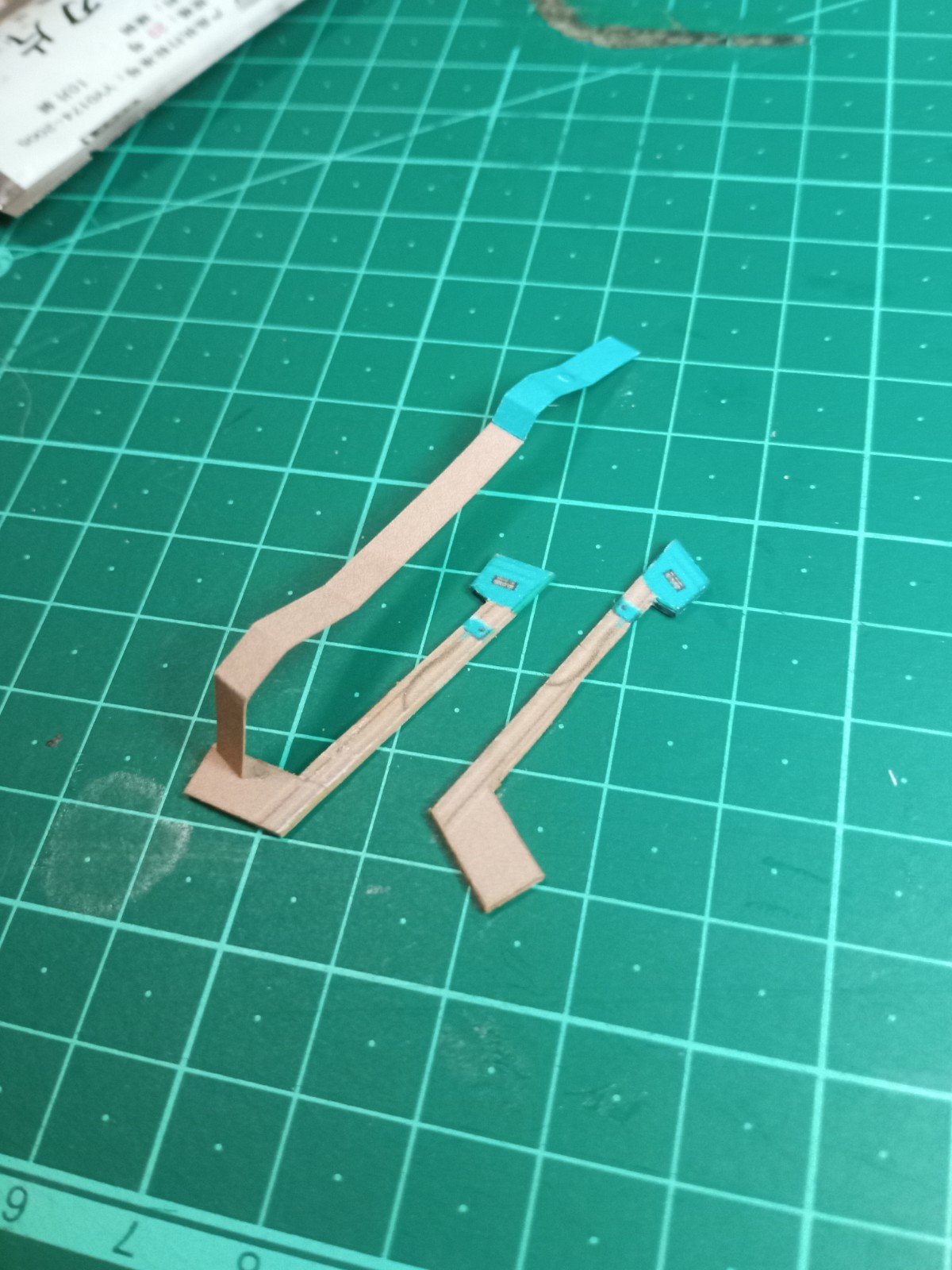

One small update. I finished with main landing gear housing structure, nothing serious here. Only two things made me scratch my head. The markings are slightly incorrect, left side sould go to the right. Also, vertical parts i.e. the ribs should have their black contour line removed to fit into wing contour lines on the fuselage, but the horizontal part, the straight angle trapezoid, should be left with contour lines untouched, otherwise there will be gaps between the ribs and the trapezoid.
Also, the landing gear struts structure, is shown incorrectly, the wheel axle is bent to the wrong direction. Also, mounting this structure means that the strut wrapping should be done while the strut is mounted on the plan, making it unnecessary difficult. So I will remove the base of the structure, build the strut and install in into landing gear bay.
See pictures below, original strut structure is shown with axel on top, lower base will be removed

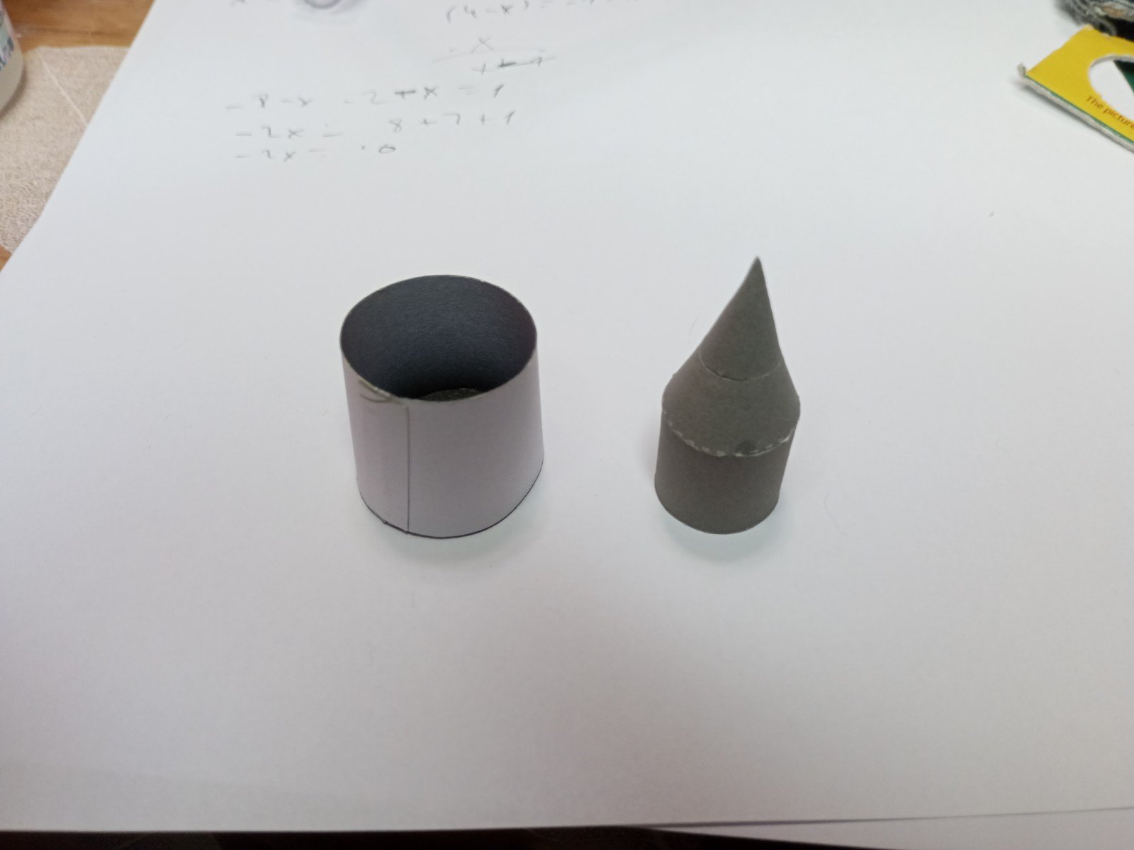

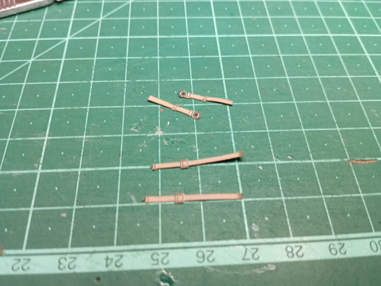

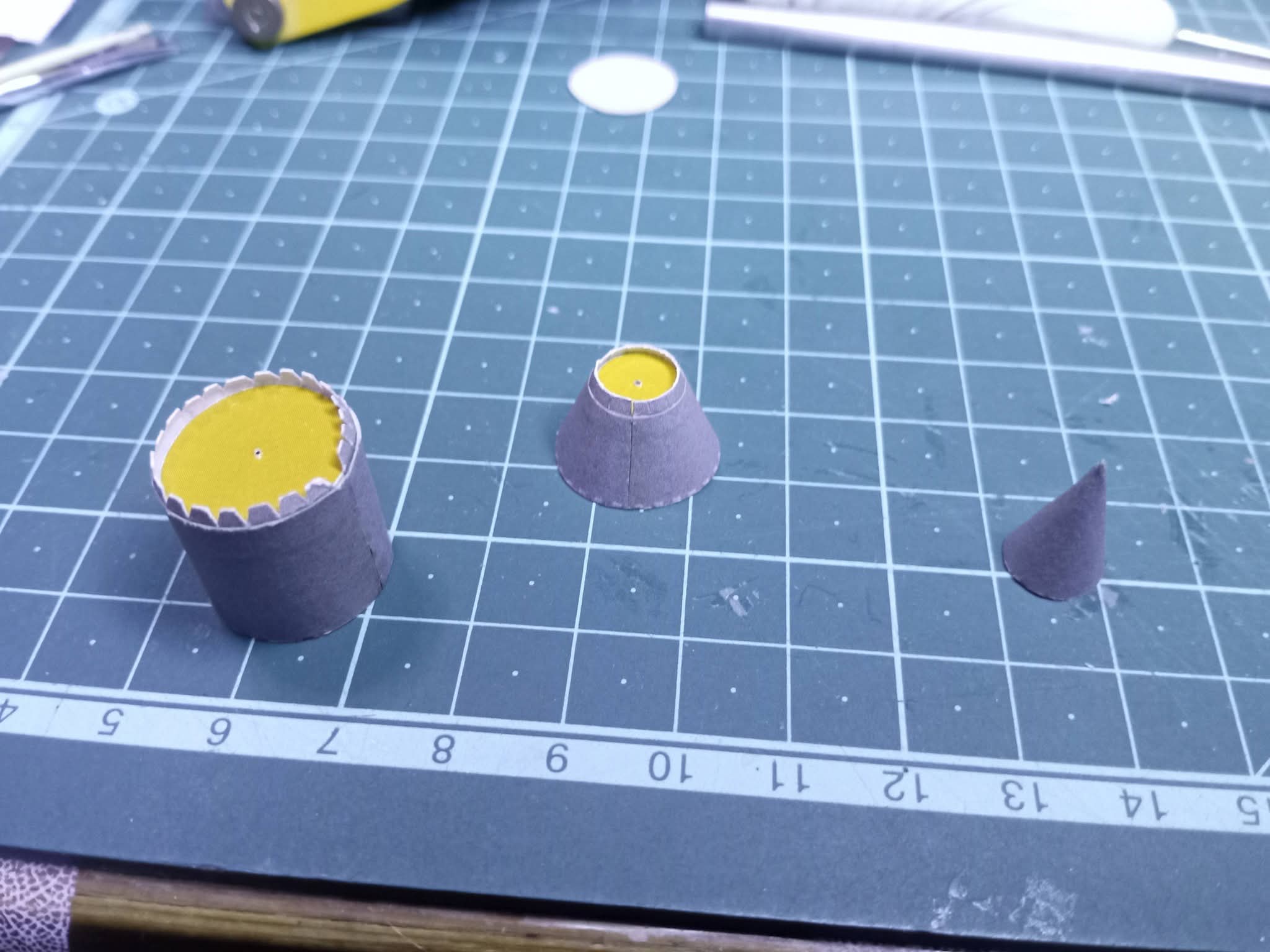

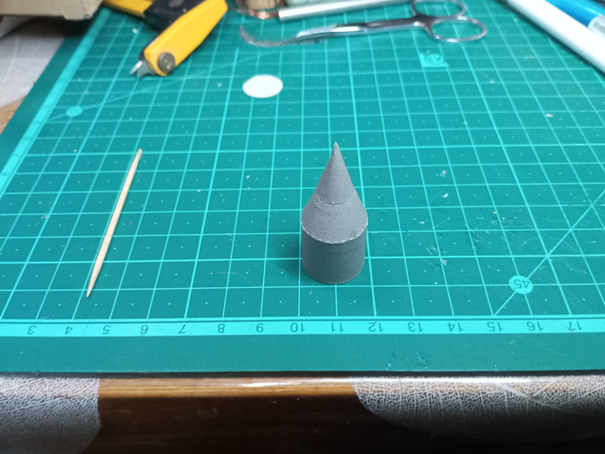

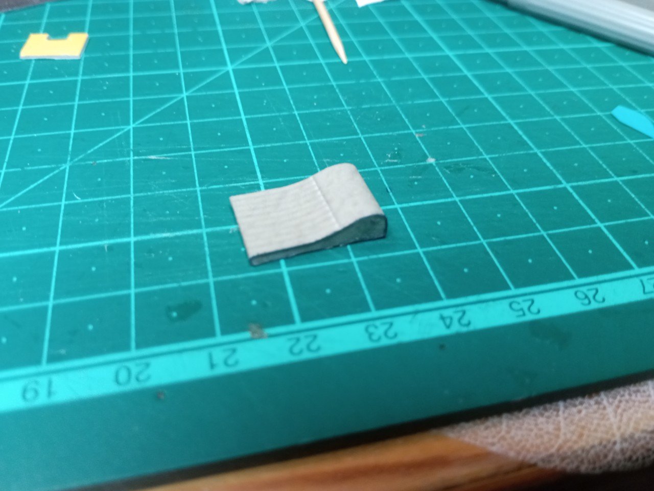

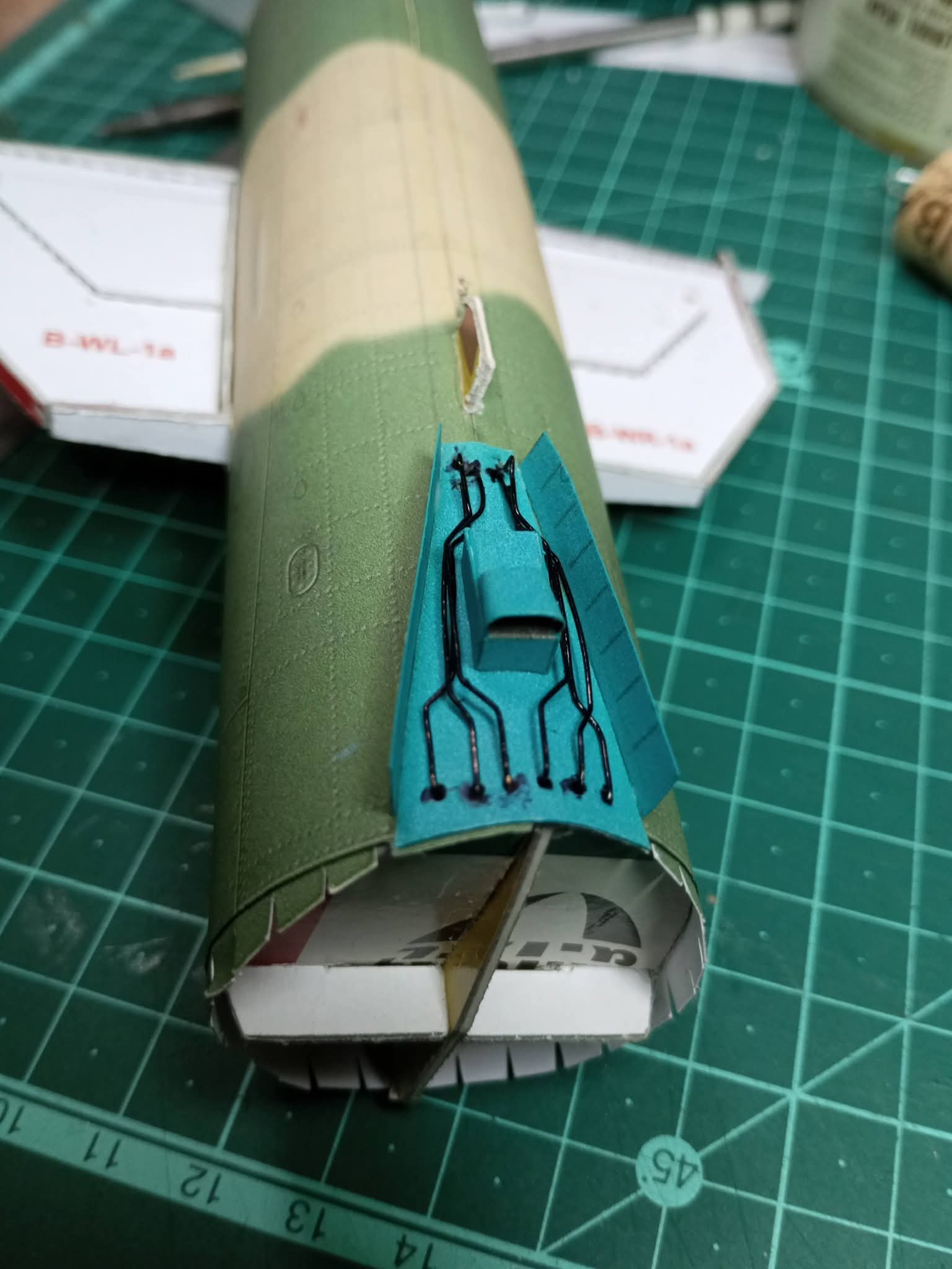

Hello all
Even biggest of works is done in small steps.
So a small update.

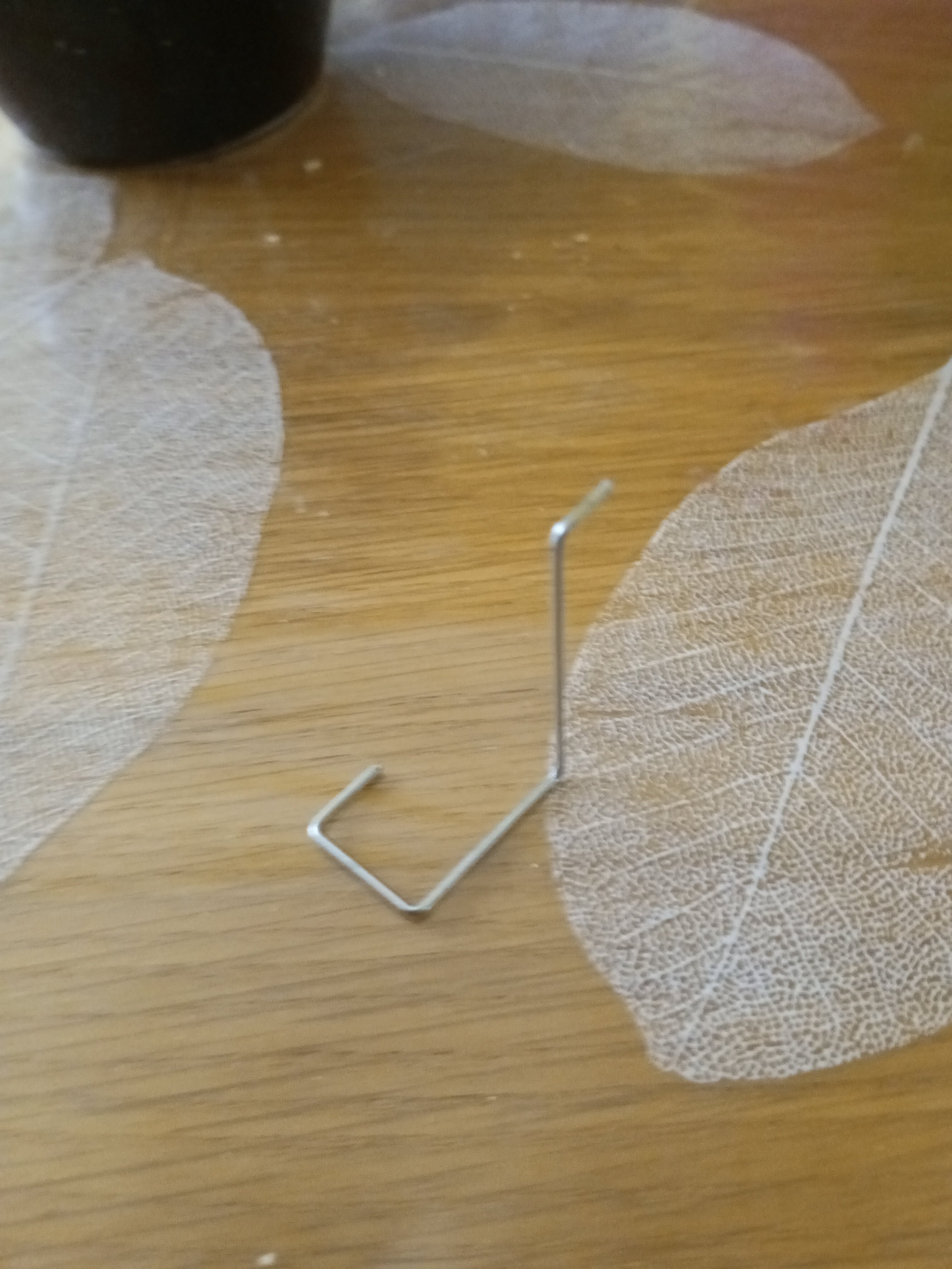

I finished with a set of wiring or tubing behind the ejection seat, I used a copper wire 0.3mm in diameter, bent as described.

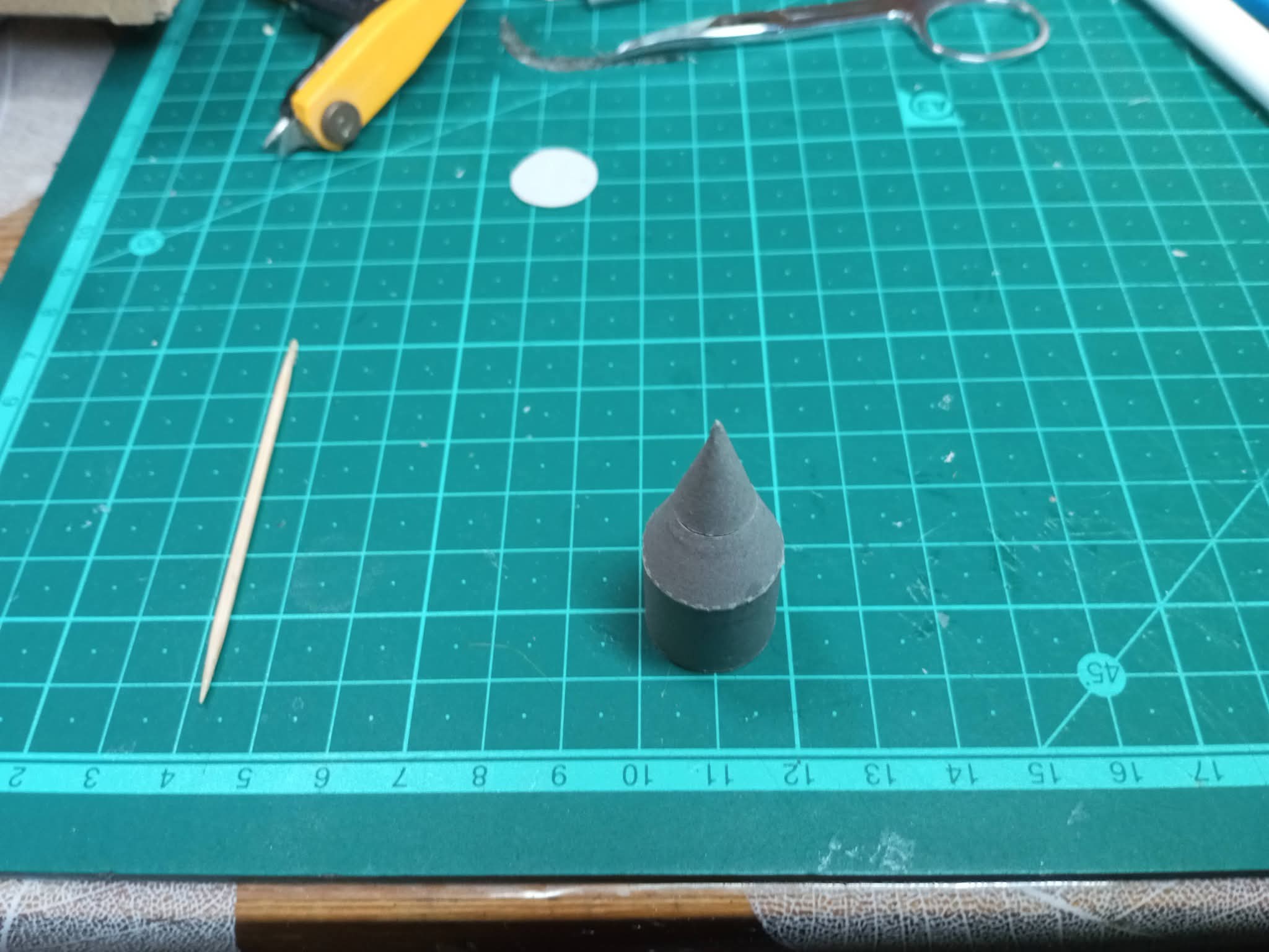

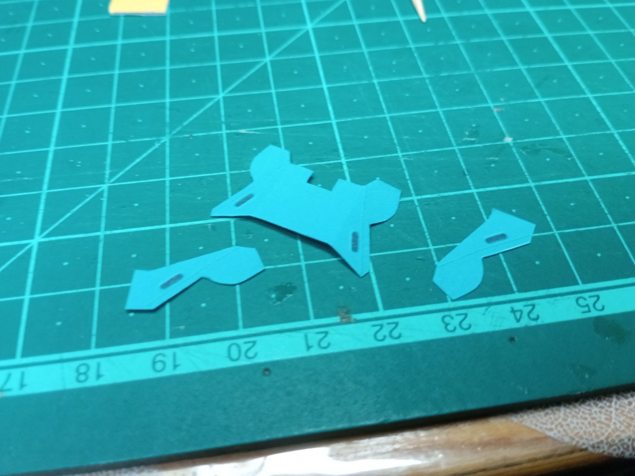

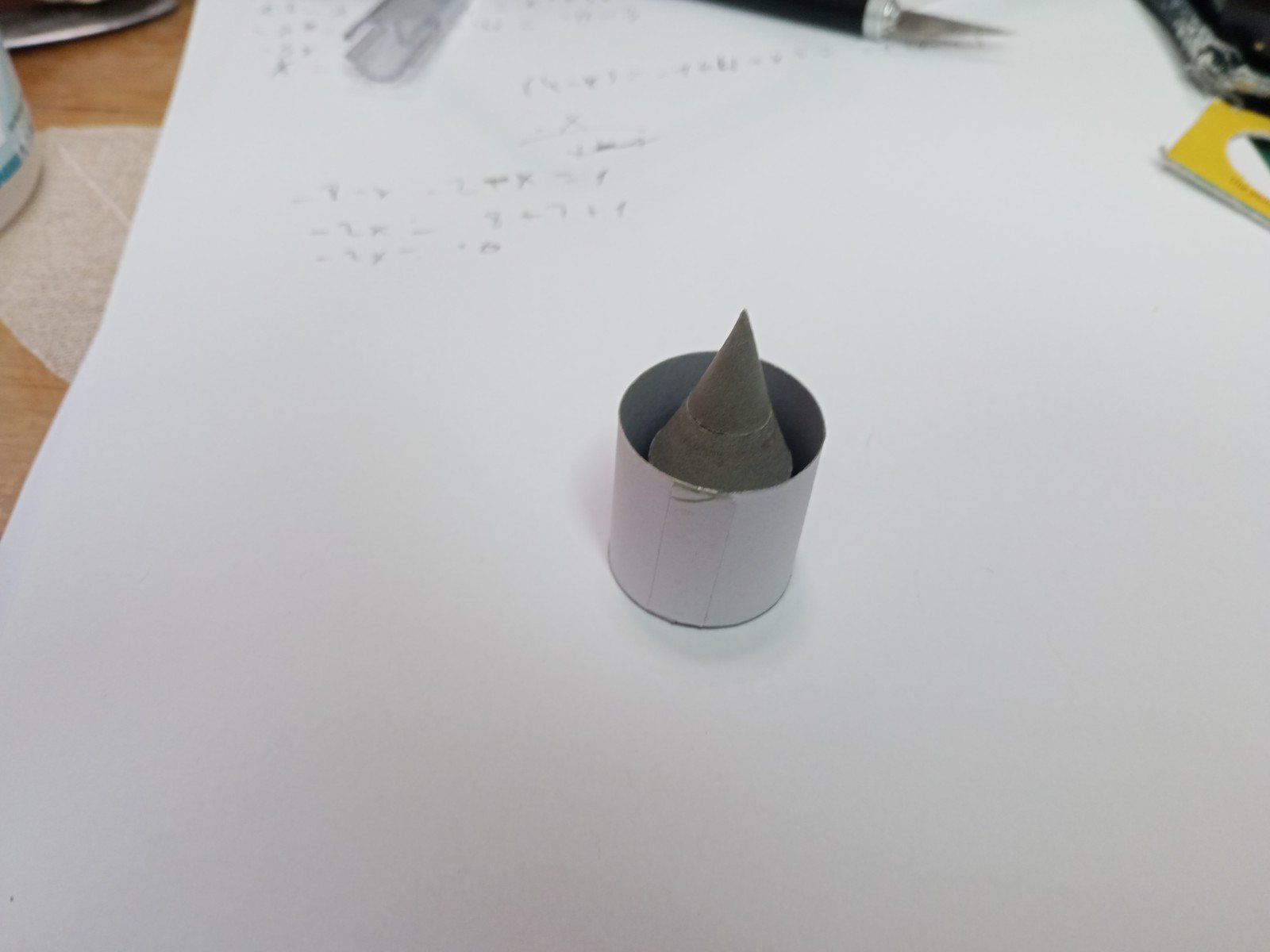

Then I started with one of the most iconic parts of this plane - the inlet cone or the inlet cone's center body as it is called in MiG's documentation.
Nothing too difficult here, need to know how to close small cones. I added one more former for the second cone part, I felt it was needed.
Also I made the inlet itself. Its base is oval in shape with longer axis running vertically.
More updates soon
