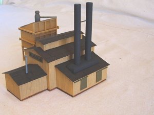

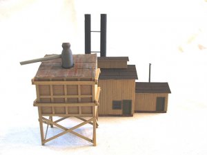

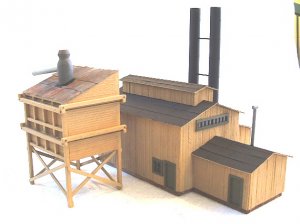

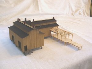

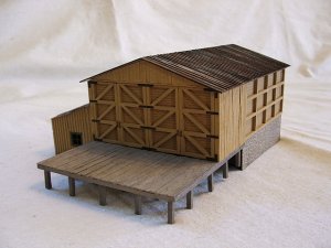

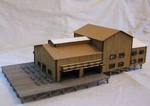

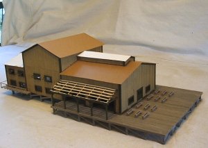

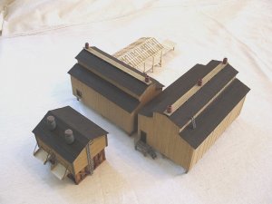

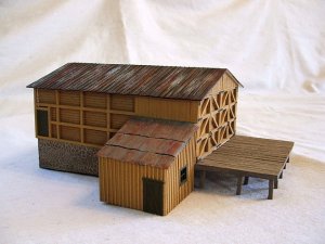

Welcome to one of my most recent endeavors.I am new to this forum & have been enjoying it. I'm sorry for not having any raw pics. I started this project back in the summer & have been really busy this winter working on it because of business being slow.Recently having 10" of snow outside, don't have to work, bills paid, plenty of coffee, & trains now how much better can it get! Most buildings are started from poster board & are entirely scratch built from poplar & cedar. I still have a lot of work to do. My next step is to assemble these buildings & get an idea of the ground levels so I can start on the pond area.I basically took some ideas of several Mills I liked & here it is. Hope you enjoy!

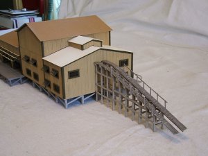

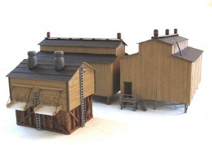

More Pics Of Maple Valley Saw Mill
Does that mean cardboard structures covered in wood siding?
I find my eye drawn to the doors with heavy diagonal bracing, and the... uh... drawbridges on the... uh...
I can tell it's good, but I'm not familiar with what a real industrial structure of this era looked like.
Hey Triplex thanks for responding. The main structure of most buildings are the foam board that you can get from most craft stores. I cut the sides of the buildings out of this & cover the walls with individual scaled boards with Titebond II wood glue. I then cut my windows & door openings out cutting through the entire wall. Most of my doors & windows are scratch built as well. I aquired a lot of windows very cheap from a local swap meet in my home town. Most of these windows are commercial but I cut the panes out & scratch build the frames & trim according to my needs. The open structure is part of a tram that will have a track with wagons to move rough sawn lumber to the Planing Sheds & Drying Kiln. There will also be other tram areas that will connect to all this. Any other ? feel free to contact. Thanks

What's the "tin roofing" from????
Thanks Silfoldalot for the comments. The tin roof material is heavey duty aluminum foil cut into scaled strips & pulled between two 5/16" fine threaded bolts. The trick to this for me is actually cutting the foil without tearing or peeling the edges. I believe a paper cutter would be good for a short while until the blades got dull. I do get some scrap but I get enough to do small roofs. I do have a jig in the making using two knurled wheels but haven't been able to get a machinist to turn the wheels for me because it would be such a small job for them versus setup time. I weather the metal roof tops with water based acrylics that you can get at craft stores. The colors I use for the first coat is Apple Barrel brand Pewter Grey. I then dry brush the roof with Americana brand Burnt Sienna for the rust effect. Thanks again !

I too love the buildings!!! Like Bill I am a big user of foam core for modeling buildings. It is an excellent medium to work with. I really like your models, particularly what looks like to me to be a drying kiln.

Jim,
There was something that bugged me about your main sawmill building, but I couldn't put my finger on it.
I rerurned to it several times, without figuring it out. and I finally figured out, there isn't a hole A the top of the Jackslip for the log to go into the building.
did you plan it that way? that is a problematic spot for all saw mills that don't have interior detailing, and an especial problem for ones like ours which have foamcore walls. I framed the hole on mine with lumber, before I planked the outside, so the foam doesn't show, but the wall is thicker than it should be. I have a set of Keystone locomotive works sawmill machinery for mine, but that opens up a whole nother can of worms.
Your sawmill looks to my eye like one that was based on an actual prototype. Mine is a hodgepodge, I drew sketches of photos of mills I thought were interesting, and tried to encorporate elements of several into something that fit my space, which wasn't quite as wide as I needed. Much later as I was trying to plan fit of the bandsaw I realized I had incorporated features of single band saw mills, and double band saw mills, so my mill has a split personality. That , and the fact that I didn't design in a saw filer's loft drive me crazy.
I think I'm going to set mine up as a single band saw mill, and once I know where the bandsaw is going, I might study my roof, and see if I could git a loft up there. the loft would be a cool feature, as the roof would be mostly skylights, so interior detailing would show well. fortunately my sawmill is removeable, so it can make the trip to the workbench with only a half hour needed to remove or reinstall it.

Yes there will be an opening. I find it easier to plank over the whole wall then make cutouts through the planks & foam core wall material at the same time with a dremel. I will then frame & trim this opening. It also has a small entry with a roof as the logs go into the opening. I will build a blacked out back drop with some details as for some other openings as well. My whole design is from several different mills. Some were expanded & some had been reconstructed due to fires. The framed roof over the tram that enters into the small planning mill was part of a reconstructed fire area. I thought about leaving this exposed with some new roof panels applied by a construction crew, old truck with materials, fat boss man sitting on the dock etc. to give the effect this was being newly rebuilt.I am also trying to decide to have camp cars built on rail cars or skidders. I am leaning more on the skidder type placed behind the back, kind of nestled at the edge of some woods.Thanks a lot to you & others for their comments. I am having a lot of fun on this forum.
