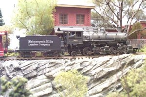

Finally, 2821 heads west on the shipyard's dual gauge line, just east of the point where the narrow gauge branches off to the south. The standard gauge line will go a little further west, and then swing north to the interchange with the Shinnecock Hills Lumber Co.'s main line.
