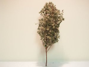

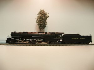

Well here is a few pics of the trees...can yall give me your opinion/suggestions. A friend stopped by to steal the show...that steamer is such a camera hog,lol.

They look good to me but what do I know my father use to make the trees for me. Oh and thanks 77 for replying to my upstate question it is good to know someone is a least somewhere around.
Stephen
Hi Railer, pretty nifty tree. One look at my layout and you'll see I could use a lot of them. Can you give us a few particulars on how it was made and the materials you used.

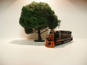

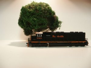

Not a problem this is what I did. Got the nexessary supplies from Michaels and Wal-mart also used a product called BranchBunches from ScaleTree.com which is on sale right now for 2.70 it says that a bag will make 8 or 9 trees but the trees they make are freakin huge...pics below...those trees are big big big....Im figuring a tree the size of my first one...which in my opinion looks more to scale...should be able to get 30-40 out of a bag easy. Anyway...you pull off a small almount...real small and pull it apart till its about to fall apart then you drap it over the dried broom twig..(dont know what its called) and spray it with adhesive...then sprinkle ground foam on it. Thats pretty much it...maybe over the weekend I can do a step by step.

Great trees, there are times for those large beasties and times for the other.
Huge differance between the amount of time and detail work spent for a front of the layout piece (or compliment to a particular building scene) and the Tree line in the back.
A trick for that back tree line of course is to make a dozen trees like your first and then just add the tree trunks (and a stump or 2)mixed in amongst them to make a forest.:)
