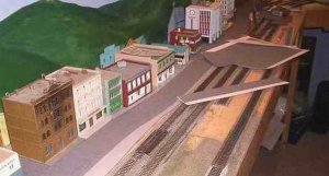

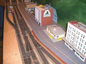

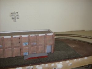

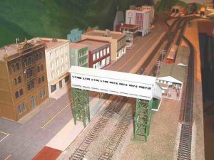

I printed my N Scale roads on to Avery Label sheets and stuck them down on to a fairly smooth surface. I then Printed some yellow lines on to the same road background and it was easy to slice the lines out and stick them down the centre of the roads.
If you are interested I can email the design for you.
Would just need your E address.
Dennis
