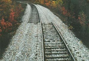

Just to add to that, one method I use to find kinks and imperfections in track (even though they might not cause derailments, or be perceptible to the naked eye) is to use, say, a 4-6-0 steam loco, and closely watch the front 4 pilot wheels, and their movement in relationship to the body of the loco. Their movement is quite accentuated compared to, say, a deisel loco or freight/passenger car wheel/bogie movement.
I'm glad I don't have track problems...... hey, one outta two ain't bad !
Bob :oops:
