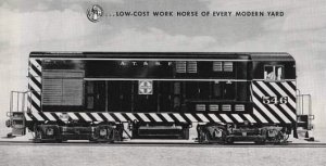

I am looking for photos of ATSF switchers in their old zebra stripe paint scheme, but I can hardly find any pictures. Can anyone help me, please?
cnw1961, i am NOT a big fan of ATSF, however, i looked through my pic archives and was able to come up with this one. sorry, its all i have, but perhaps it might help a little.:D View attachment 27037

cnw1961 said:
Thank you, UP. That is exactly the kind of pic I am looking for.
