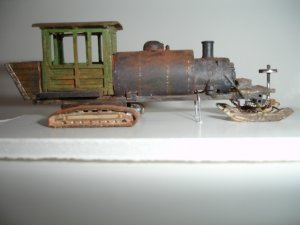

While doing research for my logging module I came across an article about hauling logs back in 1900. Pictures of a steam driven tractor. Modeltech Studies makes kits for HO & O, but none for N so I kit bashed one. The first picture is of real one and then my kitbash.

Looks good
That halftrack looks pretty good. My father has operated the diesel version of that Lynn Tractor/Truck just like that for many years at a museum in Maniotba. He will enjoy seeing these pics.

I used the tracks from a Backhoe kit made by Railway Express Miniatures kit #
2161. The water tank is a 1/2" brass tube with furnace tape rolled around it with a pounce wheel on the back side to make rivets. The smoke stack and steam boiler is from an 0-6-0. The frame is 3/32 brass. All the rest are scatch built.

Hello Bill
I too I'm interested in the Lombard. I've hit a road block with my HO scale version. Need some help with the chain drive. How did you build the one on your model? To date I considered the drive from Jordan trucks and NWSL drive chain but have not been happy with either. Any suggestions?
Thanks
David F
Lombard
David
Not sure if you mean the tracks (chain drive). At first I thought of using the tracks from a military tank, but found a Railway Express Miniatures kit and used the tracks from the kit. My tractor is in N scale so I am not familiar with HO kits. Modeltech Studies have a HO kit.
