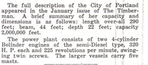

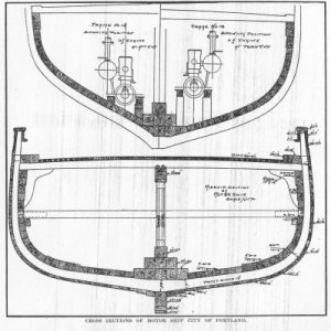

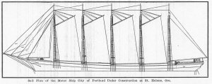

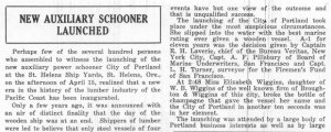

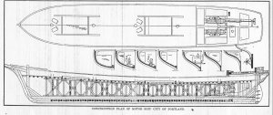

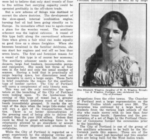

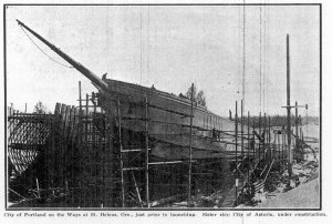

Found these two articles in the Jan. and April issues of the Timberman magazine. Thought you'd find them of interest.
Jimmy B
Lawton, NV

Nice pics of a 5 mast lumber schooner. Many of these had doors in the bows, for loading long boards, that couldn't be loaded through deck hatches.
Pete
