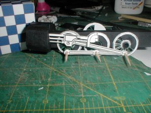

I set the side rods up as a kit per 3 wheels. I had to remember that the right side and left side are actually reversed from each other:oops: i will be able to use these on other engines later.

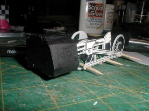

In setting up the side rods i used tooth picks to hold everything in place, I should not have cut the toothpick on the axel when i did,,,,make mental note:roll:
then i made up the redesigned steam chest and added the valve gear and reversing unit and glued them in place. I am very pleased with the overall appearance of the completed side rods. When they are all colored and done with more care they will show very nice, with a little planning they will all be operational:twisted:

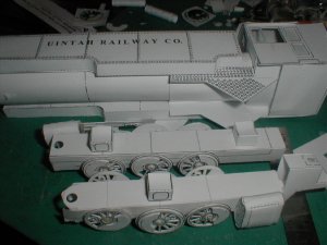

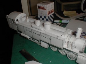

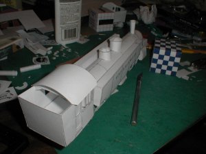

I have the boiler,cab, and water tanks set up to get a general idea of the fit and progress so far. The redesign of the tanks was what was needed. I did forget to narrow the ends:mad: I will have to go back and fix that,,,that wont be hard.:)
I think things are progressing and it is getting closer. :grin: Now i have to work on the top side with the stack, domes and fittings. still note sure how i am going to do all the piping on this thing so it looks good. I have thought of paper straws but i dont even think you can get them anymore,,,,maybe just a lot of rolled paper and the cut it to fit the required locations....then how to set that up so anyone can do it with a drawing,8)

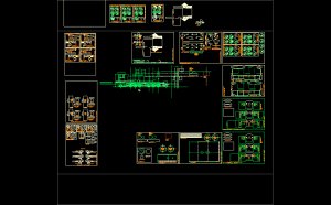

Here is a screen shot of the project to date. It shows how I am setting things up. As the number of sheets grows so does the final detail level.
I have a lot of little details to do yet.:grin:
I will post screen shots of the developement more as I get more done. I will also be posting more piccys this weekend when i buildup all the things I have designed. I hope they all work out as I plan8)
Each of the squares is 1 8x10 sheet. So far there are 11 sheets to this build. I am going to try to get more details on the sheets and to include photos of
each major assembly on the sheets. There will also be a detailed instruction and build order sheet.:roll:

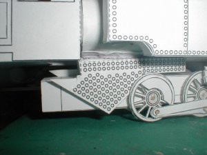

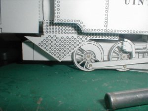

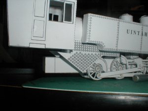

I was working on the ash dump and got some beautiful drawings done:grin:
i carefully cut them out and installed the parts on the engine being carefull to get them placed just so:roll: picture 2 View attachment 8459
mmmm,,that is not right,:???: i did the whole thing all wrong:mad: (the ash dump is that thing with all the rivets) It is supposed to be on the inside of the wheels not the outside.:cry: So now i tear everything out and relocate them to the proper location. Now I have to go back to the chassis drawings and redo them. Don't you just love the design process?:twisted: View attachment 8462
Now that looks more like the way it is suppose to look. The point that i am making is that sometimes you find the way you set things up do not always work out the way you think they are going to. I was so intent on getting that neet piece that took care of the floor for the cab that i forgot what I was doing on the ash dump and totally blew it.8) The last picture gives you good idea of the scale of this beast.

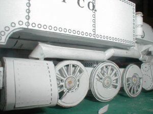

I have spent the last few days refining the plans and setting up color options for the mallet.:roll: i completely redid the way the chassis was put together and reduced the part count. Too many parts that could have been attached to each other.
I also added some detail to the side rods and made some changes to the way things are put together that enhanced the way things fit.

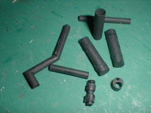

I have also been working up the tanks, fittings, piping , and upper boiler details. For these i uses the handle for the knife and various dowels to form the parts, one time around and a spot of glue,,,,,just have to rememeber to take them off before the glue sets too much:oops:

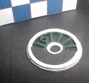

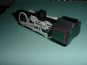

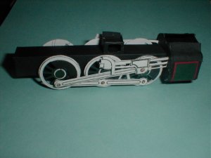

Here is the final chassis for the rear driver set. I have made many refinements to make it a better build. All the color is from just card at different layers as shown in the first picture.:roll: I have changed the way the wheels are done and think the outcome is worth the changes.8)

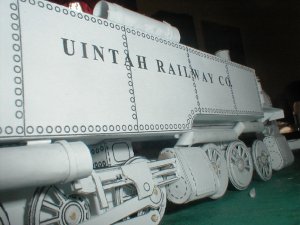

The next 2 shots are the fully assembled chassis. again only colored card is used.:-D I am thinking that I will want to add just one more minor detail to complete it. I will be posting front and rear chassis later. :-D If you look back to the first photos of the chassis you can see there have been a lot of changes made to get to this point.
Now that all the parts for the chassis have been finish to the final form I will move to the boiler and cab. I have the plans done in final form for most of that but just need to assemble it.:)
In designing this project I have gone thru many changes to get here. It is a process that involves building what you have and looking at it and refining, changing, and polishing the methods to get to the final product. I have take over 200 pictures from the begining to check the appearence in photos and made modifications, then more pictures.
