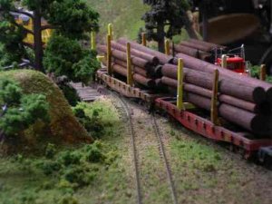

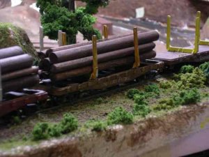

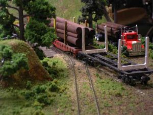

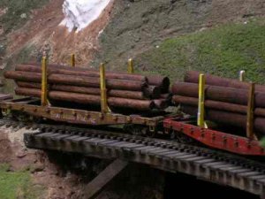

Some of my flat cars
Here are some pics of my flat cars.. Pics aren't so great, but not to bad either...
I couldn't remember the max size before I resized.. so they are a bit small..

Also, FYIW, this is the first track I ever ballasted.. looks better in the pics then it does in real life.. cool..
I would concur with Jim, Simpson is a household name here in Vernonia Oregon, which explains why I see those flat/bunk cars all the time in Longview (Nearest port).. FYI, Longview is an amazing modern river/rail logging port.. if your ever passing by on Interstate 5, go across the bridge into Oregon, head up the steep hill and stop at the overlook.. its quite a spectacular railfan view..
Very nice, thanks for the pictures. I am waiting for some flats I just bought off eBay to start hacking away at.
Your ballasting does look goodsign1 You have any other pics of your layout anywhere?
Hacking the cars is fun.. note the difference between the red and brown flat cars in my last picture.. specifically, in the brown I removed the "boards" completely from the "frame" (its all formed plastic, but you can see the boards as molded) in the red I cut the holes through the boards.. its a small difference in work, but really makes the remaining boards look like they are 3D and are sitting on the metal frame. Also, remember not to cut out the truck mount post... I'm speaking from experience here :-)

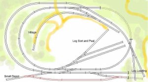

As for the rest of my layout, theres not much to see.. yet... Its small 4X7 but has a good amount of switching.. Ill take some pics and post'em some where, here is my layout in design.. its built pretty much like this..

Here is a picture I just took of the Walthers log cars I just got. They have the platform I am looking for but you can see how much shorter the bunks are. I wonder if these were actually modeled after a prototype?
That red car does look nice. Is it a 50 footer? The four bunks on the green one look "too much overkill" even though I can see that most the 40' prototypes have four posts, it still doesn't "look right" to me
Thanks
Dansco
Dansco: The reason for the four bunks and uprights is because the cars are used for shipping short or irregular length logs. Nothing is wasted anymore. After the fires here in MT in 2000, we had a lot of fire damaged timber going by rail. All different lengths and condition.
Actually, the red one is a 45' and the green one is a 40', so not really much difference. Thing that makes the green one look "off" is the bunks sit so much higher, thats due to the car riding much higher and the bunks themselves being much taller. The bunk height is correct for the prototype, but I need to take down the deck height on the car abit. Here are some prototype photo's.
