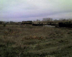

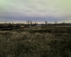

Prime moment - my son (age 8) and I went for hair cuts last night and on the way home we saw the Dump Train had moved next to a great railfan spot. We pulled up and walked to a small hill just 25 yards away or so.
This Dump Train had two 15-car hopper/conveyer cars and was off-loading ballast into a big stock pile. It was headed by a UP dash 9 and an ex CNW SD-40 (best I could tell anyway - very dirty).
We watched as one 15 car section unloaded nearly all its cargo - each car has four hoppers with hydraulic (air?) clam shell doors at the bottom just above the conveyer. These are operated by a crewman on a catwalk that runs the length of the train. He would open a hopper and we could see the mound above disappear. As that one nearly finished unloading he'd open the next one. Each hopper took about 55 seconds to unload - less than 4 minutes per car and thus less than an hour to unload (65 tons x 15 cars) nearly 975 tons of material (assumed 130,000 pounds per car based on empty weight and loaded limit).
The cars closest to the elevator and boom were unloaded first. All doors were left open until the last hopper was done. The 50 ft. boom dropped the load at a 90 degree angle from the train. Two crew members watched the stock pile and radio-ed to the engineer when it was time to move forward.
The cars are hooked together via drawbar with a conveyer belt "holder" that swivels above the drawbar between each car. Power for the conveyer comes from the control car at the other end with the elevating conveyer and othe unloading boom.

I took two photos with my PDA - wished I would have had my real camera.
