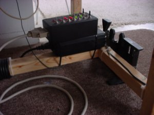

DO NOT use direct AC to feed those LED's! I have used Atlas snap on relays to isolate the LED's. Use a seperate power supply! I use an old notebook pc's power supply. Then Use a 7805 regulator to drop the 13.8vdc to 5vdc. Then I use a 1000 Ohm (1K) resistor. This will make the LED last for many many years to come.
The 7805 regulator is a very easy device to use. It has 3 wires coming out of it. The first is the input-middle is ground or negative- the output is 5vdc.
One last thing. AC can cause the LED to flicker. AC also burns out LED's, even if the voltage is correct.

Excellent implementation! I love the reuse of those old power supplies. I've got about a dozen of them from all the old kids toys, broken cordless phones, modems, et al. The regulator is the key.
