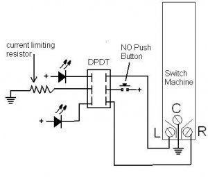

Ok Well I've spent enough time looking and I can't find it.wall1
I'm using Atlas remote switch machine's left and right, what I wanted to know is I'm about to set up my control board and wanted to know how I can wire up a red led and green led to show the way the throw is on the switch, I did try on the actual control but only gave me a temporary light flicker.
So far I have 3 right turns and 3 left turns switch's and will be adding more down the track.
I apologise in advance if this was posted before but I just could not find it.:wave:

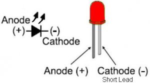

Try this:
(Just in case....NO Push button means "normally open")
The Atlas controls for switch machines are only single pole double throw and won't do what you what you want them to do, so you will have to make the change over to individual switches.
Hope this helps!

:mrgreen:Thank you very much for that will give it a go.
Did try a while back to set up on dpdt switch and momentary push button but it did not work, now that I have this it might work for me.
That is an elegant solution , allowing for the continuous power for the LED's and momentary power for the switch machine.

Thanks Bill,
I use the same setup for my reverse/forward switches, only I use a 3PDT switch 2 poles for the direction and the 3rd for the LED. Maybe it could be done differently, but I like all the LEDs lighting up the control panel. I don't think I'll ever run DCC anyway.

No, it's not working for me.:cry:
I'm not an electronic's person so it's trail and error for me.
I soldered the push button to the centre and the red wire to one end and the black wire to the other end and it will only throw the switch one way not the other.
So I bought a centre off dpdt switch but nothing works at all now.
And I haven't even got to the LED's yet
Talking about "thick as 2 planks"wall1
I've asked at the electronic's store but I can't get them to talk layman's terms for me to understand.
If only this had to do with firearms I would have no problems:twisted:

do you have a multi-meter? troubleshooting electrical stuff without one is real hit or miss, If you like, I could do a basic tutorial (DC- I don''t understand half of what I know about DCC, cause it works by FM [F****** Magic].
Bill nelson former auto tech.
:wave: Thanks all.
I do have a multimeter and will have another crack at it, it's one of those things I think I have to step away from for a minute, and come back to it.
What kind of switch machines are you using?
