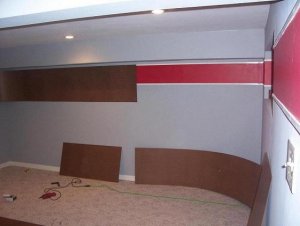

The First shot is of the very beginning stages of construction... the backdrop. 9/20/06

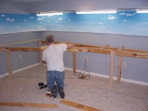

Here my Dad is screwin' the whole thing up (phillips head that is).:D I mean he's building some bench-work. 11/23/06

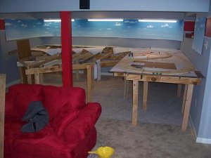

This is the Bench work basics. 12/07/06

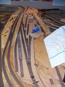

And finally, let's jump ahead a few months... This is the latest track work I did on Thursday. It's the upper level main yard. 4/12/07
As you can see we got a fair amount of stuff done in 6 months, while working sparingly on it. I live 2 hours away from him and work and go to school, so my time is limited. (who's isn't right?). But when I do get down there I make the most of the trip, usually working a full 8-10hr day on it before I have to leave.
