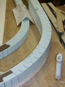

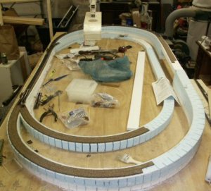

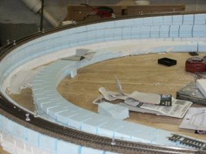

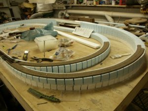

Hey everyone, here are some pics of my progress so far on the new layout. All risers and inclines I made myself gluing up layers of the blue foam then "resawing" them on the bandsaw, tapering them to the desired grade. The outer loop is all 4 percent while the inner loop is at 2. I rigged a hot wire cutter using a soldering iron I had and kerf cut the risers and inclines to form the curves. So far the whole thing is flat and true to radius and I saved boo koos of bucks making these things instead of purchasing them. I read alot of posts here about making risers with foam but let me tell you, if you have a bandsaw, this is the tool for the job. I made all the risers and inclines in one evening for the whole layout. Im laying in all my switches and cork bed today and hopefully I'll be ready for a short test run this evening. Seeing as how Im just getting back into this hobby after many years I would welcome suggestions for improvements or things I should be looking out for from the ones in the know here. I appreciate all the help Ive recieved so far and hope maybe someday I can in turn help someone else.
Thanks so much!
Jim

Looks good to me. But the 4% grade is a little steep. Hope you don't plan on long trains. How did you make the foam cutter?
Les
Thanks Les, I used 4 percent in order to get a higher area for the trestle thats going in. My layout is Civil War era and so no, long trains wont be an issue for me. In fact Ive only seen one or two pics in my research where the trains are longer than 4-5 cars altogether. Not saying they didnt pull more than that of course but it seems most of the time they were short. I guess! Anyway thanks again for the compliment!
Jim
wow. Civil war era. I congratulate you. I don't have much experience with HO
4-4-0s, but the prototype would probably only be able to pull 4-5 cars up a grade that steep. Trains werent very long back then, and freight cars werent very big, either.
kevin
Kevin, you're right they wouldnt have pulled more than 4-5 cars. At least thats what my research shows. This has been a real challenge so far. Limited resources for HO 1860's rolling stock and the locos that are available look pretty much the same except paint. I havent even bought any structures or anything yet so thats probably challenge there too. But all in all its a lot of fun and gives me something to do in the shop other than build furniture and cabinets!
Jim
You might want to check out MDC/Roundhouse for 1860 stuff. They were bought out by Horizon hobbies and their stuff is a little hard to find right now. Might try LHS
Les.
Les, sorry for not answering the part about the foam cutter, guess I looked over that part of your post. I made it much the same way as some others here I read about. I used a soldering gun fitted with a length of #14 solid wire. I made a loop out of the wire and used that to make all the kerf cuts for bending the risers around the turns. Worked great and was fast and easy. My gun is trigger operated and the bare copper wire cools down quickly after letting the trigger go so its a little safer than one that doesnt have the trigger.
Jim
