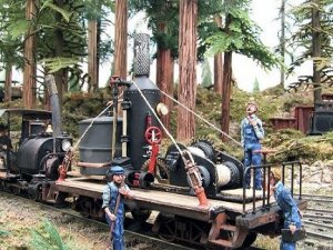

Been busy scratchbuilding this Donkey engine and flatcar. Just about to be delivered to Cooncreek lumber Co.

Do those gears on the flat car move when the train moves?

Those are some interesting tie down points, on the corners of the flat. What were they?

Hi gang and many thanks to all.
Originally posted by sumpter250
Sweet...
Those are screw (Jacks) turnbolts, you place a screwdriver (Or something) in it and tighten up the ropes. (LOL, no -- they don't work)

No, the gears don't work (Sad really) :D

Excellent work and detailing, Paul.:thumb: How long did it take you to fabricate the boiler and gearing?
Hi Mike,
I turned the boiler on a lathe out of solid brass, and made rivet detail using a centrepop and small hammer. (Took ages) As for the gears, they came out of a large clock (Wind-up type) that didn't seem to want to go any more LOL.
All in all, it took me around 10 days to make it.

Paul, this modeling time was very well invested!
Quite a change to see a clean, freshly outshopped donkey engine. Your LPBs can be mighty proud to have such modern machinery to work with!
A fine idea to tie down the donkey on this flat car. Looks great!
